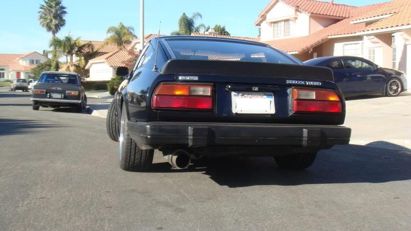

It would probably be the same with the 9.5". I don't know anything about the suspension techniques springs or you're drop, just making sure it isn't doing this on a stock or coilover setup! Is the 9" also flush in the rear? I never mounted a 9" on the rear of the 280zx.
Rudypoochris, the rears are pretty flush, although the front wheels do sit a little better. I'll try to take a picture of the Z dead on from the rear to show you how the wheels sit on both front and rear fenders. The drop from the Suspension Techniques springs is ~1 1/8", with the air dam, the drop looks more dramatic though.

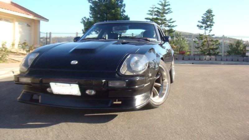

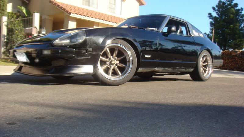

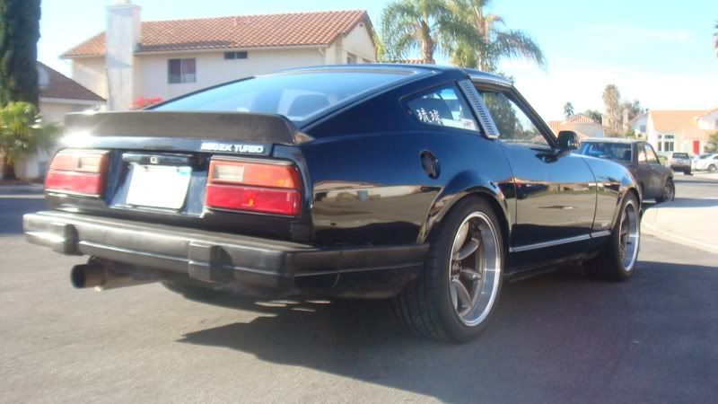

The rain finally stopped long enough for me to snap a couple of shots of my zx. The 9" wheels sit fairly flush in the rear, but maybe the 9.5" will sit better. I just prefer a non staggered setup as my last set of wheels were staggered, and I didn't like the handling characteristics that came with the setup. I tried to show the 9" from multiple angles. Hope this helps any S130Z owners out there! Sorry my zx is dirty, I've been extremely busy with work, but it's raining again today, so I figured it wasn't worth it to wash and wax it yet. =)
