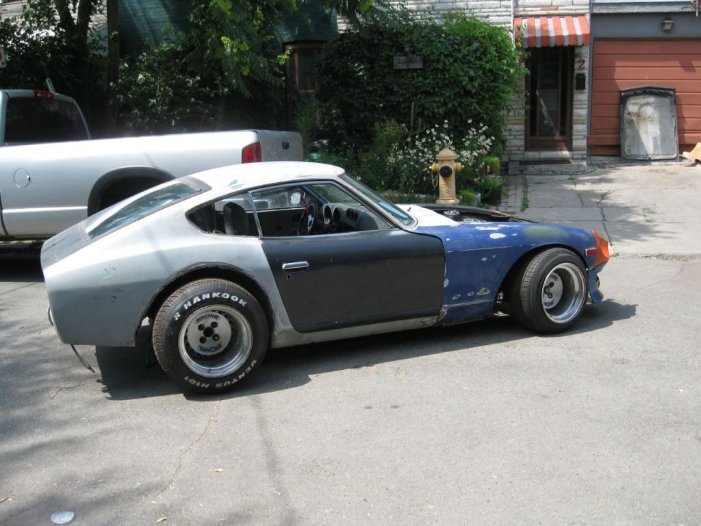

Some very helpful pics here as I try to figure out exactly how to fit-out my 15x10 -38s.
Back will be fine, fits good.
To my eye the front will be out of proportion with the back with the 15x10 and I may narrow depending how they look with flares mocked up and the Coilovers done.
