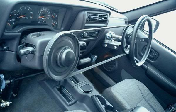

m1ghtymaxXx Posted September 25, 2007 Share Posted September 25, 2007 Looks pretty straight forward to me! Quote Link to comment Share on other sites More sharing options...

vrocious Posted September 29, 2007 Share Posted September 29, 2007 Looks pretty straight forward to me! that is absoltely awesome! i'm with everyone else though by the time you get everything done it would prob work out cheaper to get one imported Quote Link to comment Share on other sites More sharing options...
