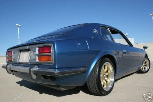

Well I hope this car inspries you to keep working on the car RedEvil:
My Best - Yasin
