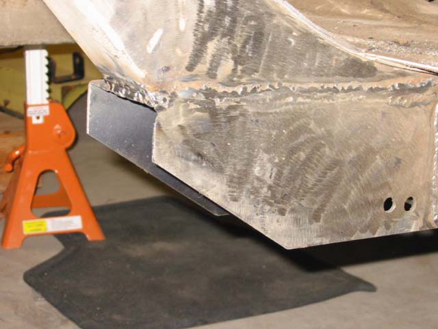

v8dats Posted February 3, 2008 Share Posted February 3, 2008 well after mocking up the 2jz i decided that the car was a little too rusty and that the stock rails were junk! so after some words of encouragement from my friend Derek,i started to take some measurements and hack off the rails and do some rust repairs. here are some pics. they arent the best quality but you get the idea. i used 2x3 .083 rectangular tubing. i also cut the firewall and battery tray areas because they were swiss cheese. still working on the tray area. i still have some more welding/fabbing to do. i will then start to fab up the rails from the firewall all the way to the back. more pics(better quality) to come. Quote Link to comment Share on other sites More sharing options...

fhptom Posted February 7, 2008 Share Posted February 7, 2008 Those are some nice looking welds. Did you use that Craftsman welder in the background? What amperage is that welder? I wish I could get my welds looking like that. I guess I just need to keep on practicing. Tom Quote Link to comment Share on other sites More sharing options...

v8dats Posted February 14, 2008 Author Share Posted February 14, 2008 Thanks guys! hell yeah i was so freaking nervous when i started to hack away! i measured for like a whole day and took down many notes. i did use the craftsman welder in the background and it worked awesome. i did use argon and practiced on some scrap first.not sure on the amps of the welder but it is a 115volt. it also helps that i have my friend Derek's car at my shop for reference..haha he had the guys over at Mazworx do his rails. at first i started with the rear rails but i was talked into doing the fronts. as far as keeping everyting square i did have a support bar tacked in between the rails to keep them square and then removed it after i had them welded in. the front end was so floppy without the rails and it was a pain to clamp everything in place before welding. i am happy with the way that its all turning out an cant wait to finish the rears. thanks for the compliments guys! i have had alot of inspiration from many members here. as far as DNI Zgad.... no way in hell!! hahah i may trailer it up with the engine/tranny bolted in (wishfull thinking). Quote Link to comment Share on other sites More sharing options...

v8dats Posted February 23, 2008 Author Share Posted February 23, 2008 more pics to come! did some misc tabs for intercooler and rad mount. also tacked up the rear rails! this is starting to get fun and my confidence is getting better and taking less time to measure and cut. all i can say is practice,practice,practice!!!!! Quote Link to comment Share on other sites More sharing options...
