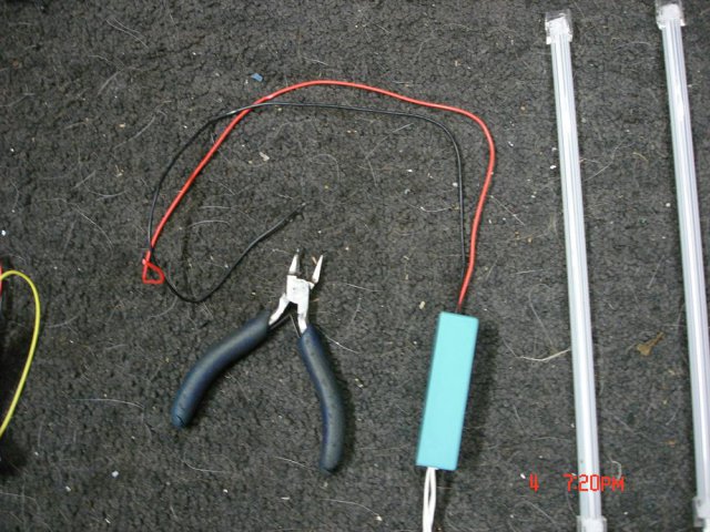

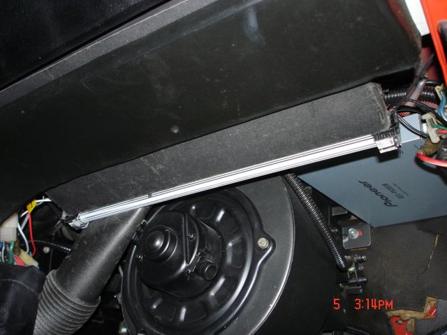

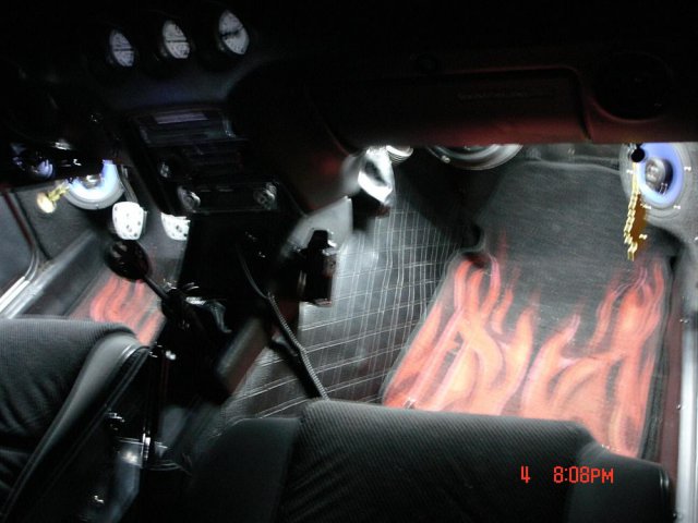

The Cold Cathode tube only require 5.0ma which is practically nothing. The picture below will show before and after as well as cutting off the "T" plugs from the inverter that normally plug into the inside of the computer.

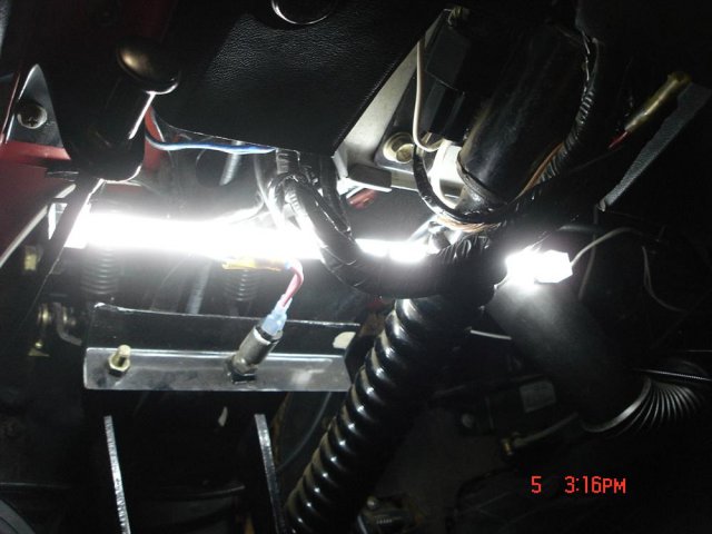

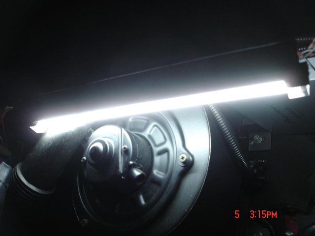

They put off a Beautiful white light when placed under the dash. I mounted the first tube at the bootom back corner of the glove box, using the supplied Velcro that came with it. It sits just on the back corner but not on the down facing panel of the glove box. Out of site but able to light everything up.
The blue inverter box sits in the dash area just above the radio. The wires from the inverter to the tubes are only about 12" each so the box has to be placed in the middle of the dash. **DO NOT CUT THE WHITE WIRES THAT GO TO THE TUBES** THEY ARE SPECIALTY HI VOLTAGE WIRES!!

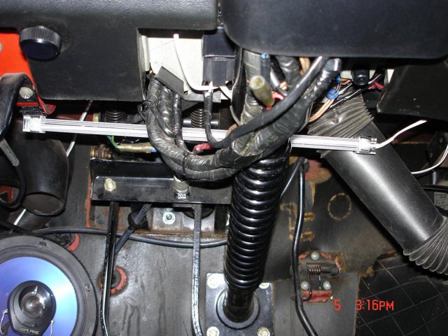

The drivers side was different. The tube sits on the upper side of the steering columnm, with the wired end touching the mid-section of the defrost tube and the other end just barely touching the curved dash support on the left of the steering column. So I Velcro'd the wired end to the plastic defrost tube and doubled up the Velcro on the other end to reach the dash support better.
Best $15 I ever spent on lighting up a very dark interior. They sit low enough to even light the dark seats, just enough to make sure I don't end up with seat belt up my butt, AGAIN!!
