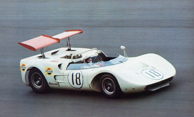

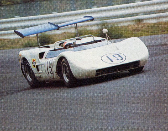

HS30-H Posted August 15, 2008 Share Posted August 15, 2008 "Nothing new under the sun.........." April 1968. Nissan R381 sports car. Split-element, hydraulically-actuated rear 'stabiliser' wing, reactive to speed, cornering forces and braking. Raced. Won. Banned......... Quote Link to comment Share on other sites More sharing options...
