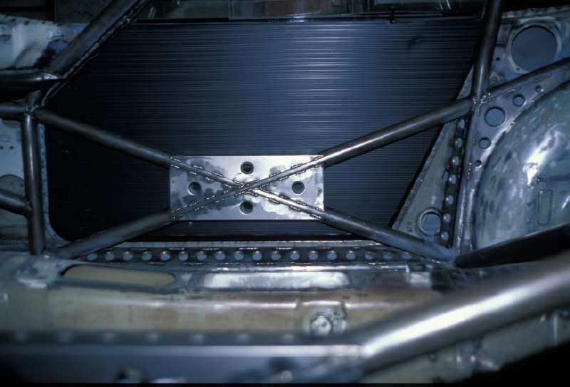

bjhines Posted September 29, 2008 Share Posted September 29, 2008 This is why I did this. and not this!!! I have seen others do this I realize that this is considered safe, but what does it do for weight and stiffness? ... Quote Link to comment Share on other sites More sharing options...

heavy85 Posted October 2, 2008 Share Posted October 2, 2008 I have seen others do this That looks hella stout both to aid in chassis stiffness and side impact protection. Cameron Quote Link to comment Share on other sites More sharing options...
bjhines Posted October 2, 2008 Share Posted October 2, 2008 The neat thing is that it is only a modified version of the classic fishmouthed-X-bar. I used 2 V-bars with gussets for an even stronger connection. I saw no need in the center down-tube except for jacking the car from the middle. Quote Link to comment Share on other sites More sharing options...
