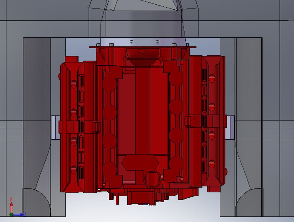

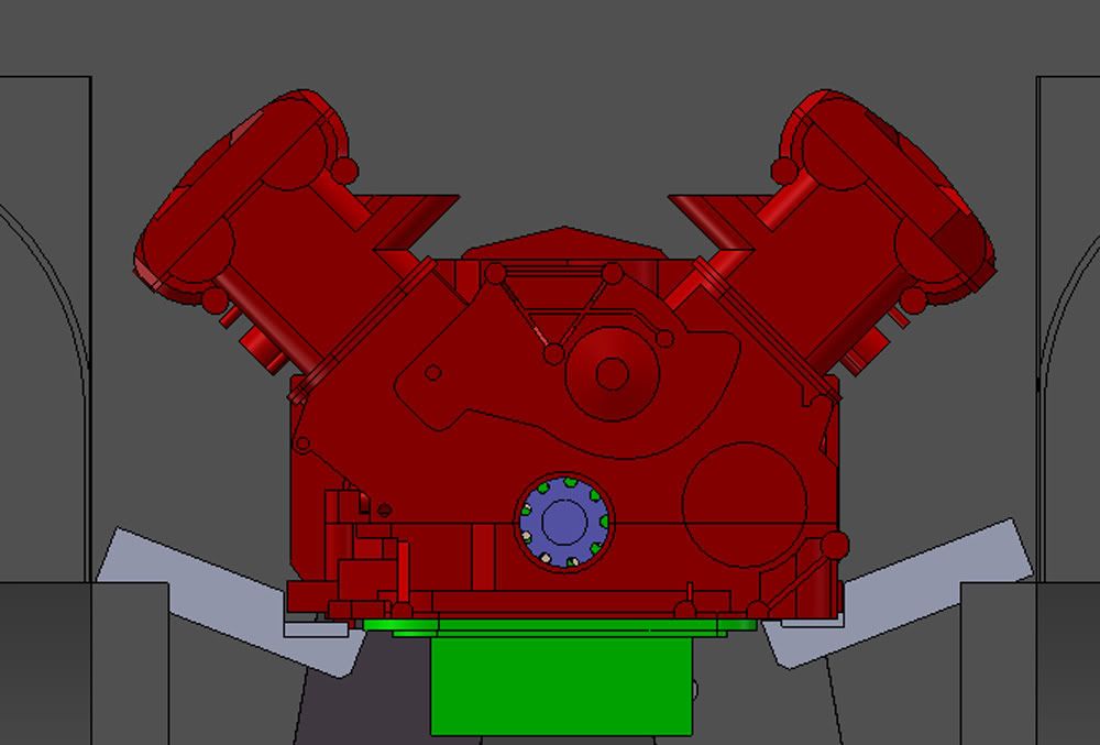

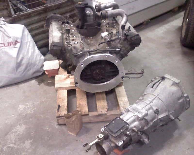

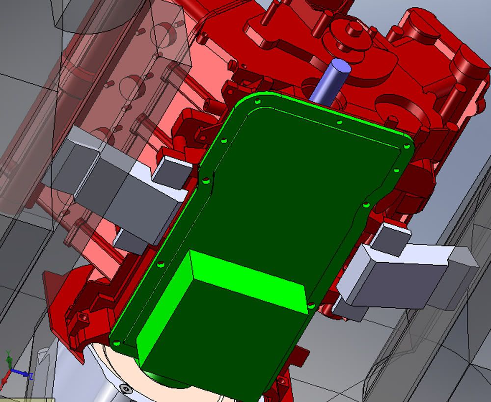

It seems as if you have the single cam engine in the first pictures but it looks like the twin cam motor in the CAD and on the engine stand, so which one is it? And you wouldn't happen to know how much the twin cam motor makes over the single cam motor for those big cylinder head?

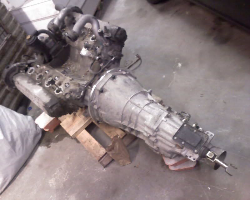

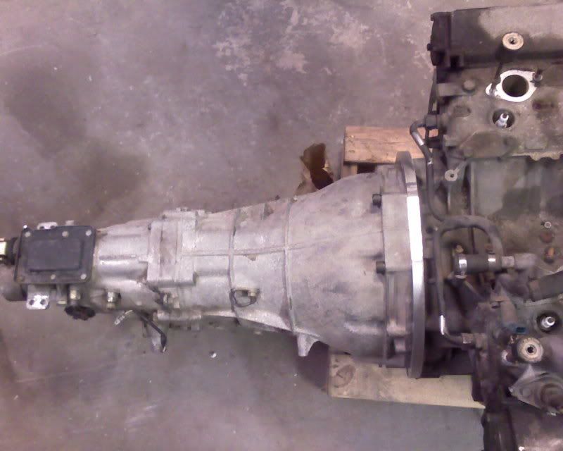

How are you going to do the gearbox? just make a custom bellhousing and throw in a T56 or you going to keep the transaxle - now that would be a project :-)!

Good eye. My engine is a 4.5l 16v single cam from a 1982 928. The other engine on the stand is my buddy's 5.5l stroked dual cam 32v which he is building at the same time as me.

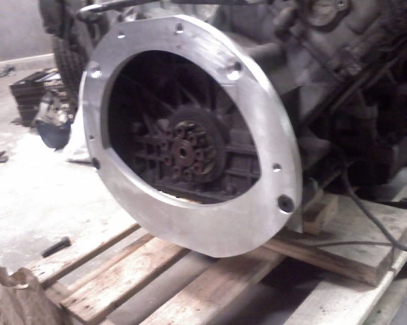

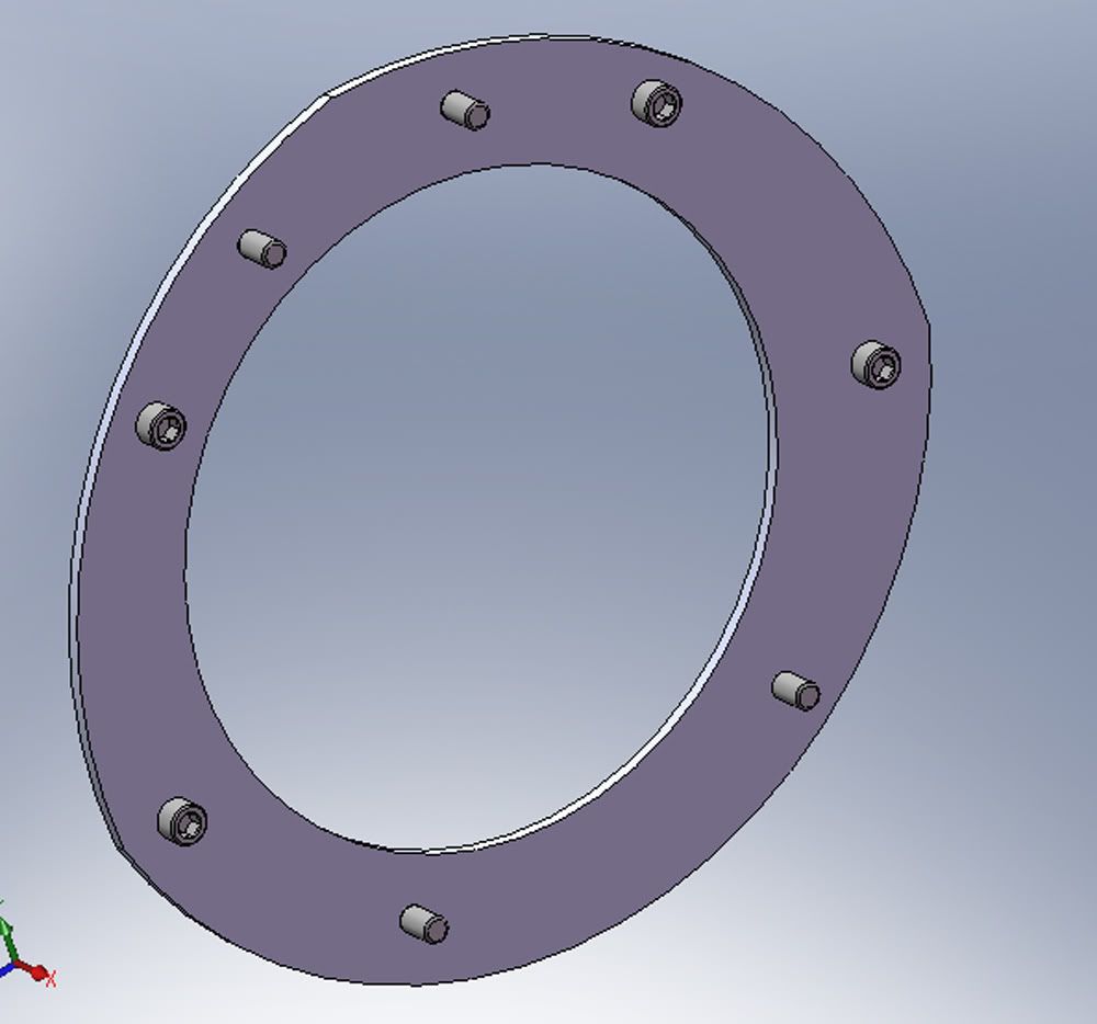

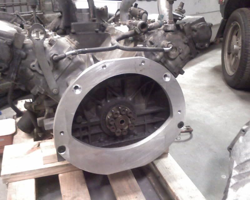

The reason for the complicated exploded diagrams was that I was highlighting the difficulty of adapting the Z32 transmission to the 928 block. I want to use the Z32 clutch and flywheel too, which need adapter plates to work.
The bores are nikasil coated, which greatly helps any wear issues.
from what it looks like the 4.5 and 4.7 are SOHC, and the 5.0 and 5.4 are DOHC
but it also looks like europe got a 4.7 DOHC engine.
anyways, his cad shows a DOHC engine but his engine is a SOHC
He's making a custom adaptor with adaptor plates to mate a 300ZX flywheel and clutch to the porsche engine.
