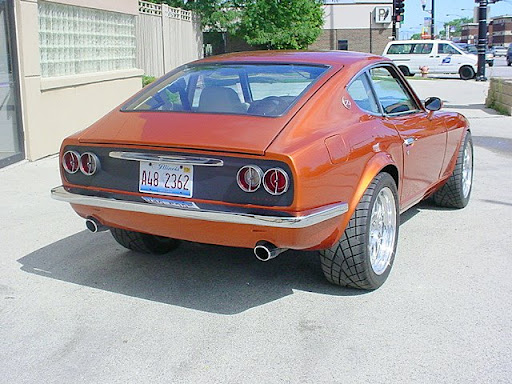

no idea about 17x9 but my old 240z had 16x9 on stock fenders with just rolled rear lips I was running a 225/45/16. I did post a pic in the Wheel Show?: Thread almost 2 years ago now. And FYI my 240z did not have coilovers or 8" springs just the stock 240z rear setup just with lower aftermarket springs and koni red inserts.
I have 17x8 and its already a VERYT tight fit with stock spring perches and without any quarter panel lip rolling/cutting. Click on the picture in my sig to see more pics of the fitment.(its my build thread but there are tons of pics towards the end)
