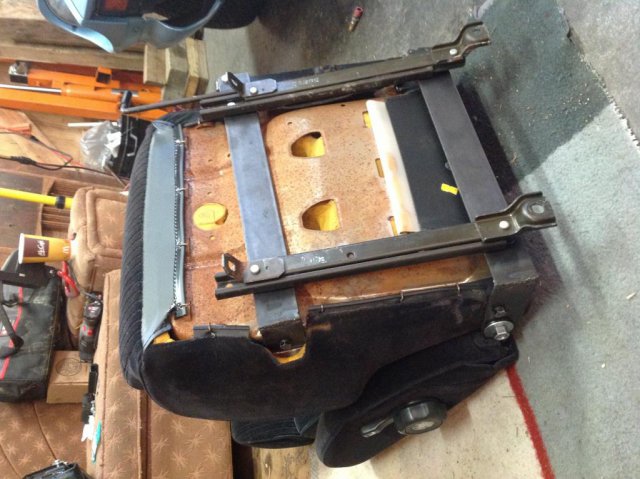

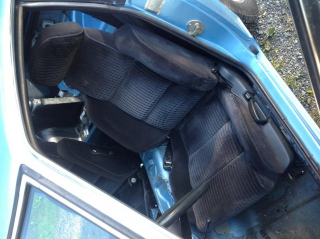

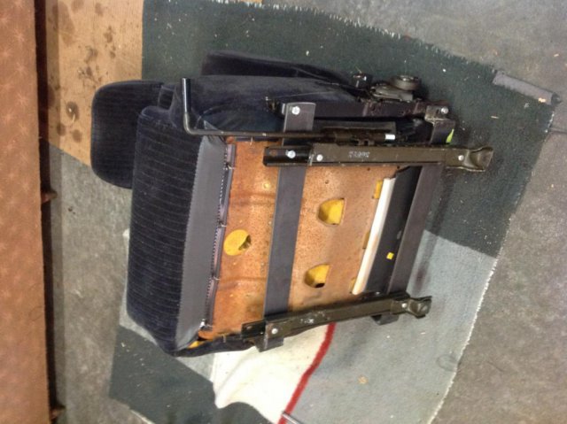

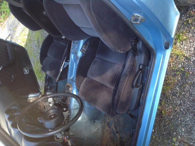

Dkyle Posted June 2, 2013 Share Posted June 2, 2013 89 Honda Prelude seats in a 77 280z Removed the sliders and fabricated mounts for the 280z sliders to bolt on. As you can see.. The rear mount had to wrap around to provide the pivot for the seat back. I also had swap positions of the sliders. Worked out well.. Tight fit, but got it as low and as far back as possible. They make me seat about an inch or so higher. The stock seat belt feed out bracket is in the way, I will have discard it and use something else. Probably added 30 lbs to the car. Quote Link to comment Share on other sites More sharing options...
