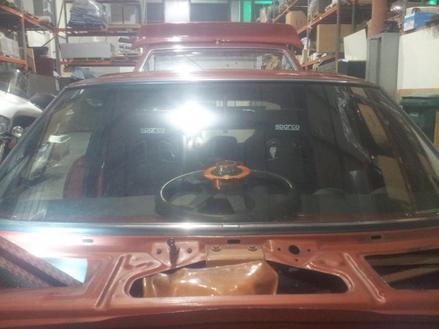

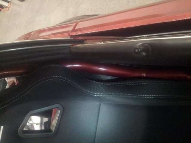

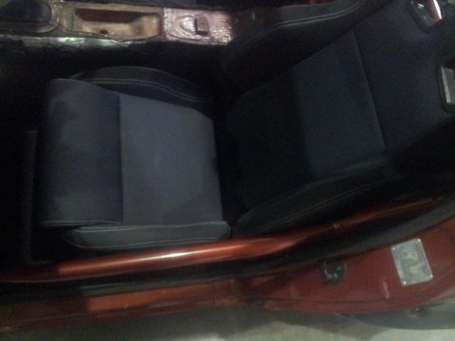

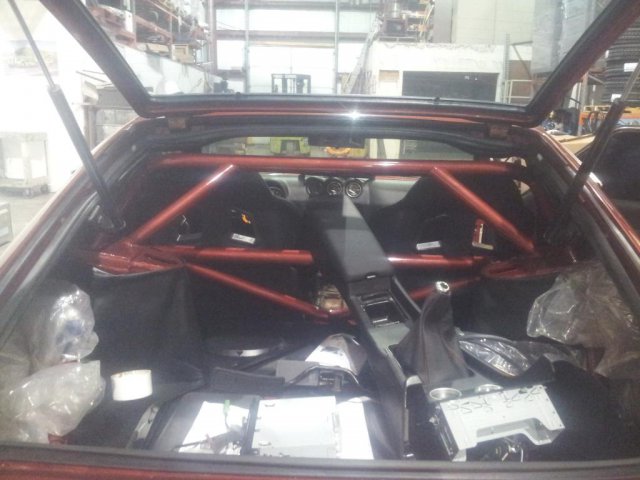

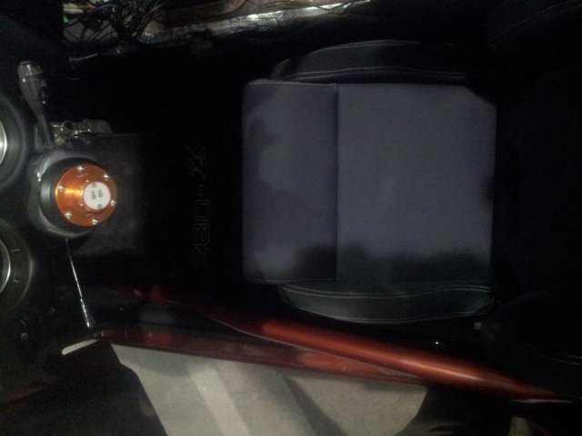

torqen2k1 Posted February 25, 2015 Share Posted February 25, 2015 So I kinda did same thing as sunnyz did. These are the sparco r100's. Darek Quote Link to comment Share on other sites More sharing options...
socorob Posted February 25, 2015 Share Posted February 25, 2015 (edited) Can you measure from where you sit on the seat(where the seat bottom meets the seat back) vertically plumb to the roof with the seat all the way back? I see people put seats in but they put them in so high someone over 6' wouldn't be able to drive the car without their head being in the roof. I like those sparcos and would like to use them if I can fit in the car with a helmet on. Also did you get rid of the stock seatbelt? Edited February 25, 2015 by socorob Quote Link to comment Share on other sites More sharing options...
torqen2k1 Posted February 25, 2015 Share Posted February 25, 2015 So I myself are 6 ft tall, I removed the rear seat mounting brackets and nut and bolted the rear seat slider. I will be using a 4pt harness so will no longer be utilizing the oe seatbelts. With the seat all the way back is roughly 37". With the seat completely back my arms are almost straight holding the steering wheel. Take in consideration that I have a Nrg quick release hub and adaptor. But I installed the cage my self the first time and it was a no go, because I didn't have the capability makes bends. Will try to post a few pics later on the day. Darek Quote Link to comment Share on other sites More sharing options...
torqen2k1 Posted February 25, 2015 Share Posted February 25, 2015 We'll here's a pic's.... Quote Link to comment Share on other sites More sharing options...

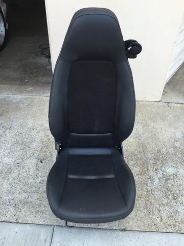

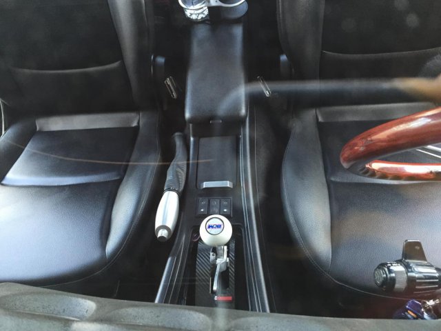

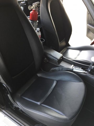

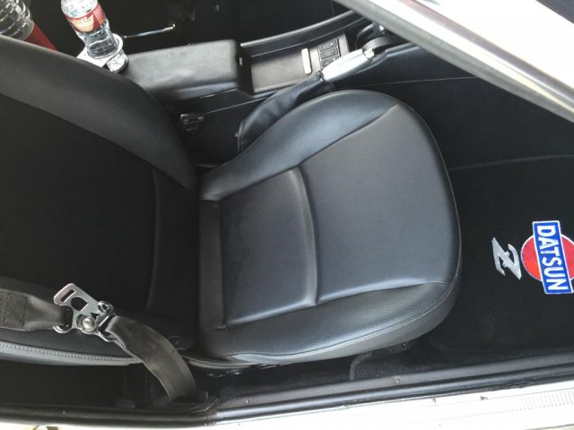

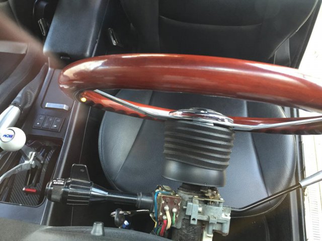

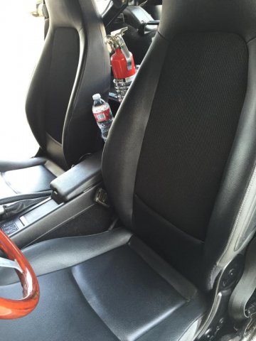

ritrebor Posted May 6, 2015 Share Posted May 6, 2015 Just installed a pair of Smart Car seats in my 280z They are only 19" wide and gave me plenty of room Used the 280z sliders. ritrebor Quote Link to comment Share on other sites More sharing options...
SleeperZ Posted May 6, 2015 Share Posted May 6, 2015 Just installed a pair of Smart Car seats in my 280z They are only 19" wide and gave me plenty of room Used the 280z sliders. ritrebor Of course those would fit, great idea. How do you like them? How did you attach the 280Z sliders? Are you sitting closer or farther from the floor? - I need to retain headroom for a helmet... Quote Link to comment Share on other sites More sharing options...
