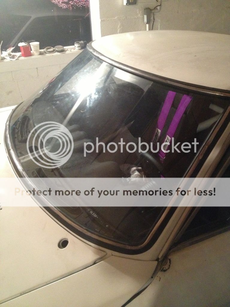

seattlejester Posted November 28, 2012 Author Share Posted November 28, 2012 280zex: I just might send you that text, the gasket issues are driving me nuts and I think it is about time I address them. I e-mailed MSA to see if they have any other tips to offer.I bought some sealing tape in case all else fails, permanent waterproof seal they say . I will text you if I can not find a solution! Valve train is spot on the money, she purrrs like a kitten, a 30 foot monster kitten that is! I gained the extra adjustment by grinding down the adjustment nuts to make them skinnier, I have the cold valve gap perfect, I'll have to do a hot gap after I get my exhaust so I can drive the car around without setting off car alarms. tamo3: your white gear looks a lot whiter than the gear I pulled out, maybe my gear is of the purple variety outlined in datsunzgarage for a 4.38. Hopefully nissan calls me back with some good news regarding availability of the correct cog and I can just swap it in. I wonder if that means the PO installed a 4.38 rear end in the 200sx O.o Quote Link to comment Share on other sites More sharing options...

seattlejester Posted December 12, 2012 Author Share Posted December 12, 2012 (edited) Work on the car has been slow but steady. Working full time is good in that money is not really an issue anymore, but bad in that I never get to go to the stores since I work 8-6. So where to start... 280zex I'll be sending you a text soon. I emailed MSA, no response. Called them and they picked up immediately and I spoke with a rep. He asked for pictures which I sent, he stated that he has never seen this problem before and adding the trim should push the gasket out making it seat better. That makes sense, but if the gasket pulls anymore from the windshield I'm pretty sure the windshield will have gaps between the gasket and the glass instead of the gasket and the body, I'll have to wait for a friend to get started as putting the trim in with the windshield on the car is proving to be a little tricky. When asked about the doors being hard to close, he also stated he had never heard of the issue, (which I find a bit strange given the amount of posts on the subject) but he gave me the helpful advice of hammering the welting down, which I will try. Now to answer Pac_Man: my car is not perfect, it has been hit at some point, and I'm pretty sure the windshield must have been replaced in its 40 year life so I can chalk the gasket kit not fitting to those, for now I have duct tape sealing the windshield and I have to slam the hell out of the doors to get them close to lined up with the body . The windshield situation might change for you, but I'm pretty sure most people experience the door gaskets making the door hard to close and instead go with the Kia weatherstripping option. Getting out requires me to roll the windows down and pull the handle since even with the pulley I can't pull hard enough to disengage the door latch. It is unfortunate, but realistically I was not expecting any miracle of a response since my problems seem pretty normal. I mean seeing 280zex's car with the same kit having no leaks and the minimal effort he has to use to close his doors was infuriating! So I called my local Nissan dealership to see if they could get me the correct speedometer gear. Read them the parts number and the rep said he could have it shipped in a week. Then backpedaled and said it might take longer and he would give me a call when he had a better idea since it was not in the local warehouse. I waited for the phone call that would say that it is no longer available, but the phone call never came. I called back today asking for an update and he replied, "Oh, I have it right hear, no one called you?" So I ducked out of work a little early and skipped to the front counter to receive my speedogear. And after the little switch... I have everything I need to get my speedo working , saved about 30$ and 3 months wait time! Finished up most of my wiring. Re-soldered the fuse box to prevent melt down (will probably replace with a more modern unit down the line), taped down most of my stray wiring, soldered most connections, and got most of my instrument panel wired up and working. Now the car securely runs with a digital time, cabin or engine temp, volt reading, and inertial fuel cutoff switch with bypass. Still need to wire up my little LED turn signal indicators and the shift light, (all small discrete LED's), but I'm pretty happy. I had a bit of a moment when I installed the fuel gauge and it read 0 even with ~3 gallons in the cell. Tried swapping the connections etc to no avail. Finally put on some clean gloves and reached down for the sender, to find that the fuel did not come up to the sender! Silly me. Realized there really wasn't anything stopping me from a test drive, since my initial fear was not knowing the revs and stalling the car a whole bunch. Made sure the car would rev freely and gingerly backed it down the drive way and took her for a little run. The car is really loud, but finally driving it was super thrilling. I ended up stalling once trying to go up my driveway, but managed to get back home safely. A quick walk around led me to realize I still hadn't made a battery tie down so that is next on the list! Also managed to call the local exhaust shop. I could try making my own exhaust, but why go through the trouble of measuring and welding when there is a very reputable shop right down the street? For mandrel bent 2.5 inch exhaust piping from the header back with flanges (to take off portions, like a mid section for tranny work or an o2 sensor install, or the muffler portion for a new muffler), flex pipe (he was a little skeptical about this, but I wanted to add one as the PO had ripped out the exhaust hangers twice with the exhaust), all tucked nicely, I was quoted 300$, that's cheaper than an exhaust system for my daily! My goal for this week is to have the car registered and insurance paid for, so I can enjoy it a little before this year ends! List to address: Gasket fitments and install (general waterproofing) Hood and inspection cover install Battery tie down Driver door paint and window crank mechanism (keeps falling off the rail) Turn signal and shift light pod Exhaust Carbs running lean (popping at 4k) The list keeps getting shorter . Edited December 12, 2012 by seattlejester Quote Link to comment Share on other sites More sharing options...
