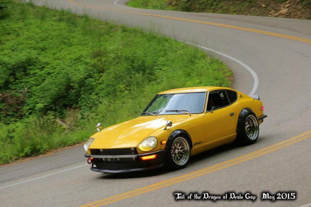

Arif Posted May 19, 2015 Share Posted May 19, 2015 I had the pleasure of chasing your Z up the dragon last weekend. You've got an amazing Z. Quote Link to comment Share on other sites More sharing options...
ZT-R Posted May 19, 2015 Author Share Posted May 19, 2015 Yea spins like i was on the stock tires. Try a set of hoosiers next year. but you just petal the hell out of it, once you start hearing spool let off or your in trouble. That was an absolute blast. loved the dragon. now if we could get the speed limit bumped up and a road closure event, then we would have something. Quote Link to comment Share on other sites More sharing options...

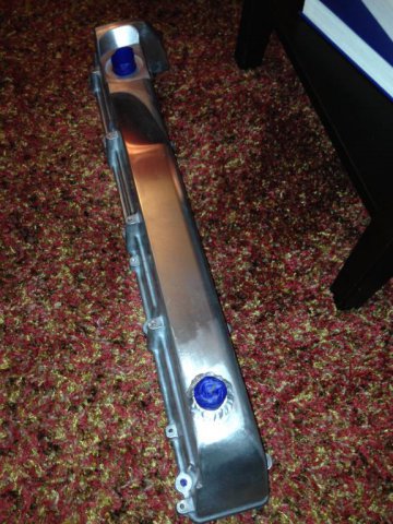

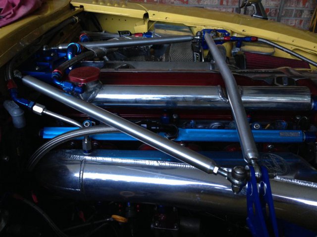

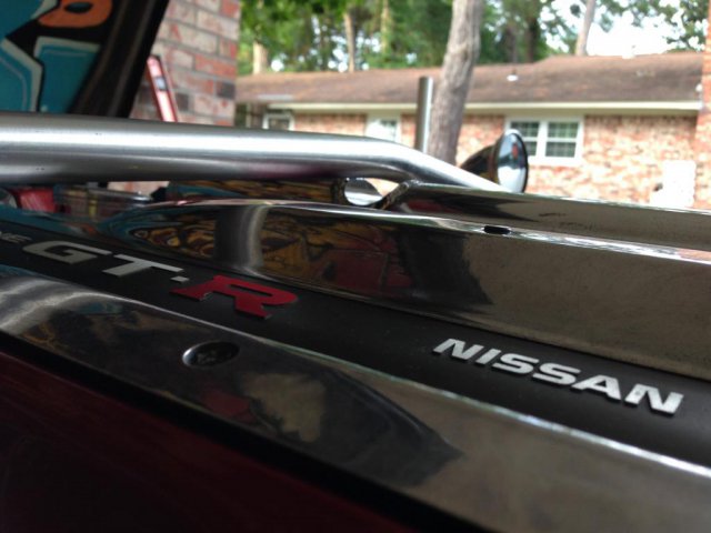

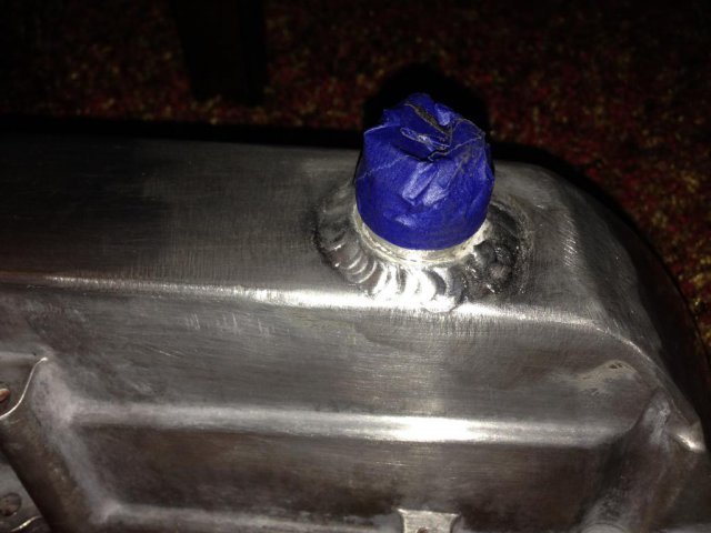

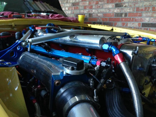

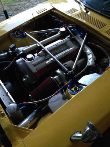

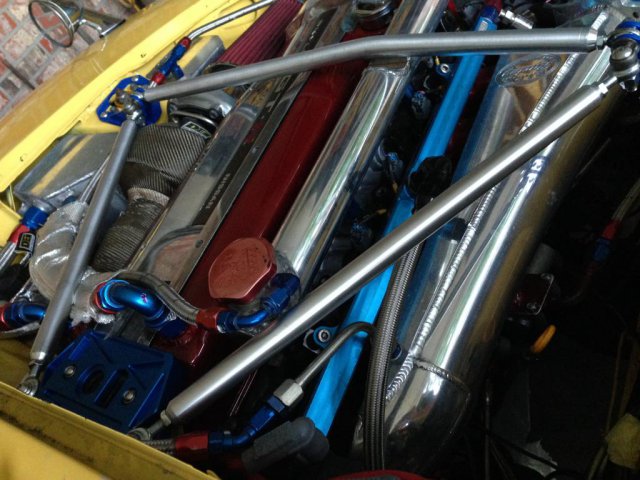

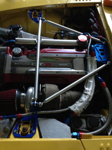

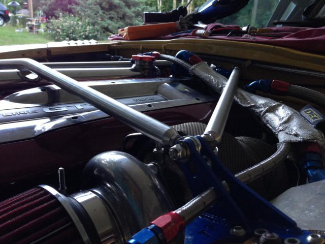

ZT-R Posted May 31, 2015 Author Share Posted May 31, 2015 (edited) Took a lot of modification but i got the T3 tribar to fit. Had to cut of the rear breather on the valve cover, weld it closed, weld in a new bung about 1/2" forward, repaint that, cut off the back of the coolant tank off to allow clearance for the rear bar, weld that back shut, weld in a section to allow the bar to pass through the coolant tank, blah blah. Oh I had to bend the bar about 18 degrees right where the coolant tank sits. Oh had to grind some on the front of the blue bracket at the hood latch to clear the intake valve cover and the spark plug lid. Happy with the results, only have about 1/8" of hood clearance. haha Edited May 31, 2015 by ZT-R Quote Link to comment Share on other sites More sharing options...
