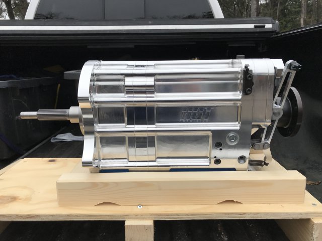

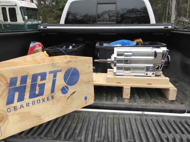

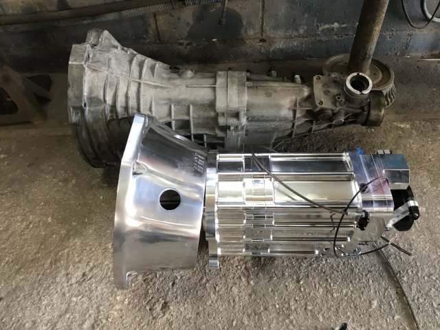

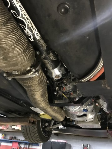

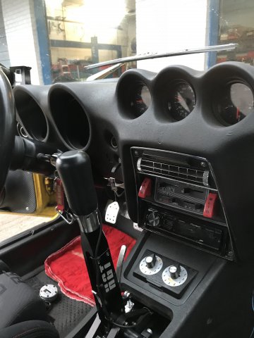

ZT-R Posted July 13, 2018 Author Share Posted July 13, 2018 Oh I did this awhile back. Fun as shit... HGT Precision Gearbox 6 speed sequential with OD Quote Link to comment Share on other sites More sharing options...

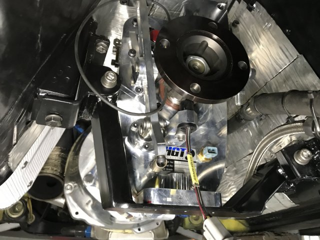

EF Ian Posted August 18, 2018 Share Posted August 18, 2018 That gearbox is bloody awesome. Always wanted to add a PPG Sequential to mine. I looked at HGT boxes but they all seemed to have ratios to short for motorway driving and made a lot of noise? How are you finding these. Entire car is awesome by the way. Quote Link to comment Share on other sites More sharing options...
ZT-R Posted August 18, 2018 Author Share Posted August 18, 2018 (edited) its not that loud for straight cut gears. my rear end is louder. i do have 4.11 gears so at 70-75mph in 6th im about 3900rpm. Edit: It is the 6 speed overdrive. Edited August 19, 2018 by ZT-R Quote Link to comment Share on other sites More sharing options...
EF Ian Posted August 19, 2018 Share Posted August 19, 2018 Not too bad, but would make mine too close to what my Honda is like on the motorway, I am also running 4.11 FD and I like only being at 3050rpm @70mph. That is good though because it means if I were to run one the same as yours all I would need to do is switch to a 3.5 final drive. I'd love to see some more videos of the box in action. Quote Link to comment Share on other sites More sharing options...
ZT-R Posted August 20, 2018 Author Share Posted August 20, 2018 Yea thats what i though, i can just go back to the stock 3.69 of the R230, but really this thing is fun with the short gears, dont really have to petal it much, just grab another gear and its just as fast or faster and to be honest anything above 140 is pretty damn scary anyway, i haven't calculated top speed yet, but im not going down the interstate much either. Quote Link to comment Share on other sites More sharing options...
