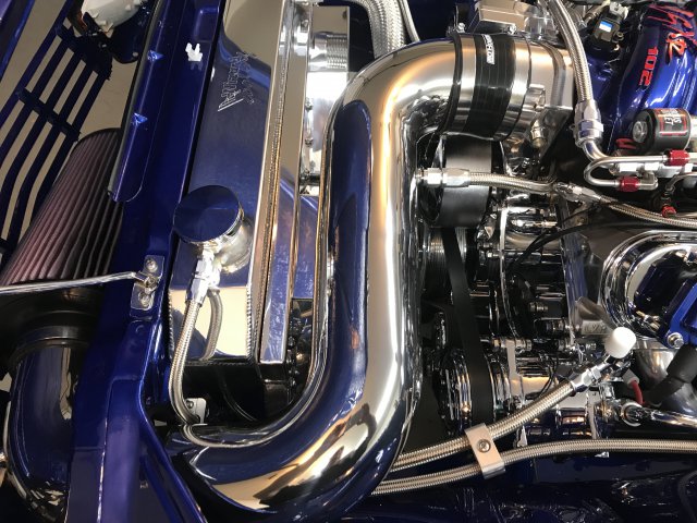

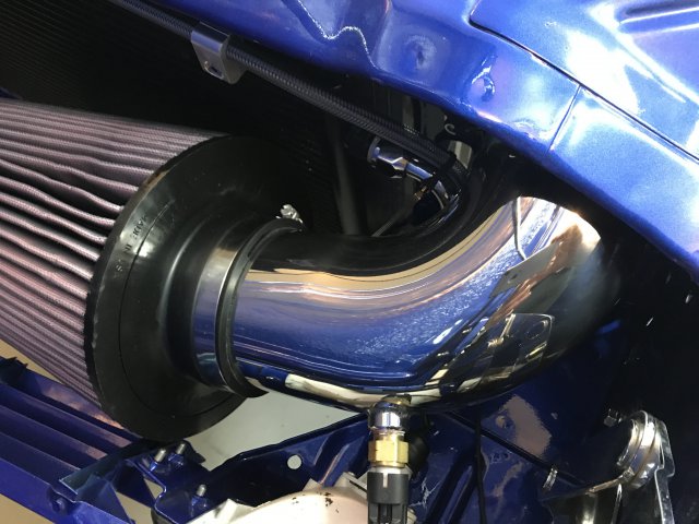

alainburon Posted September 22, 2017 Author Share Posted September 22, 2017 Thanks Guys, We are moving forward again. After numerous attempts we finally got the cold air intake completed. The goal was to make a one piece intake without any welds showing. We made one out of aluminum first and just could not make it smooth enough around the welds to chrome without compromising the integrity of the welds. Not to mention the 4 inch tubing did not line up very good especially if the weld is close to a bend. There seemed to be a step that even though was not noticeable in raw aluminum it would have been magnified once chrome plated. So we decided to go back to the drawing board and make it out of stainless. The guys at Prospeed Autosport formerly D3 Performance did an amazing job welding the intake and the chrome platers gave it the finishing touch. We put the Air Temperature Sensor as far away from the engine bay as possible in order to minimize heat soak and added a 6AN bung for the oil catch can system. I also worked closely with K&N to ensure we have the right size filter for this motor. The last thing I want is for the filter not to flow enough air for the motor and I have seen that numerous times. People using a tiny filter on a big power motor. We also made a bracket which we powder coated black that attaches to the front of the air filter to keep it from moving around. We should be able to fire it up in the next week or so. Can’t wait to hear it run for the first time in years. Quote Link to comment Share on other sites More sharing options...

LLave Posted September 25, 2017 Share Posted September 25, 2017 Amazing work. That filter looks huge! What size is it? Quote Link to comment Share on other sites More sharing options...
alainburon Posted September 25, 2017 Author Share Posted September 25, 2017 Thank you, It's a K&N Air Filter RC-5171 it flows 1654 cfm and my motor requires 1038 cfm according to all the calculations we have done. It is a pretty good size but I wanted to make sure I was covered in case I increase the Nitrous shot. I angled it downwards a little in order not to obstruct the radiator too much. Quote Link to comment Share on other sites More sharing options...
