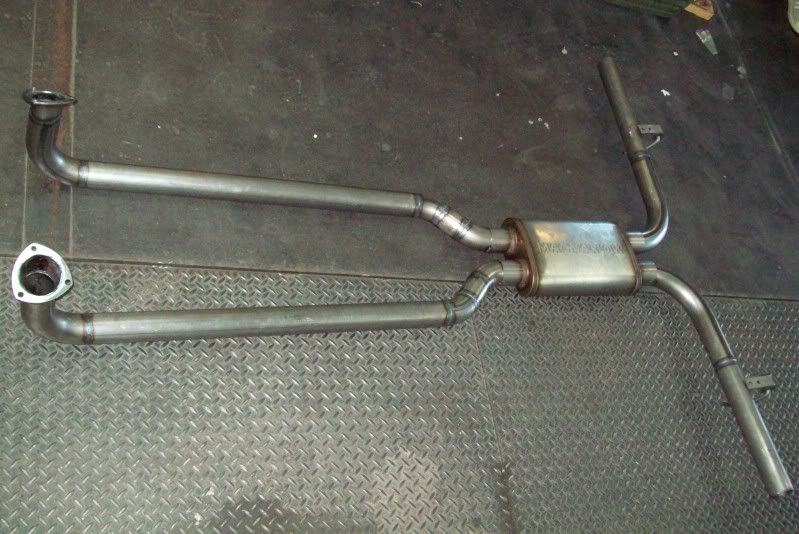

You mean something like the attached? This was a V8 car with dual side pipes. It was a lot louder in the car but much cooler than with the exhaust down the tunnel. You have one of two choices to keep your ground clearance, put it through the lower frame rail or go above the fame rail and poke through the inner fender.
Hmm, looks like attachments can only be 620x280 now. Here's the pic linked.

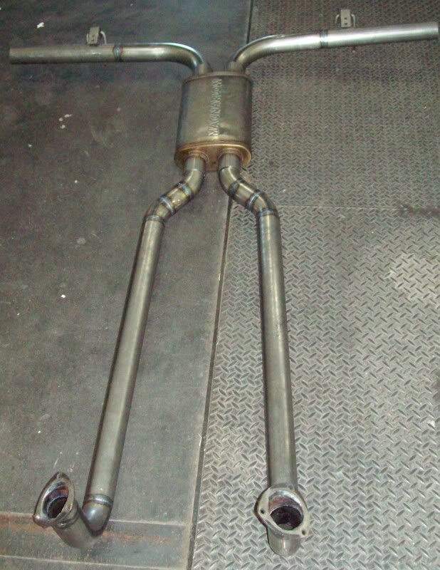

I dont run ovals but here's my pics posted a couple days ago.
