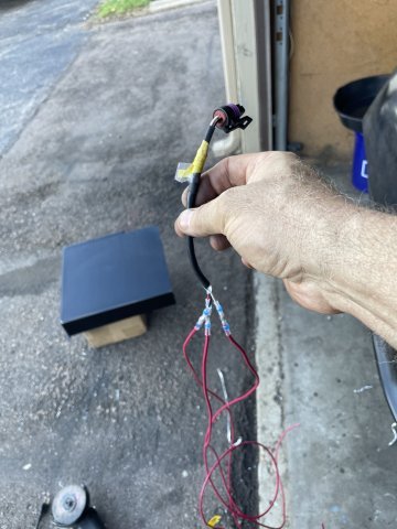

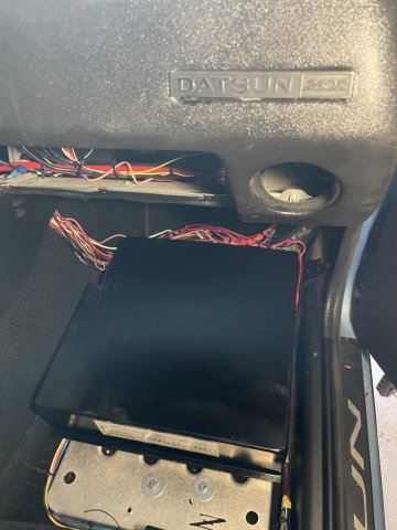

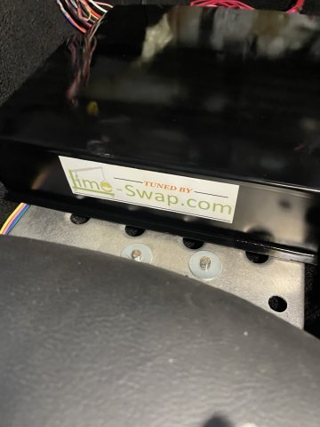

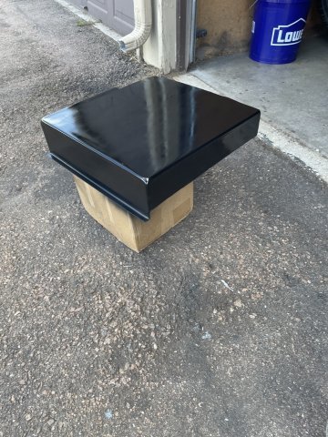

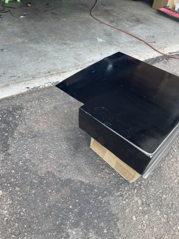

09-20-2026 ATLAS Z UPDATE: I spent most of the day going around fixing connections and getting lights that weren't working.....working. I managed to get it about 99% done. I then cut up and modified the 16X16X4" deep aluminum cake pan I bought to work as a cover for the electrical, and once fitted, I painted it gloss black and added some clear coats. In the pics the wires behind it can be seen....because I have to zip tie them back up after doing my splice repairs, but it fits well. Lastly I started on the 3 gauge sensors in the engine compartment that need to be lengthened to work. I also tried to start the engine.....have plenty of fuel there, so more tracing of wires to find out what is keeping it from starting. PICS
