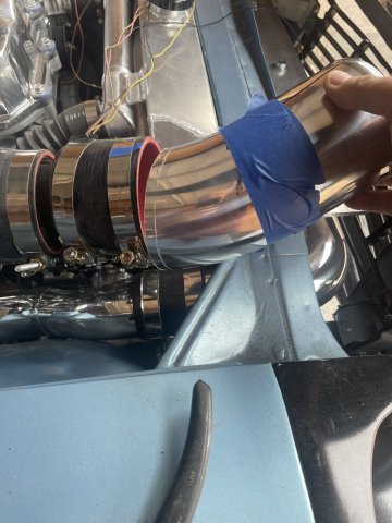

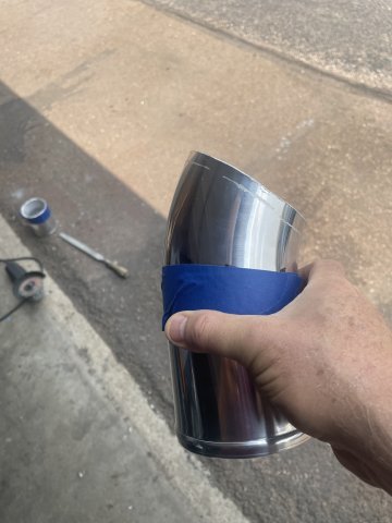

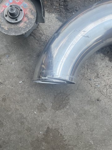

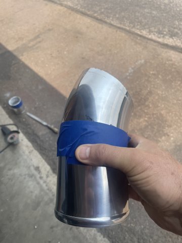

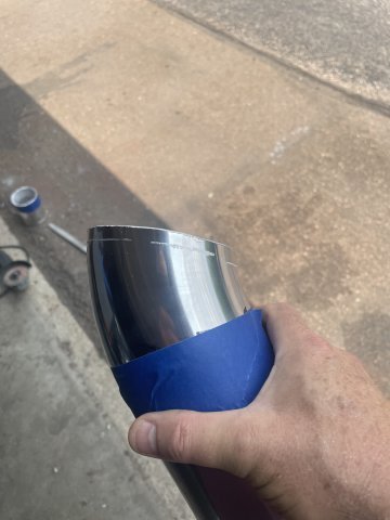

06-23-2026 ATLAS Z UPDATE. Cut and fit the 4" pie for the intake. Using a 45 degree bend, and the 90, I cut turn/twist, cut on angles, and as you can see in the pics, trim off pie cuts to get the angles going where I want them to. This requires drawing a line where the pipes have to meet and welded in just that spot. It exactly what I did with the other pipes. After welding the welds are sanded down smooth and then my polisher does hi part to make it look like a seamless one piece unit. I also used the new air cleaner and marked where farther cutting on the hood was necessary and then cleaned up those edges. later, I will spray gloss black into the cap and use some q tips to paint the cut edge and it will blend right in. I also got the call to go pick up my 3 parts I had wrapped in black DRY carbon fiber....the cowl, rear spoiler and front bumper. PICS:

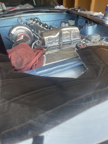

you cant see it well, but no, it is cut out so it clears as the hood sweeps up.
Are you going to have to take the intake off whenever you want to open the hood?

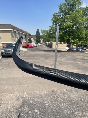

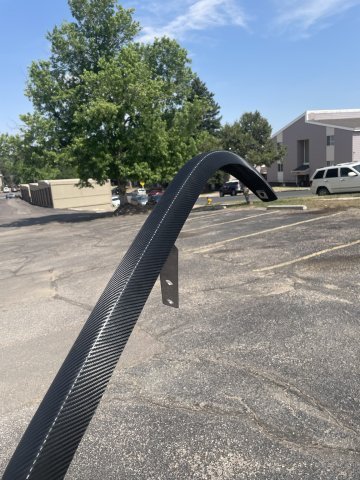

06-19-2026 ATLAS Z UPDATE. I picked up my gas pedal from the fab shop today. I got it home and wiped it down, masked it off and gave it a couple coats of Rustoleum 2x gloss black paint. Should be ready for install tomorrow. PICS:

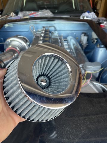

06-18-2026 ATLAS Z UPDATE: Well, after having people tell me about the intake and issues I will have with the MAF meter, and then researching on it, I decided to just redo the intake from the MAF sensor forward. I ordered some 4" pipe, a coupling and clamps and dug in. I did a layout and then cut the hood to start the process of making additional room for a smooth long radius 90 in 4" along with a vortex air cleaner to give the MAF Meter what it needs. In just a couple hours tonight I got a good start on it.....but I will have to do a notch in the radiator support to get the pipe to where it isn't being forced up over it. I am still waiting on the Air cleaner, but the job is well under way PICS:
