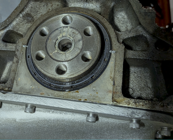

It was the rear main seal leaking, I removed the transmission and could clearly see the oil around the seal:
