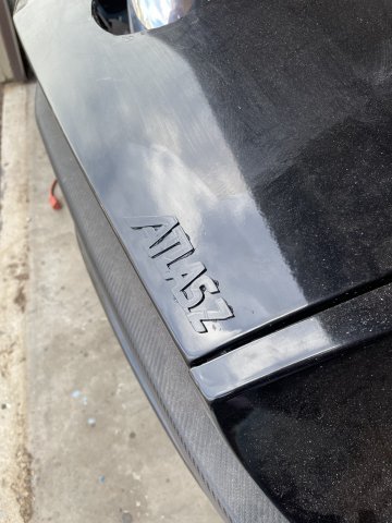

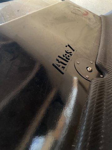

09-27-2026 ATLAS Z UPDATE: Another day of catching up on small items. I went ahead and set up the front end for to do the alignment maybe next week....then I went to the back of the car, tightened down the bolts for the differential, checked the rear brake adjustment, and then finished wiring in the engine sensors to the gauges. I installed a couple emblems on the hood corner and on the decklid above the lock area. I cut a plate and painted it and fit it over the spot on the passenger floor plate to hide the mounting bolts, I will put an atlas Z emblem on there later. I mounted the fire extinguisher to the driver's side foot plate and set it in there for now, I installed the rubber strips I got to cover the window slot at the top of each door, and as you can se from the pics, they need a bit more work on them to finish that but got the ball rolling. I filled the water methanol tank only to find it has a crack and needs to be replaced, so that is added to the list. I spent yesterday on my 240Z, so today was a day to try and get more little nagging things done. PICS:

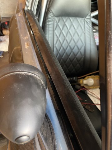

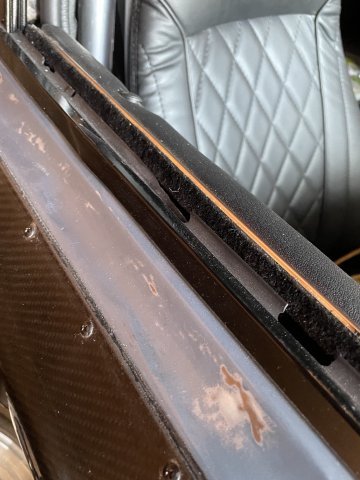

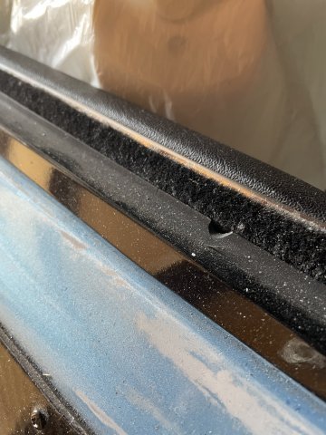

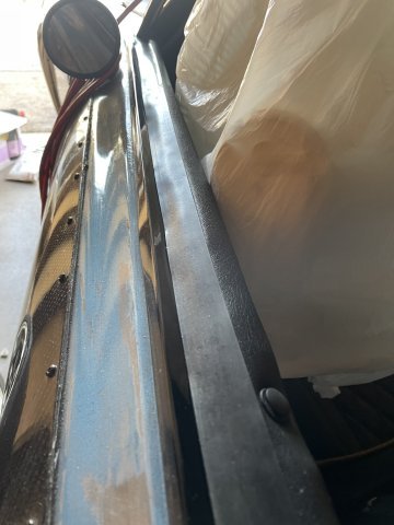

09-19-2026 ATLAS Z UPDATE: I had to replace the O ring around the thermostat, so I got that fixed and got the antifreeze poured back in. Then I did some preliminary electrical checks. a few little things not quite working, so I have to work my way through connections, but 90% is working!! Charging the battery back up to 100% and will try for a start tomorrow hopefully. Then I worked on installing my rear polycarbonate wear "window". I had to trim here and there, and then by trial and error had to keep playing with it and modding here and there but got in finished. in the pics, you can see the small pieces of rubber I installed as a cushion for the window. I got the rubber from Amazon....I can provide a link if you want, jsut ask. God willing I can get out there tomorrow and do some more. PICS
