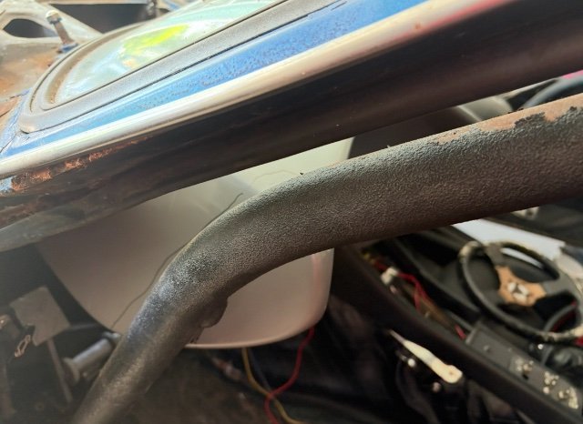

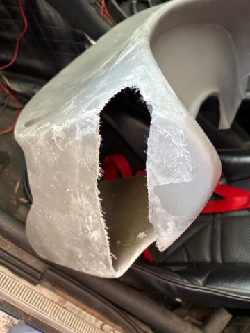

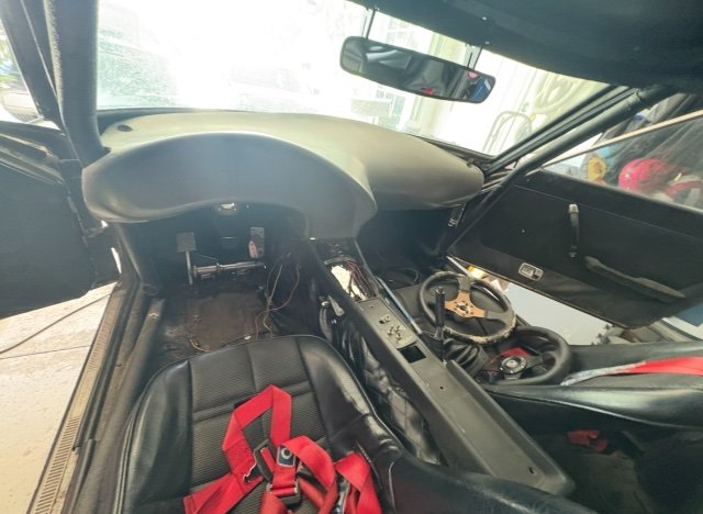

Started cutting on the dash to see how it will fit, roll cage goes through it. Now I need to mock up the digital gauge display and see how it will fit. Displays is bigger than dash think it needs to Poké above dash as steering column looks to sit too close below. Too hot out, done for the day. -

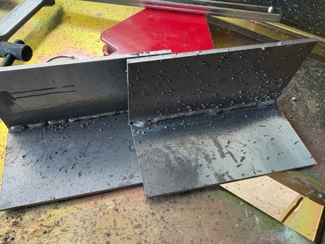

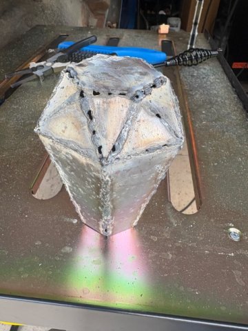

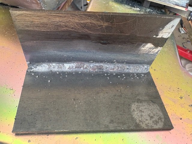

Started learning to weld, here’s my first tries last weekend and through today, about ready to weld on the car. Going to practice on some thinner stuff first to get more practice. -
