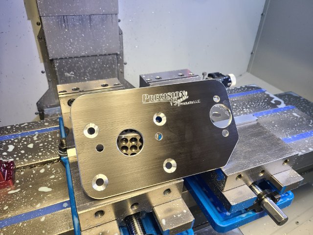

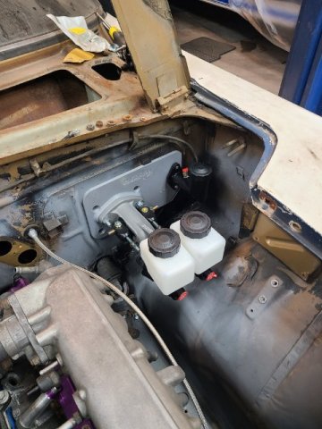

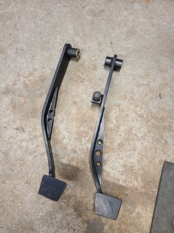

got some more photos uploaded. Switching to manual brakes per the recommendation of wilwood. moved the pivot point for the pedals to give me a 6:1 ratio. Also added one for 5.5:1 and 5:1 incase i feel the need to. welded up a gusset to the "bend" on the pedal as well as machined bronze bushings for the clutch. Designed and 3d printed an adapter plate for the firewall to accept the wilwood balance bar adapter raised to match the 6:1 pedal ratio better. Made a few design changes and machined it out of anodized aluminum. Real happy with how it came out. Ignore the mismatched hardware. thatll get changed later at final assembly. Didn't take any photos but took the factory pedal box assembly out and added some stitch welds around all the spot welded areas to reassure myself that it would hold up to the added abuse of racing. I went to PRI and talked to wilwood and tilton and couldn't come up with a real good reason to spend the extra money on a aftermarket pedal box. so well see how this holds up. I can always change it later. - Today
