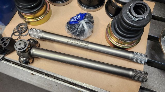

No, i didn't buy them, the goal was to have them made at Volvo Power train as Penta(i'm Volvo Penta) have some of their product development there. but they are over there heads in work so no time for private stuff. I have contacted a guy that makes sequential gearboxes and other fun stuff to make them. /Christian -

5 years to finish, as if you don't have enough stress with this build. At least you got the greenlight for now. Maybe I missed it, but did you buy halfshafts from somewhere, what's the wait on them? -
