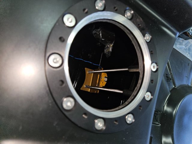

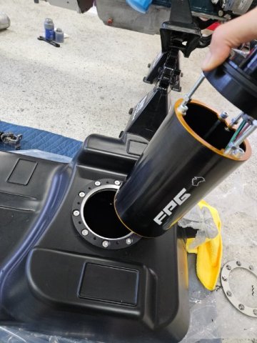

It's been a busy few weeks, but I've recently started back in on the fuel system. Still waiting on some AN fittings to arrive but I think I'll do a -10 SS hardline with a 45 or 90 degree bend directed into the side of the surge tank for the return. The fuel sender arrangement should also work well, having been integrated as part of the surge tank mounting and also top hat connectors. Also, one thing I was not expecting is how expensive submersible fuel safe nylon line is and I suspect it will still need to be replaced every few years. Most of the turbo/wastegate SS fittings and hardline stock have also arrived so I'll be starting back in on that over the fall/winter along with completing the external oil pickup conversion.
