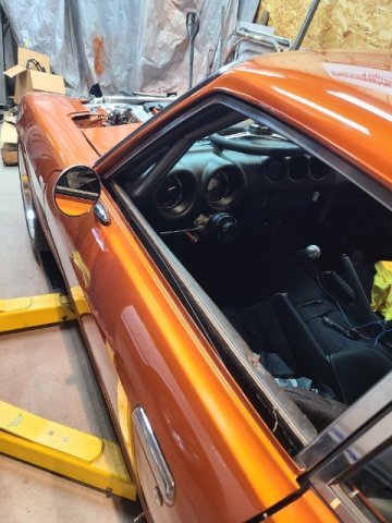

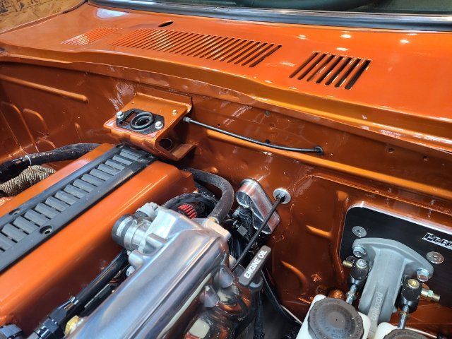

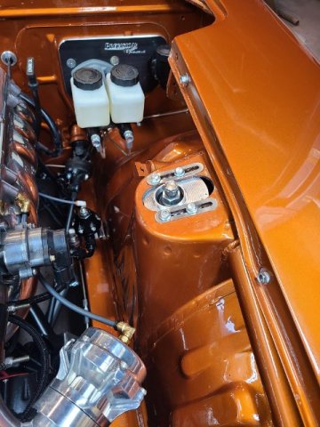

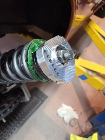

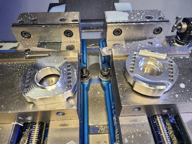

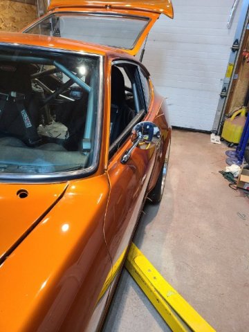

car is officially registered and insured so i spent the weekend trying to button up a few things to make it a bit more "street friendly". did managed to put about 10 miles on it. I have a few things i need to address before racing it but it drove on the street decent. After the initial drive. did a nut and bolt check. then did like 4, did another check, and then another 6ish and everything is looking good. Got the driver mirror on. I wasn't 100% confident id like the round mirror so i designed and 3d printed an adapter to use the factory holes in the door rather than drill new holes i'd regret later. Its growing on me. I may buy a better quality mirror but the round is looking decent. Will still hook up electronic boost control but for now i just put 10psi springs in the wastegate and gave it a vacuum source. When I moved the strut towers back and inboard, i forgot to modify the hood to accept the new position of the strut tops so I designed and machined strut top spacers to push the adjuster down and hopefully clear the hood. I could make them a little thicker as i still have some ride height adjustment on the coilover but i think this will be enough. I'll go slow when closing the hood for the first time. I hooked up the hood release cable. decided to be a little fancier and routed it thru the wiper cowl instead of having the cable extend all the way across the engine bay. need to make a new handle for the cable pull as mine is MIA. Got the hood hinges cleaned up and painted black. fedex lost my order for replacement couplers to move my air filter to clear the hood tension bars so i didnt get the hood on this weekend. - Today
