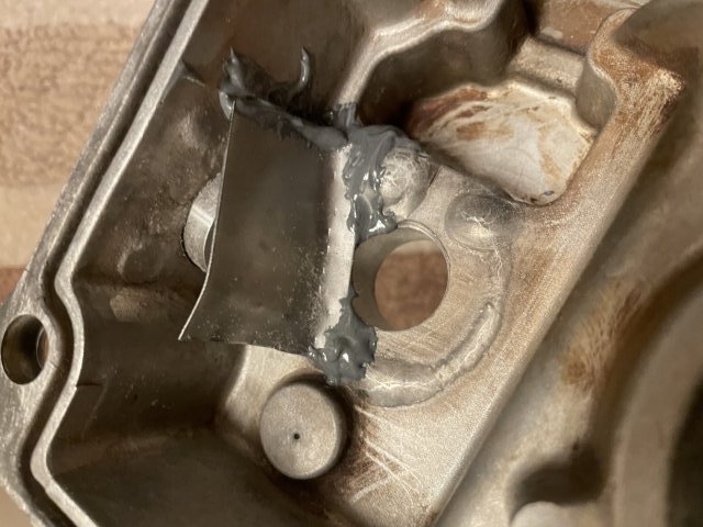

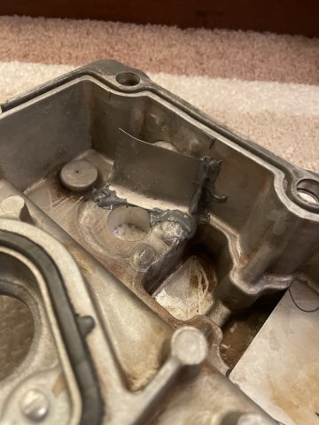

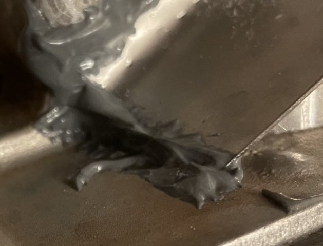

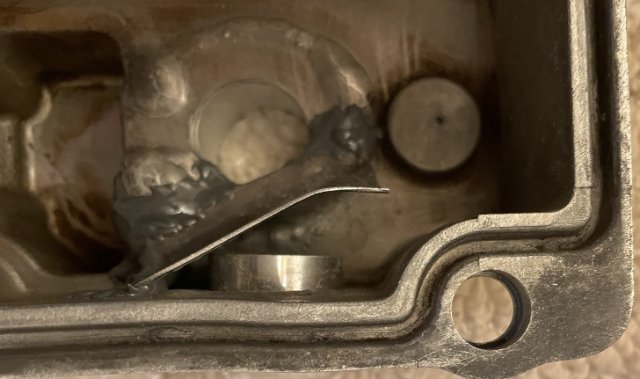

I went ahead and reattached the baffle for my valve cover using the original JB Weld. It is so strong when you TRY to push it, it doesn't move! This will work!

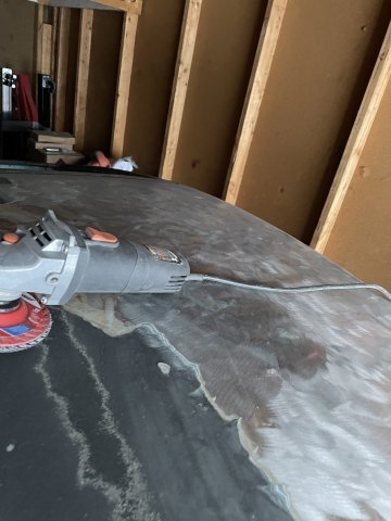

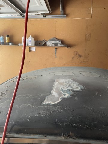

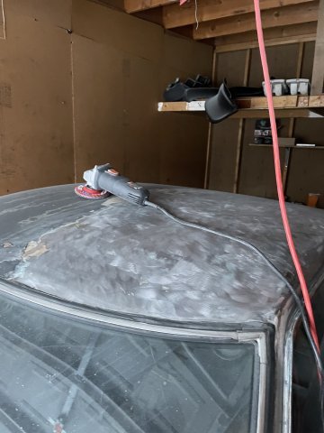

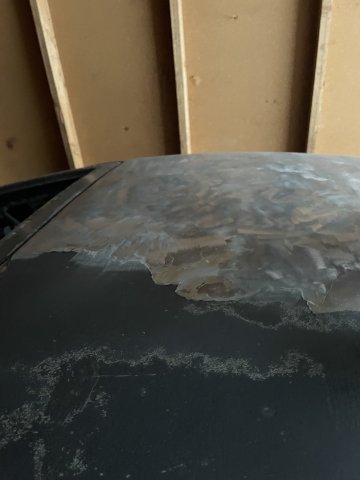

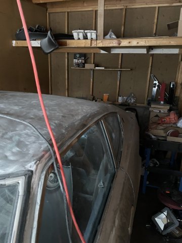

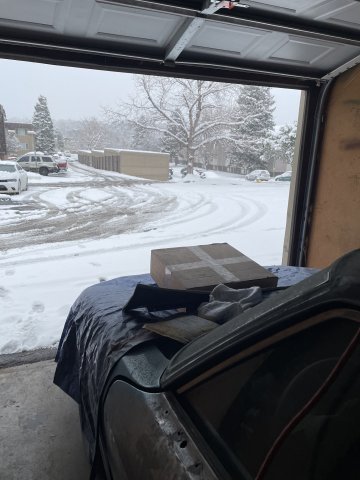

12-03-2025. At home, and it is COLD (20 degrees) and snowy. I put on 3 layers of clothes and went out to remove some more old paint off the 260Z. Hands and feet got cold, otherwise not bad. had to stop twice and use my leaf blower to blow all the paint dust out of the garage. amazing how much is created....and as usual this paint is VERY hard to remove. 60 grit flap disc on an angle grinder. I will have to go over all panels with a DA sander and 80 grit to get it smooth......way too cold to put filler on it, but I will start blocking it out once the weather gets warmer.
