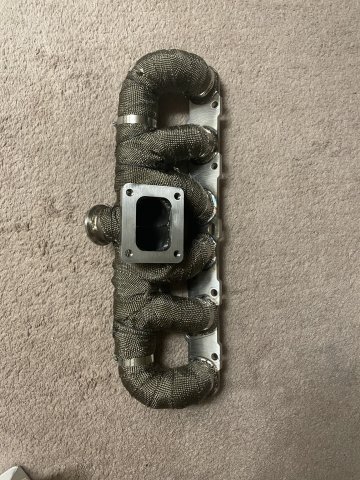

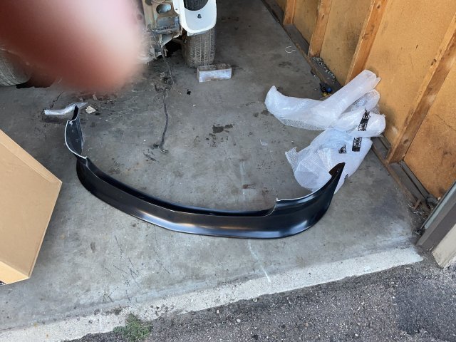

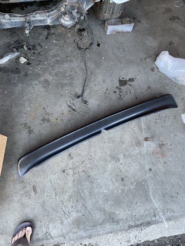

Well my air dam and rear spoiler for my 260Z came in from Motorsport Auto (MSA) today! Replaced my new engine hoist that bent under weight at Harbor Freight, and finished up the turbo manifold header wrap for the 4200. Pretty cool day!

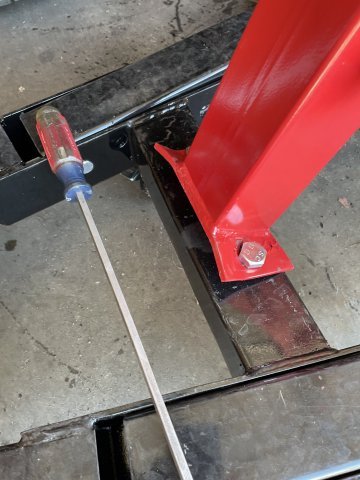

10-15-2025. Busy morning in the garage. My 260Z gave up its engine and trans to make way for a future ATLAS install. And yes, it fought me A LOT. My new Harbor Freight hoist gave out midway through, but I got it to limp along with 2 floor jacks and a neighbor guy to basically wrestle it out. From now on, engine only....no more transmission attached for me. Yep....I cut the firewall bracing. It was my plan to do so anyway, and to reinforce and make it removable. I measured before cutting it and sure enough it widened 1/4 inch after cut. After I have made the brackets for re-installing the piece, I will simply use a ratchet strap to pull it back to the correct distance and bolt it in with grade 8 bolts. All nice and pretty. reinforced with thick plate steel. Inside the tubing I will put a spacer for the bolt to go through so when tightened it will keep the tubing from buckling. We move forward!

That's Merle. He still has it. He got it running, and all is well. In the 6 cylinder portion of this webpage is the build of my 4.2. got a good start on the header wrap for the 4200 today. ran out so waiting for more.
