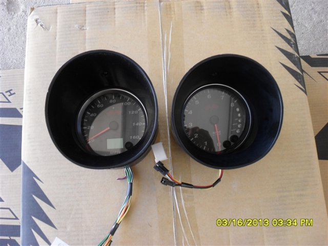

  16. Speedhut gauges , love them . Check out my thread on how to .
