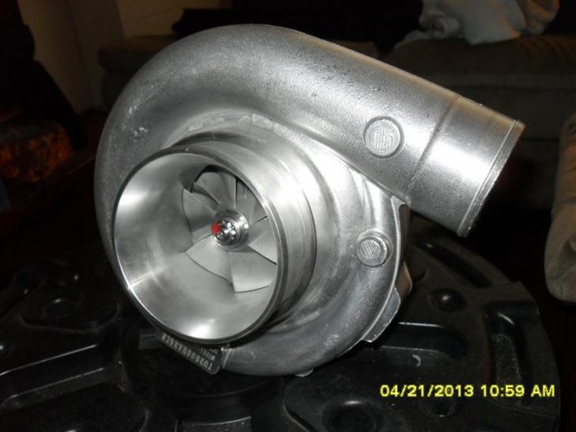

  16. Working on a Dodge truck at the moment . I took a look at the turbo and said to myself this would be a good turbo to use , It has built in waste gate . Then i pulled the intake boot off to check the comp. wheel , it's only half the size of the 76mm turbo . My goal is to get somewhere 650-700 hp out of a 6.0 motor . As posted before , already bought LS3 heads and intake . It's going to be a slow build , need to get a solid 8.8 rearend installed in my ZXT first .

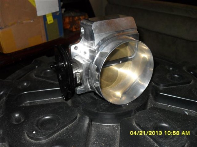

  17. Both turbo and throttle body are made in China . I did compare On3 turbo and China turbo , they look almost identical ( about $75 different for 76mm turbo ) . Throttle body housing looks great but the blade is not so good , not 100% centered . Might have idling issue . Only $100 for 102mm . Going to try and fix it .
  18. Has anyone ran Ebay turbo and/or throttle body on the LS ? Need some feedback .
