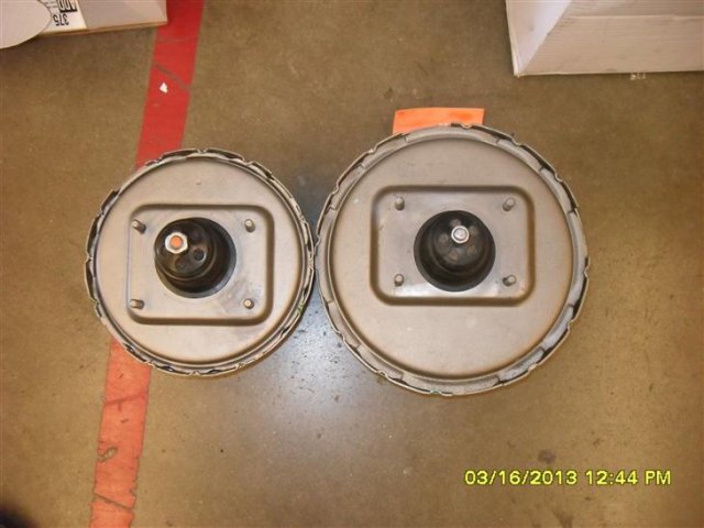

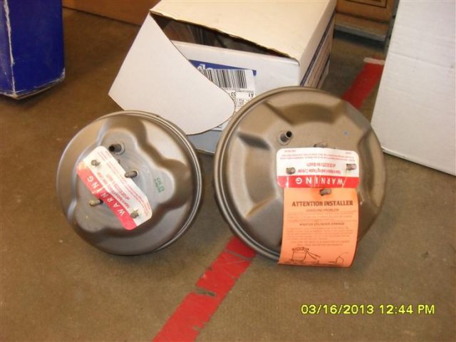

  14. The 87 300ZX won't work without mod. and it's about 8" diam. but a little thicker . Going to use the 10" booster with bigger master cylinder , 79-81 280ZX . Unless i can find a different master . Here are 2 pics. 10" booster will not work with standard trans w clutch master cylinder . This is the reason why standard trans. has 8" booster .
