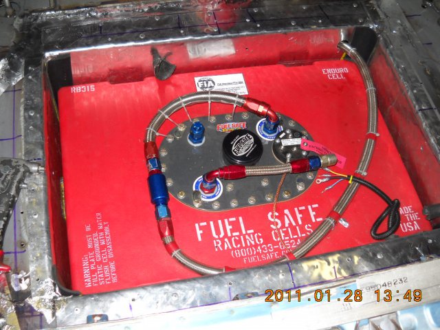

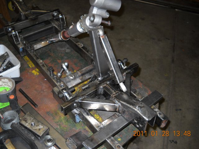

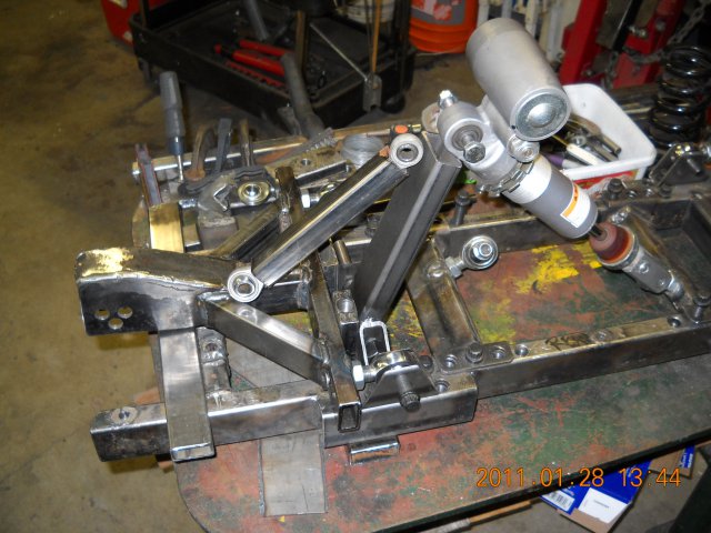

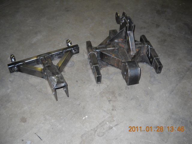

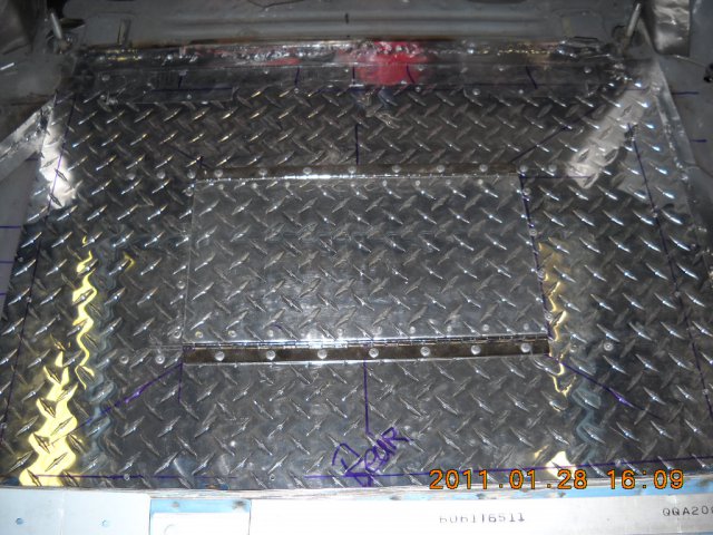

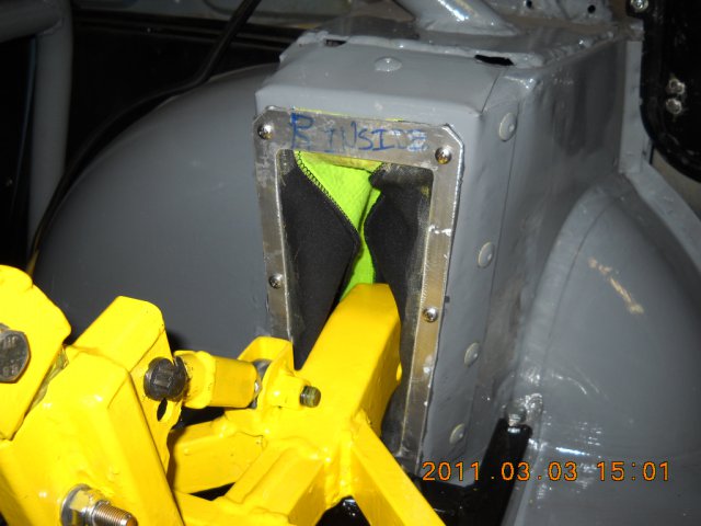

Here are some more pics of the latest mods. The fuel cell is almost ready to get its lid(waiting for a fitting). I am using aluminum Diamond plate for the can and cover. I also went with another piano hinge latch assy. I have also fabbed up a couple of new rear A-Arms. The originals weighed a ghastly 18 lbs. each. The new ones come in at 9 lbs. I modified the way the shock attaches by using an adjustable push rod,to a center link, then to the shock. I can change the push rod length, and the lower shock mounting position to change the way the spring rate rises. The center link may be modified for adjustable length at a later date. The rear susp. will be sealed using the legs from a neoprene wet suit as flexable seals. Wet suit was purchased on E-bay for $5. I love E-bay!! Mongo

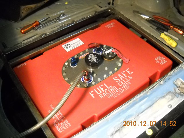

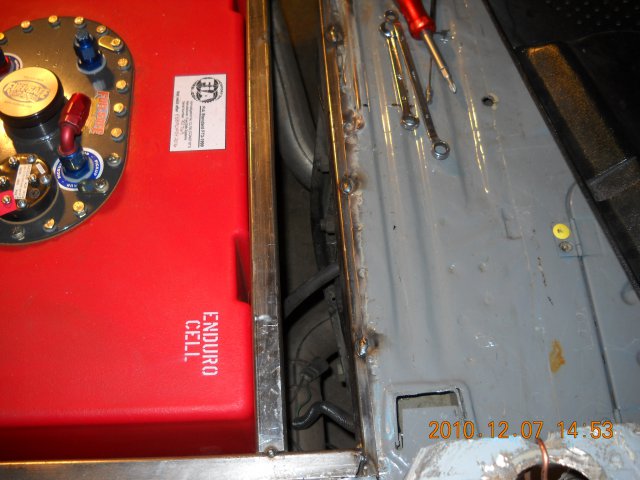

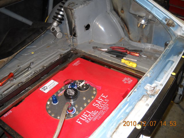

I have been installing a new Fuel Cell. I still have to build the can to set it in. I also need to figure out a good way to run my fuel and vent lines lines. As soon as I get this finished up, I will move on to rear a-arm mods. Here are some pics. Mongo
