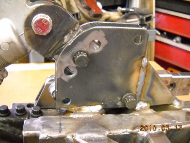

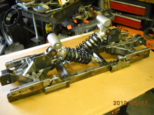

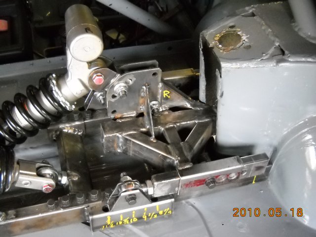

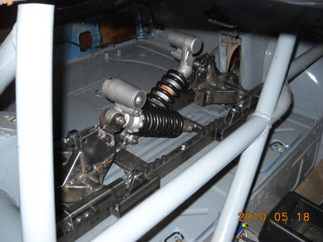

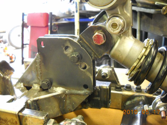

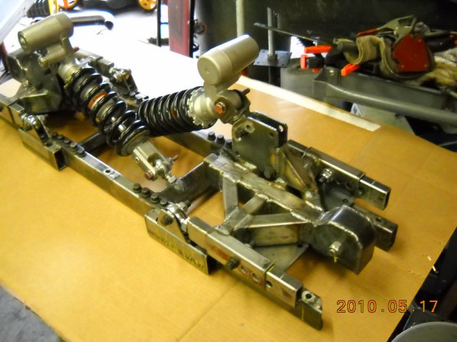

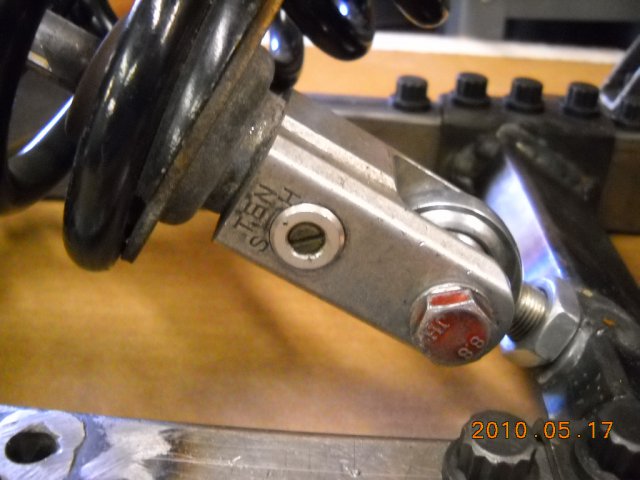

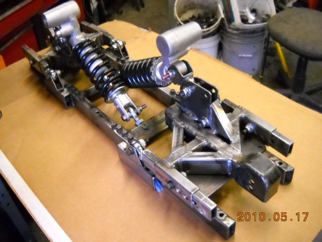

	I finished up the prototype of the rear suspension and I will be installing it in the next couple of days. It will bolt to the floor behind the passengers and will be accessable and adjustable thru the hatch. The upper arms have been changed from my original design. They are adjustable for length, pivot height and camber settings. The shocks have an adjustable lower mount as well as an adjustable moment arm length. The shocks are double adjustable, and the spring has an adjustable preload. If you take a look you will see that all rough adjustments are done by moving locating points and fine adjustments are done by adjusting the Heim Joints. There are serveral things I will be looking at to improve as I develop this system and I will probably be adding an adjustable sway bar in the future. This setup is fairly heavy at a total of 80#. It will be substantially lighter when it is fully developed. It has been built with extreme reliability and adjustability in mind. Once the final dimensions are worked out the arms will be redesigned with weight savings in mind. I believe I can reduce the final weight buy 25-30#. This will put it at a weight gain over stock of 20-30#. The last few pics are of the complete suspension with the old design arms. They should help give you an overall picture of how it goes together. Any way, here it is. I have added some pics with it installed in the car. More pics to follow as assembly progress's Mongo

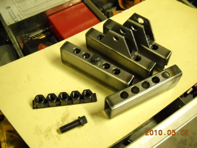

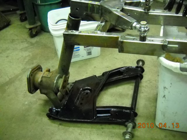

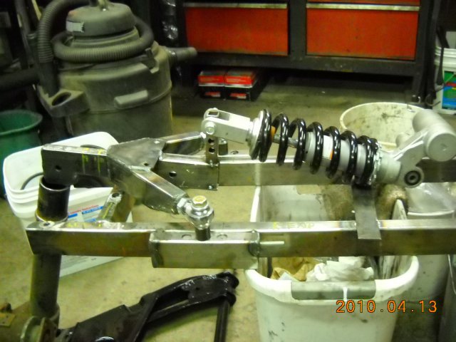

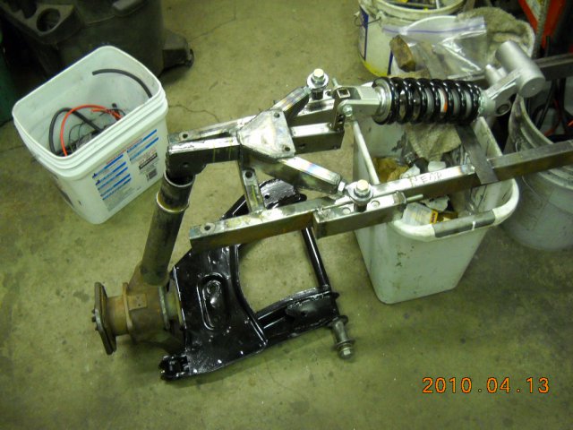

	Logan, I hope to run 8-1/2" fronts, 9-1/2" rear wheels. I have been busy on the rear suspension build. I have been building parts and hope to have the assembly in the car in a week or so. I realized that I have not been calling this by its correct name,as the rear suspension is a rocker arm set-up and not a simple double a-arm set-up. Here are some of the latest parts from my work bench. The first pics are of the rocker arms and the upper Heim joint. Do not be fooled buy the look of this rocker set as the Heim is massive!! It is a 1-1/4 in Heim that is designed to use a 1" through bolt. It probably way over size, but this is to be a street driven car and I don't want any failures. The second set of pics are of the rocker length nut plates and show there details. More pics will follow later in the week as more parts are fabbed up. Mongo
