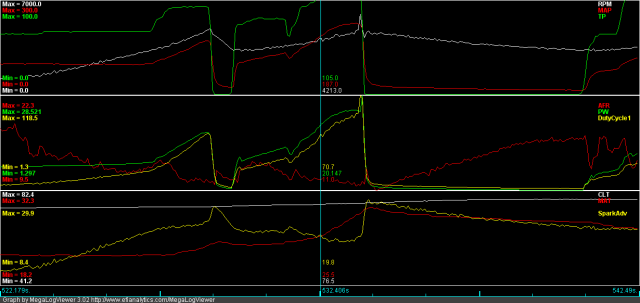

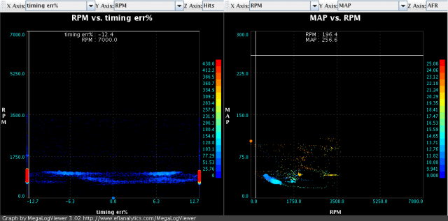

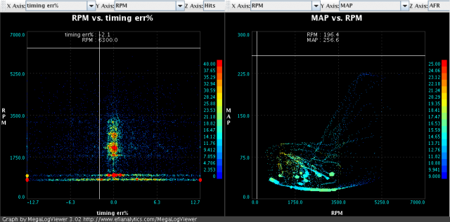

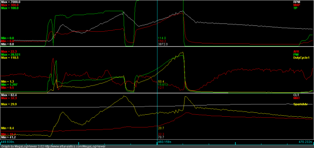

  22. Well, I've run into a few small issues. In order or importance: 1) Exhaust is too low 2) Surging at WOT 3) Exhaust v-band leaks 4) Exhaust flange leaks 5) A coolant leak that requires "touch-up" welding 6) Leaning out at tip-in (accel-enrich) 7) Fuel pump might be dying. Again. 8) RPM's are shaky at high load Here's a couple graphs that shows lean tip-in, and the shaky RPMS: There's a nearly 1000 RPM spike between samples in one instance. I don't think my car accelerates that fast. This is also when the turbo is surging, but I can't feel it. And the effective MAP (after the throttle body) is pretty solid. I would really like to solve that problem. I will try shielding the CAS wires more, and some other ground tweaks. And here is a before and after of timing error vs RPM: Using the 6 slot CAS: Using the (12-1)*2 CAS wheel: But either way, the AFRS are a steady 10.5 under high load, so I'm still beating on it trying get other things broken: I am going to switch out wastegate springs to a "8 psi" one. Which will probably end up being 10psi, since the "14 psi" spring in it now results in 17.5 psi. My boost controller has been off to run the spring pressure.
