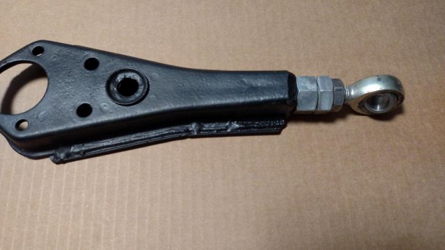

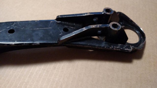

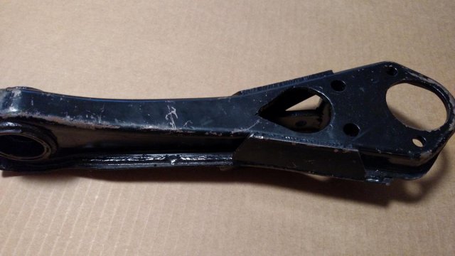

  3. No carnage. That's the one that didn't snap. The rod end was the same one used in the restoration of the 1991 Ferrari IMSA car and it held up just fine. As to the added strengthening parts, that particular LCA was built in the South St. Datsun dealership which was also the home of Bob Sharp Racing. Those LCAs saw service in the C- Production and GTU S30 body race cars. I figured while it may have been overkill, it was them not me that the added 5lbs per must of seemed worth it at the time. The front sway bar was likely in the 1.25 to 1.5-inch range. I have several of them in labeled tubes.
  4. Due to the rules set forth by the vintage race groups (SVRA, VRG, etc.), 15 inch tires are available from many tire companies. I am required to run a non-slick so I opt to use Toyo RA-1s (the 888s are not worth the money and are like running on ice skates). The RAs are good out of the package and get better with time, until they aren't. Good in the rain as well. Of course if a 15-inch wheel won't fit over your brake caliper, it's 16s which I run on the street Z (245/45/16 on 16X8 BBS rims).
  5. I have added a photo of the LCA we built (failed) and a few of the BSR LCA I have. Note on the BSR LCA it has been opened up to allow the end link to be attached. The front sway bar was inserted in a tube that was welded into the engine bay rails. The gussets and connections added 5 lbs more to each side. The end at the crossmember pivot point was cut back and the front lip was trimmed to avoid hitting the rotors.

  7. When I get back this weekend I'll get the one arm that broke out of storage and take some pictures along with the BSR LCA

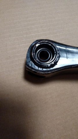

  9. We got a prototype set from someone we trust and then we made a set of our own. Both failed within 5 laps under heavy braking. I have the TTT LCAs on my street Z which sits at under 6 inches (less than 3 inches at the edge of the AZ Z oil pan) and have not had Any issues with it at all and it uses the raised pickup point which the race car is not allowed to use. The race car uses a stock LCA with the delrin adjustable bushing. I have one of the original BSR modified LCAs and they gusseted the top and bottom plus pressed in a ball bushing. It weights nearly 5 lbs per side more than a stock part. Considering they drilled 3/16th holes in the inner door pulls that 10 lbs was worth it to them. Both the race car and the street Z have the heim jointed outer tie rods as I had the same problem with the geometry/replacing the inners. Over 30 track days and 15,000 on the street Z without an inner rod replacement.
