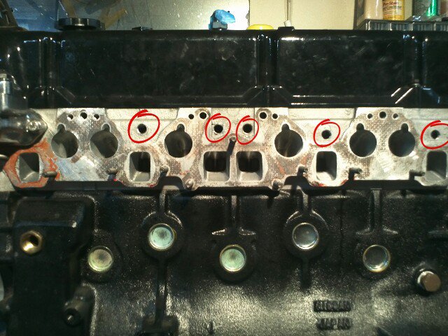

  16. Well, since the head was off the block... The two over #5 & 6 were drilled by Rebello per my request. They drilled them a little lower than I wanted, requiring the manifold to be carved out for #5 to fit...no big deal.
  17. Yes, the pocket extends across both exhaust ports.
  18. I forgot to mention that I'm also running their pump speed controller so the pump will be running 1/2 speed at idle and low load situations. Hopefully this will also help reduce noise associated with the pump.
  19. If you look at Aeromotive's A1000 installation instructions you will find that they recommend -10 fuel line from the tank to pump to fuel rail to pressure regulator then -6 fuel line from the bypass back to the tank. That setup is reflected in the A1000 regulator: -10 input and -6 bypass. I'm going to run -10 all the way to the regulator (post fuel rail) and plug the remaining -10 input hole. For the return I'm using 1/2" tube so have a -6 to 1/2" tube adapter.
  20. It clears both intake and exhaust manifolds so I guess I'm satisfied. I forgot to mention that the top of that hole is at the very top of the internal ceiling of the water jacket. You go any higher and you will cut into the ceiling wall. I also plugged the internal bypass hole and drilled out almost every coolant hole in the block and head that was present in the N42 MLS gasket. There was one hole in the head (P90A) that wasn't present in the gasket or head. I didn't mess with the gasket for fear of tearing it up. I figured that the hole above #4 is close enough to 3 to count for both . I think you would have to scarf out the manifolds to get a larger fitting in there. At least a fitting like the one I have that is removable with the manifolds attached. There is only .06" between the tips of the fitting nut and the intake manifold. You could move the hole a little aft to gain more clearance to the exhaust.
