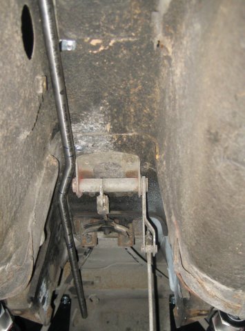

I bent most of the 5/8" feed line; tucking it up in the tunnel as tight as I could get it. Took me close to 3 hours to do this one line. Most of that time was spent measuring and visualizing. I may spend a little more time getting the engine end a little tighter against the fire wall. The pump and engine ends are long so they can be trimmed to fit once the mating components are installed. I also spent a great deal of time deciding where to locate the pump. It's so darn big there aren't many choices. I finally decided to locate it just in front of the tank in the space where the factory electric pump mounted...except much lower so that it is just even with the bottom of the tank.

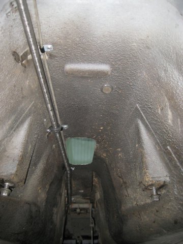

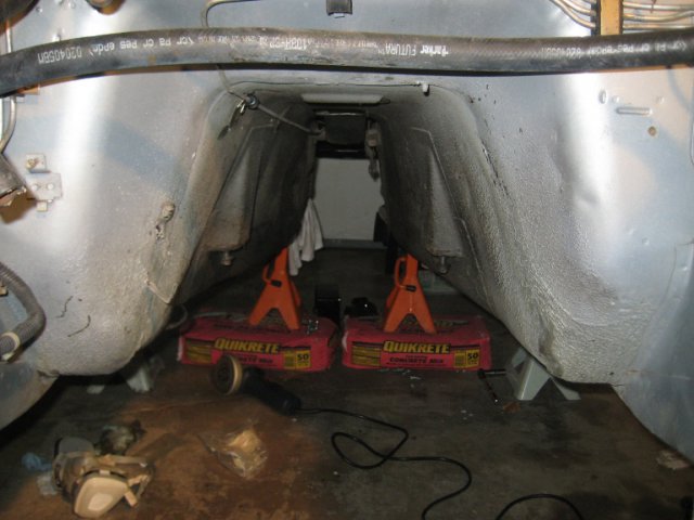

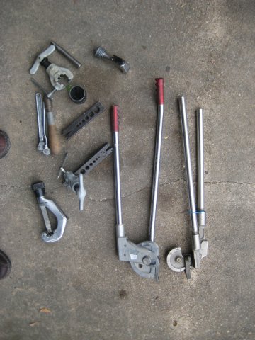

Here is what the transmission tunnel looks like now. I'd say I have pretty good access Old hardened bags of concrete work well for stand-offs to hold the suspension. Here are the tools I borrowed for the project. 5/8", 1/2", and 3/16" benders, flaring tool, reamers and tube cutters. He also gave me a few basic instructions like, do a couple of trial bends first, work left to right, bend a little and test fit, repeat, etc. A friend of mine suggested making a template out of something soft first than using that as a guide for the real deal. Any ideas what I can use? Looking for something that doesn't cost $100 a stick...

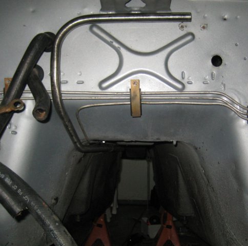

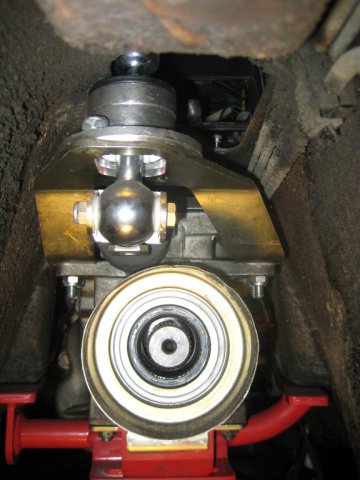

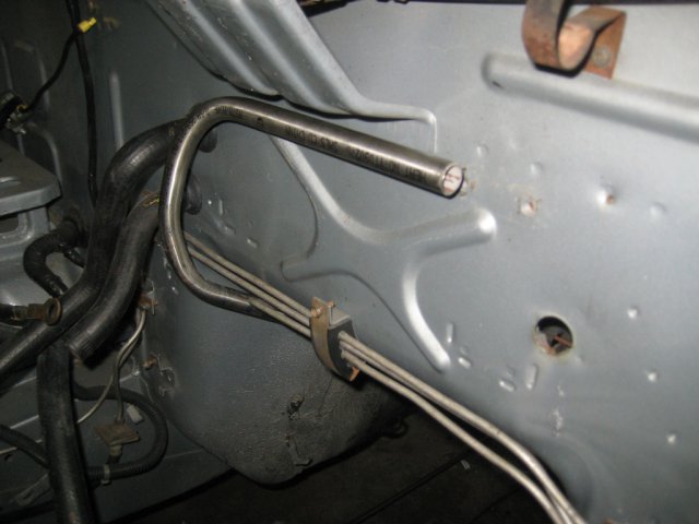

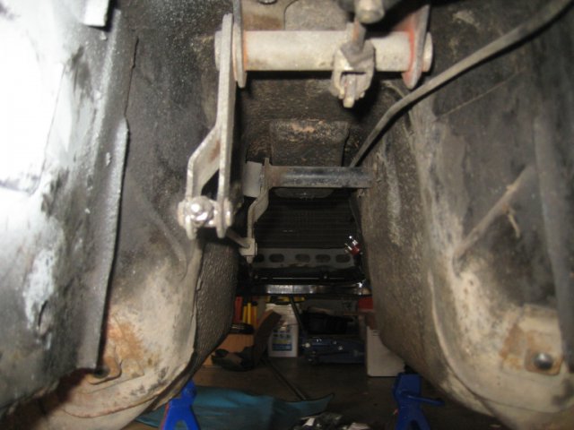

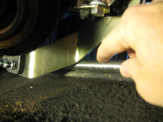

I'm preparing to install custom fuel lines in my 240z. I plan to run the feed and return up in the top passenger side of the tunnel similar to this. The tubing is 316L 5/8" (feed) and 1/2" (return) .035 wall. I borrowed a set of manual pipe benders and 37 degree flaring tools from a guy at work. I'm looking for advice, tips, tricks, etc. on how to best attack this project. I believe the trickiest part of my install is going to be tucking the pipe far enough in the tunnel to clear the z32 gearbox and shifter mount. Here is a picture of the situation. It's hard to tell but the 5/8" pipe I'm holding clears the shifter mount by about .25". That is with it on top of the old pipe. I have removed all of those lines except the brake line. The new runs will of course be up against the tunnel offset by the thickness of an Adel clamp. I'll probably trim a little off the shifter mount for good measure.
