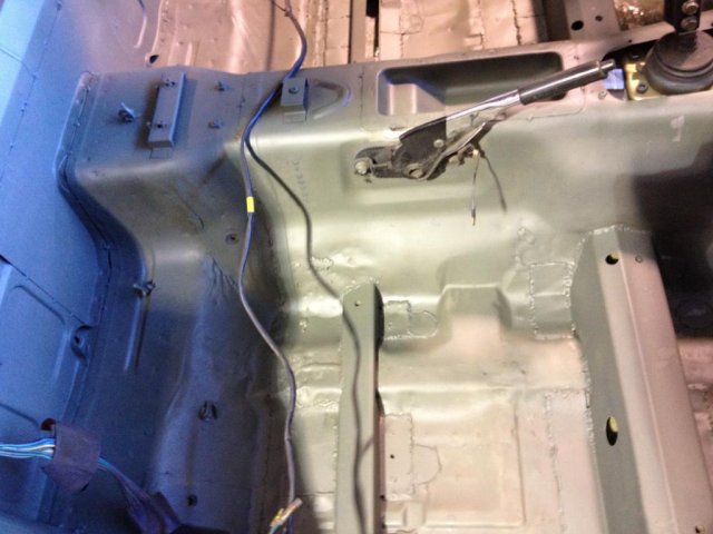

  4. Last weekend and today was cleaning the interior out and priming. Next is seam sealing and lizard skin.
