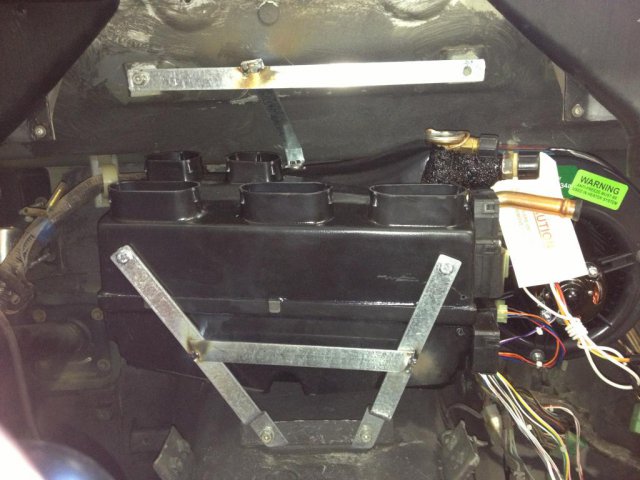

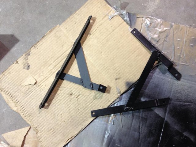

Today was installing a vintage air gen II compac into the 1978 Datsun 280z. It's a tight fit but I managed to get it to fit without interfering with anything on the dash. To do that I had to install it slightly off center towards the drivers side, maybe 1", and when viewed from above the drivers side is about 1/2" or so more forward that the passenger side. Brackets weren't too bad to figure out. What sucked was climbing in and out of the car dozens of times to cut, measure, bend.....
