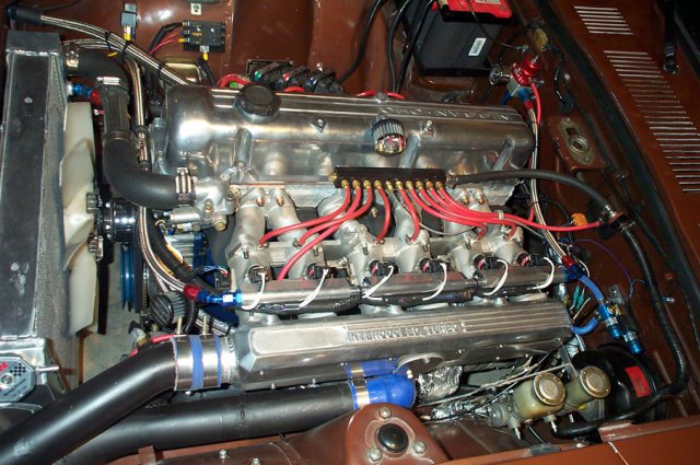

Does anyone have experience regarding the importance of matching the piston dish to the kidney shaped combustion chamber of the P90 head? ...."importance" discussed below as hp, torque and engine response. Background; my question relates to an L series turbo non stroker currently making approximately 450-475+ rwhp. Fully ported P90, aggressive cam, ITB’s, GTX35r, custom turbo header, arp throughout, TEC3r engine management system, etc. Currently running 88.5 mm JE forged round dished pistons. For various reasons I will be freshening the engine this winter. I may be converting to a stroker if the killer deal on a LD28 crank comes through. If I build to a stroker, no question, I will run forged pistons matching the quench area of the P90 head. If the LD28 deal falls through, I’m asking myself, should I sell my current JE round dish forged pistons and replace them with forged pistons that have a dish matching the P90 closed chamber? I understand that by matching the piston dish with the kidney shape combustion chamber, the flame front doesn’t have to travel so far allowing optimal ignition advance due to the more efficient quench area. But I don't know to what degree performance is enhanced by this on an L series motor. So here’s the question - On an L series making 450+ rwhp on 91 octane California pump gas, all things being equal except for the round dish piston design, does anyone have experience/knowledge regarding increase in hp, torque, and engine response by going from a round dish piston design to a piston dish design matching the kidney shaped combustion chamber of the P90 head? Thanks guys.
