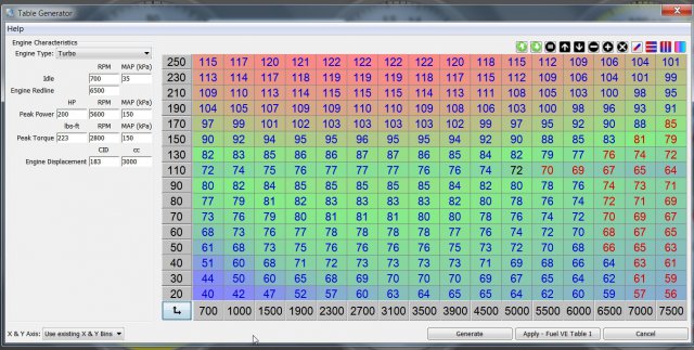

Tuner Studio' VE table generator doesn't always. handle high horsepower numbers well. It's not a true VE calculator. It can sometimes calculate some truly bizarre VE Tables when large HP and Torque numbers are added. If you use the MS-2 VE Table as generated by TS, it always seems to make the non-boosted area overly rich ( Too high of cell numbers ) . Particularly if you don't have accurate Dyno figures. Of course how do you get accurate Dyno figures if you haven't gotten the engine running properly yet? Catch 22. As a result I find it more accurate to enter the stock HP and Torque figures and generate a table. That is normally pretty close up to 100 Kpa and at least makes the non-boosted area driveable. In boost I'll add an Extra 10 to 20% increase to the rows in ascending order. Just to be sure it's Rich enough. Always better to pull fuel out under Boost than to have to add it in. Auto-Tune is not fast enough to correct a Lean condition under WOT Boost. Actually, I want to double check that 4.8ms Tune that I posted. That came off a " problem child " car and I really had to pull the Req-Fuel down to get the VE Table even remotely accurate and with some resolution. As TS originally calculated it we were down in the 12 range at idle... which is not good. As mentioned though. The Req-Fuel calculation is just a number in an equation. Reduce it to get more resolution in the VE cells at the low end. Leave it alone if the resolution is OK. -

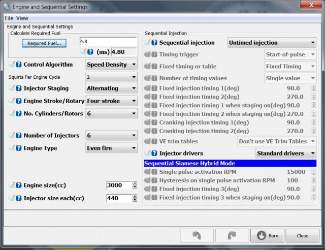

I meant reduce spark table 3 degrees overall when Boosting IE: over 100Kpa. "Under Boost " meant when ON Boost. I used a PW calculator developed for Haltech. It's very good. Numerous other online calculators and they all come up with the same answers. I enter the figures to get a Master PW and then add about 1ms to take care of the additional enrichment values. 4.8ms was a figure I had derived from a L28 Turbo with 440cc injectors. Another 200cc in your engine won't make a lot of difference in the Req-Fuel calculation . The tables I posted were for 440cc injectors. Here is the Injector Calculator I use, Note : For Sequential injection use an ambient temperature figure of 25c. For Batch Fire use 35c Injection Time Calculator V2.0.xls -

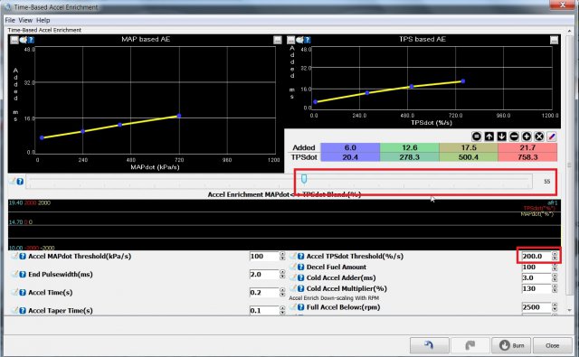

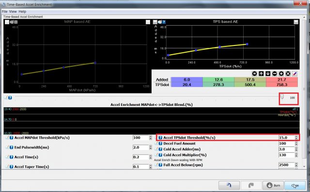

Change the first value to at least double your idle PW value. After you have loaded up the new Req-Fuel Values and re-scaled your VE table as per post above. Once you get the Tune dialed in and Auto-Tuned so that it's not running overly Rich every where, you will probably find that you have to raise the Slope angle of the TpsDot curve. Engiens don't need much AE when they are running extra Rich. Make sure that you change the TpsDot threshold down to about 20. -

40cc injectors with Batch fire? . Try 4.8 ms Req-Fuel. Set to Injector scaling to alternating ( Smooths fuel rail pulsations ) and squirts to 2. alternating Re-scale VE table via generating a new VE Table. Set parameters as per attached picture. I think this will be a good starting point. You will of course have to retune idle and Auto-Tune. -

One of the strange things about Tuner Studio is how they used Req-Fuel. Required fuel in most other systems is a calculation for the Master Pulse Width. That is a multiplier factor. Then other enrichments such as AE and WUE are calculated separately as Additive factors. Tuner Studio has combined both the PW multiplier and Additive enrichment factors in the Req-Fuel calculation. This is a bit of a programming shortcut, but it does have one undesirable effect. Often the Req-Fuel calculation is too large, especially with larger injectors. What this does is to create low RPM and Load Cells with very low values. This affects your resolution.in Tuning ability. IE; Go from a 10 to a 9 in an idle Cell, and that is a 10% change. Go from a 50 to 49 and that is only a 2% change. The VE cell values are just Hexadecimal numbers in Tuner Studio. They do not really represent a VE scale. They can be any where from 0 to 255. In fact it is desirable to have larger numbers to increase Cell resolution. To do that, some Tuners reduce the Req-Fuel Calculation by a percentage and recalculate using the VE generator ( Or manually increase the whole VE Table by the same amount the Req-Fuel calculation was reduced ). This has the desirable effect of increasing the low RPM VE cell values to a higher value that gives better resolution when adjusting up and down. The overall fuel end value doesn't change, it's just how the tables are altered. It's all just numbers in an equation. 50 x10 = 500 is the same as 25 x 20 = 500. The problem with how Tuner Studio has done things is that they have thrown the PW calculators ( Multipliers ) and the Enrichment values ( Additives ) all into the same equation. Change the Req-Fuel to a lower value, because you've installed larger Injectors, and it also changes most of the enrichment calculations. That's why other manufacturers keep the two calculations separate. Now, you could just lower the whole VE Table by a set percentage... but then you may run into the Low Cell resolution at low RPM problem again. Because Enrichment values are included in the Req-Fuel calculation it makes comparing enrichment curves ( and tunes in general ) very difficult. Lower Req-Fuel values mean higher enrichment values to get the same end result compared to a Tune with a Higher Req-Fuel amount. It's all a matter of Table scaling, but it's a PITA that Tuner Studio did it this way..... IMHO -

Brian. Which engine is that . The 2JZ I'm assuming by size. 3.0L Generated VE table can be crap as Steve mentioned. . Very dependant on inputted values, and even when those are correct it can be as much as 20% lean on the Top end and 20 % rich on the bottom end. It is very much an approximation... Setting Idle AFR manually is necessary om most cars, especially ones with a larger camshaft. I don't allow Auto Tune to touch the idle setting as it usually screws it up. I usually set Minimum VEAL RPM at 200 RPM above idle. Same with EGO control. This is absolutely necessary with bigger cams. The reason this Tune has minimal AE, is that I have a feeling that it is running very rich at idle and just off idle. Probably 12.5 to 12.0 or richer. Common with big injectors. It can be hard to get the Pulse Width down low enough to get a good idle AFR ( more difficult with Batch Fire ) . Which should be usually end up at 13.6 to 14.0 with Batch fire and a stock cam. 13.8 is a good starting point. Big cams like the 13.0 to 13.5 AFR at idle range. 1st step off idle to 1,500 rpm should be very close to the idle calibration. This will smooth Tip in response from a stop and at cruise. If the main Fuel Table is rich all over... you don't even need AE and the car may run surprisingly smoothly. It will be swilling fuel though and money will be flowing out the Tailpipe. Once you get an ideal AFR ratio dialed in... and that means Cruise AFR's of 15.0 to 15.5 ( or higher with CDI Ignition ), THEN you need more AE. He is also running a TON of ignition advance down very early. Turbo cars like to do this to build boost quickly and to combat low CR, but in this case I think it may be excessive. Again, I'm thinking this car is running really rich down low and that is preventing low rpm detonation. But done improperly, it can also make the Turbo lazy. Once you lean it out a bit, you can back off the amount of low end advance. If you don't, the engine will be fighting itself one you get above the 1,500 rpm range because the flame front will burn quicker when closer to Stoich. Flame propagation speed is affected ( slowed ) by excessively Rich and Lean mixtures. I'd like to see some datalogs of idle and cruise if possible.... -

Juts remember to leave the AE and EGO control enabled. It's a myth that you have to turn them off when running Auto-Tune. Old wives tales back from the days of the original B&G MegaTune. Since Tuner Studio has taken over tuning development, there are Automatic filters in place to compensate for the AE and EGO controls. I like to make the VE Cells in the high boost areas about 10 to 20 % richer over what the MS VE Table generator calculates. Auto-Tune cannot compensate fast enough to correct a lean condition at WOT and high boost. Melty, melty. Where-as if you set the High Load areas purposely rich, Auto-Tune can pull the values down at it's leisure. No harm no foul. GL with your Project. -
