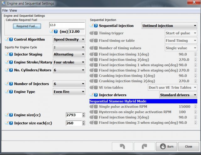

Edit: SVT40 and I were typing at the same time. Your Req-Fuel is double what it should be when your Tune is opened. . It shows as 24ms which is wrong for even a default TS setup. Set injector staging to " Alternating " and 2 squirts. Then recalculate Req_Fuel. both top and bottom figures should come out to 12.0 ms. Then recalculate your VE table using factory figures for stock HP and Torque. That will be a base starting point. If you are using the stock dropping resistors ( injectors ) you should not have PW Current Limiting enabled. ( Which it is currently ) Your Accel enrichment tables are also messed up badly. What your Req_Fuel should look like. BTW, Stock injectors are 260cc not 300. -

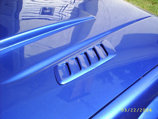

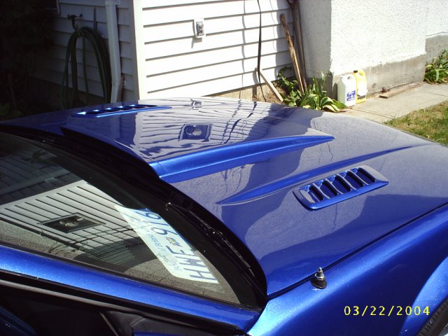

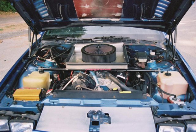

More cooling tweaks. Camaro has an open area between nose of car and rad support. Air could bypass Rad. Sides of Rad where already " Boxed in from factory and bottom edge has a scoop to direct air upwards from under car. But they left the top wide open. Dumb. Sealing this area with an aluminium top plate forces all the air to pass through the Rad. The Carb Air Box was sealed to the hood with a functional cowl vent, and yes it worked very well. -
