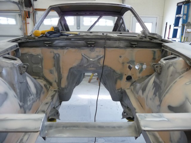

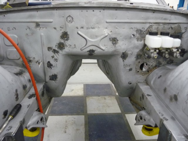

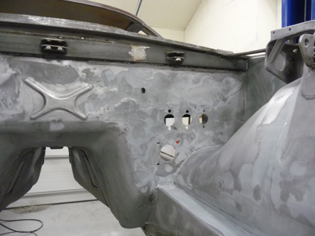

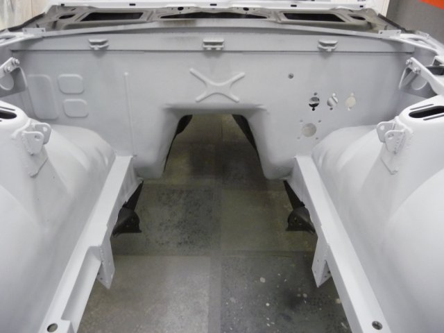

Are body fillers OK to smooth parts of the engine bay?
Litman replied to KnightoftheRound's topic in Body Kits & Paint
I certainly hope so. I have done this and am currently in the high build primer sanding phase. I have no practical experience as to whether or not it will crack however various forms of fillers are used on a very regular basis. Based on advice from my local auto paint supply shop I can tell you the approach I have taken. I too used backing fill plates in some locations and flush welded plates in others. Flush is always better but backside works too. For those areas that had a backside plate, and any other moderately deep defect, I used a fiberglass filled compound such as Pro-Glas. It has a lot more strength and should better resist cracking. After lots of sanding this was followed by the standard filler such as Feather Rite. After copious hours of sanding it was catalyzed sealer followed by high build primer and, you guessed it, a lot more sanding. Depending on the level of perfection you want in the engine bay be prepared for a lot of filling and smoothing. The pictures below so my progression. -

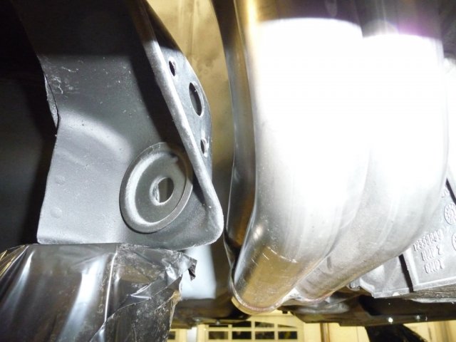

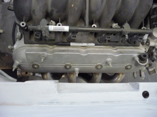

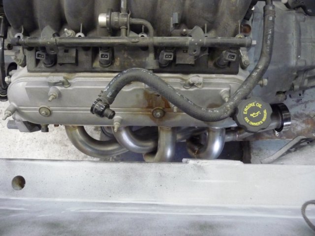

For how tight the fit is I offer these pictures. I can't provide any advice on installation as my situation is unique. The car is using my custom made Corvette C5 motor mount approach and is still in the primered shell phase. I am able to insert the motor from the bottom with the driver's side header installed then drop the passenger side header in from the top. It is a tight fit though. Currently my driver's side collector hits the underbody. The driver's side is also VERY close to the tension rod bucket. I am a little concerned about motor movement under torque causing impact. The other unknown is how much closer these tolerances become upon thermal expansion. All this being said I absolutely love them. -

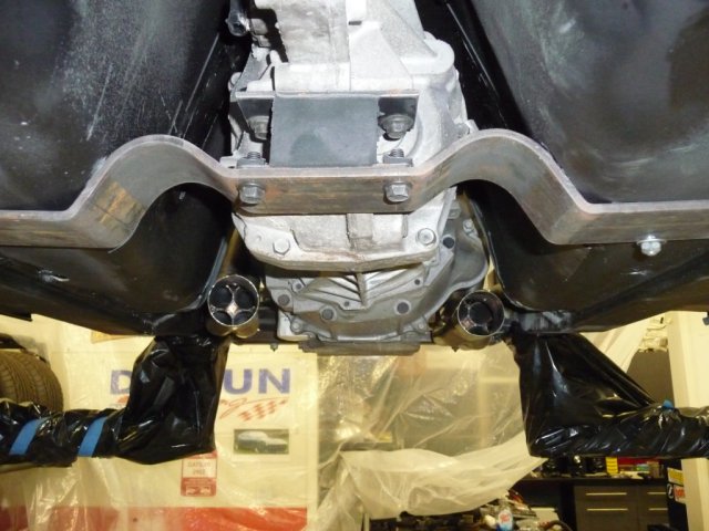

LSX Long tube exhaust options & plans
Litman replied to 1 tuff z's topic in Gen III & IV Chevy V8Z Tech Board

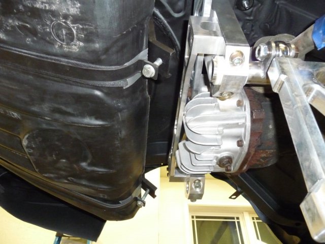

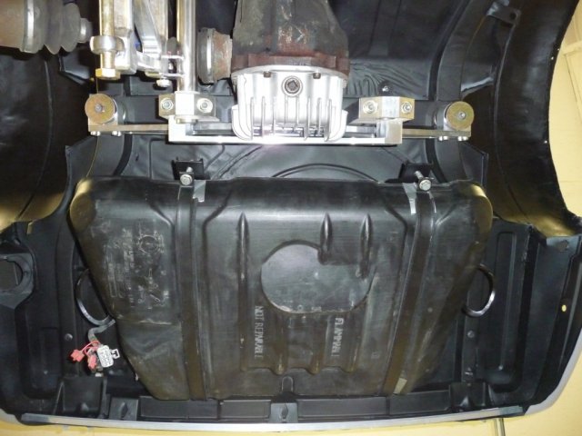

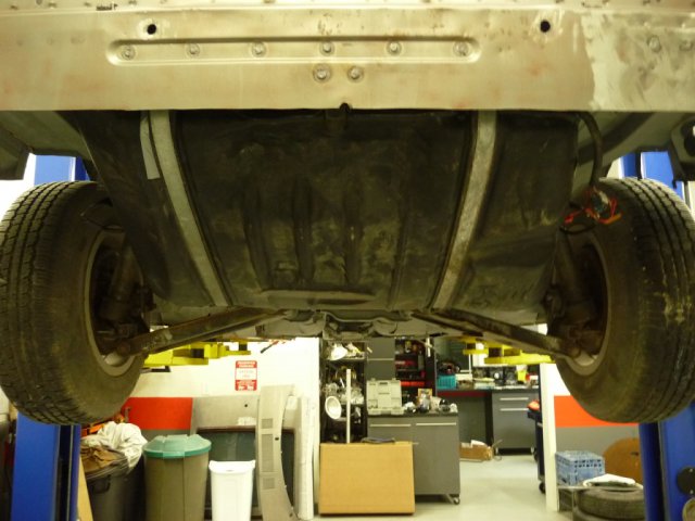

Clive, Attached are some images for you to use in your planning. As you can see I have the AZC stuff in place with the R200 diff. Looks like you could inch the tank a little bit closer to the diff but it still might not provide enough room behind to tuck pipes and a 90deg bend for center outlet. My hatch area (topside) is still basically complete so you can't see much from that side apart from the cute little trap door I made. -

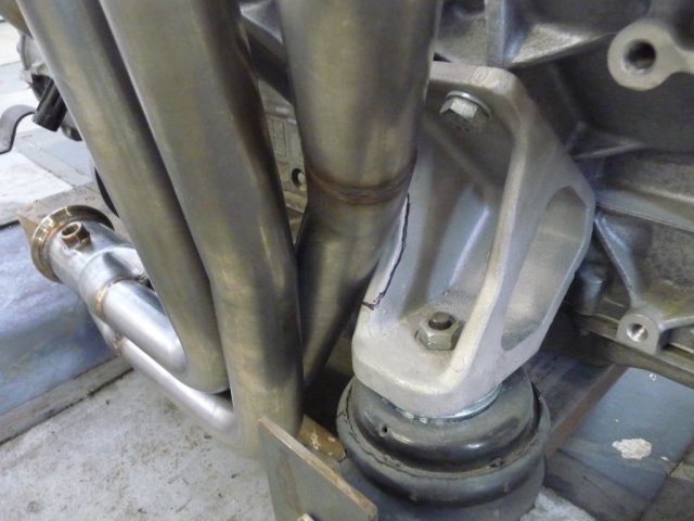

Managed to reduce my nerves a bit today. David was kind enough to tote his LT headers along en route to my area and pass them off so I could do a test fit. Mine have yet to arrive so this at least gives me an indication if I would have to plan on selling mine upon arrival. Good news is they fit with my C5 Corvette motor mount approach. There is a small amount of the passenger side mount that will need to be gound away but this little bit of material doesn't concern me too much. The other thing I wanted to see was if it would be possible to insert the motor from the bottom with headers attached. That's a no go but I will be able to do this with one side mounted and do the other one once the motor is in place. All in all I am pleased and relieved. Now I just need mine to get here. -

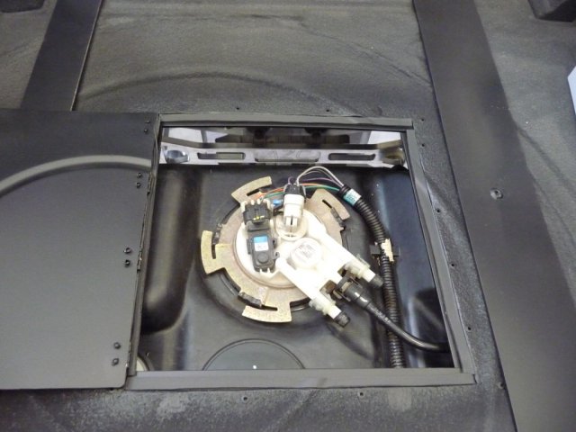

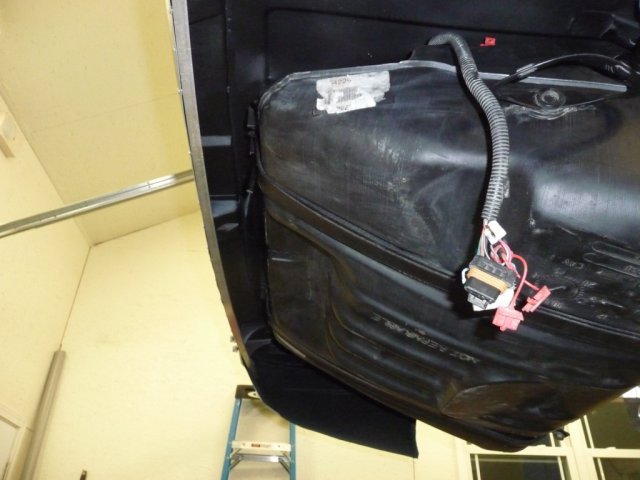

Clive, I think it will be difficult to position the F-body fuel tank to allow center exhaust. Wish you had asked this question last week. You could have stopped by to try it on my car. The attached picture may not show much but I can mount the tank and take more images from your requested angles. I have the tank fipped 180 degrees to put the fat end near the diff and and the fuel fill on the correct side. -

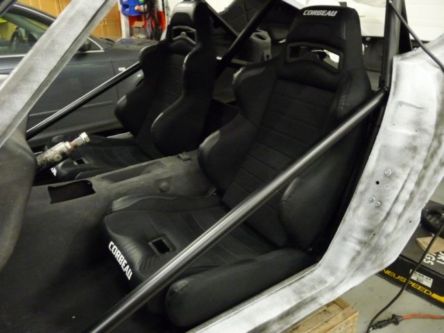

Ok guys, this is what I found: - Distance from the seat surface to the roof = 38". This was taken right where your keister would be but without compressing the seat. Also note I have no headliner at this point so that might offset anything you get from compressing the seat with your weight. - Clearance (total of both sides) at the front thigh bolsters = 2 1/2" - Clearance (again total) at the recline mechanism = 1 3/4". Note that my seats are switched side to side causing the recline lever to be inboard for each seat. This needed to be done to gain a little more rearward travel given the interference with the roll bar lower mount points. - This was at a distance of 28 1/4" front of seat to firewall just below the steering column The height of the seat mounts are 1 3/4" front (versus 3 3/4" stock) and 1/8" in the rear (versus 2 3/4" stock) I can't comment on clearance to the door panel as my doors haven't been on the car for over a year. The diagonal door bars pictured in my original response are well inside the inner line of the door and clear the seats ok. In response to your other question I am using the Corbeau 5-point harnesses. This car will see some HPDE events so I went the harness route. One thing I noted with these specific Corbeau seats is the low harness pass through. It is fine for me as I have a somewhat short upper body. At your height I might be concerned about the angle of the harnesses over your shoulders. Hope this information is useful. Cheers, Craig
Surpip & Boyracer, Sorry for the lack of response. I was in Daytona doing Rolex Grand Am testing. Once I return home this evening I will take additional pictures and measure distances from seat surface to roof, left & right side clearance, seat bottom height from floor pan and distance from firewall. Hopefully with these measures and additional images you will get a good basis for your direction. If there are any other measurements or specific angles for images you would like please let me know. Cheers, Craig
I have the standard LG1 seats with Corbeau Z sliders in my project car. It is a 240Z so take this information for what it is worth. I found the seats to be very comfortable although all I have done thus far is test fitting and periodic sitting. The standard width is perfect for me (5' 10", 175). There isn't a lot of side to side room so it might be a little bit of a concern with the wide seat. For me this was exacerbated by the fact that I removed the OE seat mounts and fabricated mounts that are almost 2" lower. I personally felt the thickness of the LG1 seat bottom caused me to sit far too high in the car. At 6' 2" this may be another issue for consideration by you.
