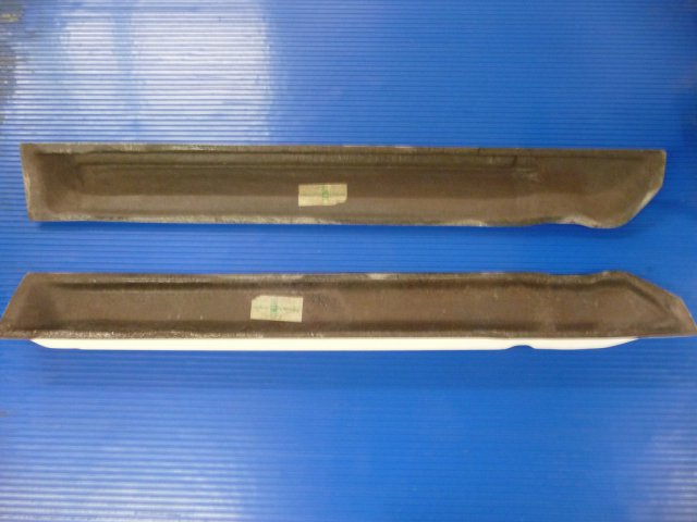

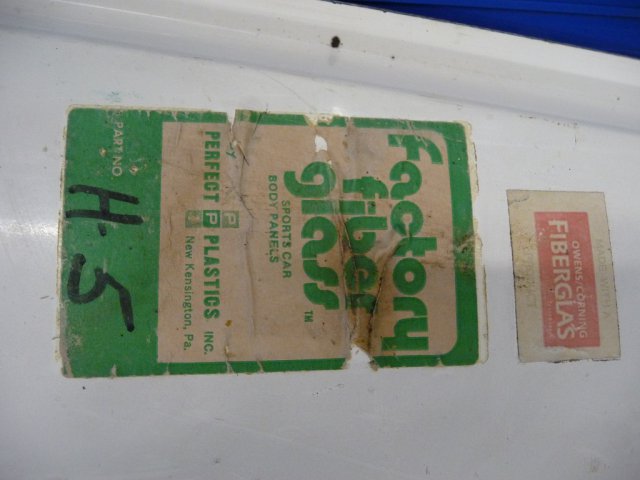

If you haven't already found what you need I have a pair of unused fiberglass rockers. They came from the previous owner of my '71. I have no clue as to what their age is but they are unused and undamaged. Let me know if these rockers would be of interest.

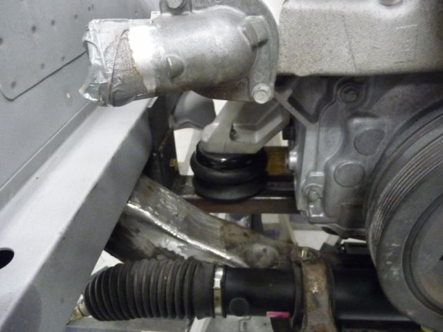

I fabricated a cross brace and brackets to facilitate using C5 Corvette motor mounts. I am keeping the accessories which the JCI mounts don't play friendly with. I know the mounts are equidistant from the frame rails therefore I suspect my motor is dead center. When you indicate GTO biscuit mounts is this what you mean? If so I can provide motor mount measurements with respect to the frame rails. -

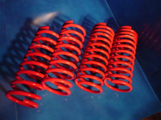

I have a set of Tokico 5020 springs new in box. They are part of a strut spring combo I obtained. Using the struts on my car but do not need the springs. $175 plus shipping.

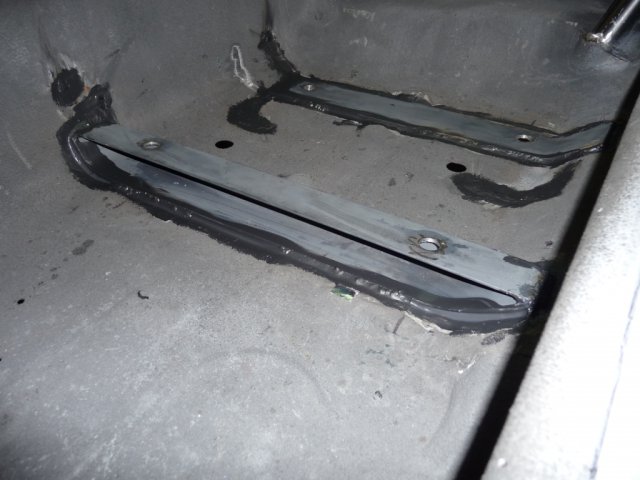

A simple solution, and one I did for our LeMons car, is to spot weld 2" or 3" flat stock on the floor running from rocker to tunnel for both front and back seat rail bolts. Mirror these pieces with flat stock on the underside of the car essentially sandwiching the floor pan between. This will position the seat bottom parallel to the floor pan. Unless you have race seat side brackets with multiple mounting holes you may need to use something like channel for the front mounts to replicate the factory reclined position. Images of this approach in my '71.

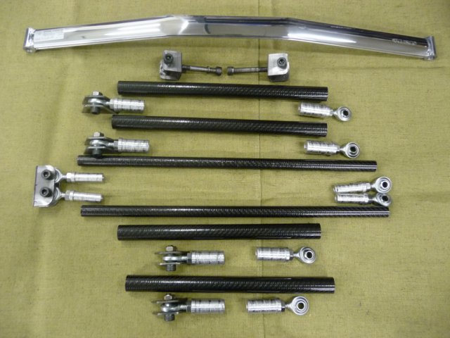

If you are using your car aggressively (Auto-X, HPDE, etc) anything you can do to stiffen these noodles we call Z cars is a good idea. I have no empirical data to confirm my design works however it makes sense geometrically. -

I researched for and purchased two diamters of carbon fiber tubing in 6' lengths and matched these with two lengths of 6061 aluminum rod. The aluminum rod OD is almost identical to the CF tubing OD. Lastly I bought matching pairs of left hand and right hand threaded heim joints. After figuring out the triangulation I wanted in the engine bay I measured the lengths necessary and cut the CF tubing. The aluminum rod was cut into 3" lengths, two for each tube. The aforementioned machine shop turned the aluminum end pieces to the ID of the tubing, leaving a little at end to form a lip/stop. He also center drilled and tapped the end pieces so the heim joints would thread in. In addition I had him cut a little relief into the end pieces to allow a little extra epoxy to help bond the aluminum to the CF. I am pretty pleased with the results. -

There may be off the shelf tabs available but I am not aware of them. I put a lot of thought into the method of connecting everything and needed a lot of unique bits to pull it off. I made templates which were converted into metal tabs & brackets by a local machine shop. -
