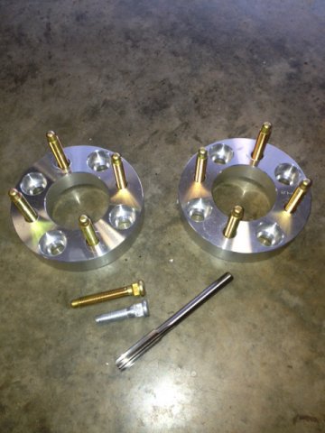

Job is finished. I used extended ARP studs for an EVO and the reamer that was recommended. I started by using the recommended drill bit, but the hole I was expanding was close enough to what I needed, that I actually got cleaner holes just by using the reamer and skipping the re-drilling. Pressed in the studs using my press. Turned out pretty well. Only potential issue I see is durability. Comparing the short studs that came in the spacers to the ARPs that I replaced with: The original studs have longer, more coarse knurls than the ARPs. Perhaps there is a special spec for the knurls planned to be pressed into aluminum vs those planned to be pressed into steel? Anyway, the job is done. Interestingly, with the longer studs that I put in my billet stub axle flanges, it is possible for me to use all 8 studs when mounting the dual-pattern draglites. So, I ordered extra lug nuts and will be using all 8 studs on each side to secure the wheels. Draglites have a problem with loosing up and I have to re-torque several times during a race day. One of the used draglites I just bought appears to have loosened on the previous owner and banged around on the mounting flange some. Retorque-ing regularly is part of the racing game.
