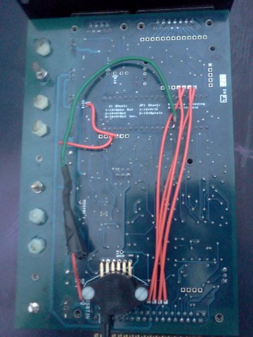

  11. Running ms 2 v 3.57 on 1983 280zx L28E. It has the stock vr distributor with a single coil. Has low impedance 440cc injectors (2.0 ohms each). All ms grounds to the battery negative, sensors ground to the intake manifold. I have a toggle switch to the battery to power ms. Everything is fused and relayed. I'm not having much problem anymore with the box getting hot and the engine misfiring that I've noticed. The main problem I'm concerned with now is ms isn't following the spark table. IGN is soldered to pin 7 of the 40 pin dip socket to a 330 ohm resistor to the bip373. Thanks 2012-12-22_14.52.45.zip amanda 2012-09-06_19.13.10.zip

  14. Static electricity could be the cause. Is the box mounted near any speakers? Not sure if the magnet could cause your problem.
