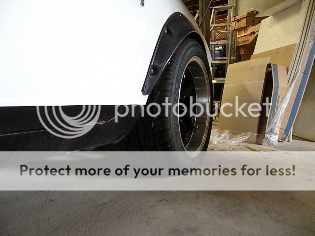

AllBoost Posted July 15, 2011 Share Posted July 15, 2011 i recently picked up a 1974 datsun 260z from a member on this forums. i have been wanting to build a real all out drift car now for the past 2 years and i wanted to do something different than the rest of the crowd but still drive and perform well. so heres what i got. http://i463.photobucket.com/albums/qq358/AllBoost12/052.jpg[/img The car is immaculate with no rust. it has coilovers on it already but i have no idea what type the are. the dont seem to have been worked on at all so they might be arizona zcar coils but i need to get some better pictures for you guys to take a look.for power i plan to use a ls motor with some goodies. get it around a solid 375-425 wheel horsepower. car has a 5 point gforce harness along with corbeau racing seats. i have been reading countless threads about thise drivetrain swap and the only thing i really am worried about is power steering, or the lack there of, and the rear end. ive been thinking a r200 turbo diff would be enough but i feel the the axels would quickly break with the continuous clutch kicks and hydraulic ebrake. any and all information about getting one of these cars to slide cleanly would be greatly appreciated. i am not new to the car world and have plenty of tools and know how. i also own a 2003 dodge neon srt that puts down 423 wheel horsepower on 24 pounds of boost. Quote Link to comment Share on other sites More sharing options...
