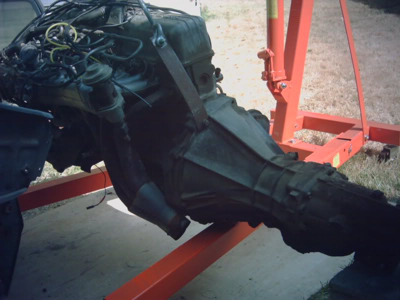

This summer I pulled the tranny and motor together and I hated it. Things were real tight once all the tilting began. I'm just glad my paint was crap then. If I do it again, I'll pull the tranny first then the motor. I used 3/16 inch flat steel and bolted it to the bell housing and made my own load leveler.

You're totally right about picking the engine by itself. Together they are a PITA. The only trouble is, I'm pretty sure you'll have to pull the tranny first. I could be wrong, but I don't think you'll be able to slide the engine forward enough to pull it alone. I think the oil pan would hit the cross member before the clutch clears the tranny. There is some room to pick up on it though so maybe it would work. I'm sure someone else in here has tried it, hopefully they'll chime in on this.
Even if you had to pull the tranny first, then the motor, I still think it's easier. I know what you mean about not having room under there. My car was just on jack stands for 6 months and there wasn't much more I could do for room other than buying a larger floor jack to get it up higher. It sucked, so glad to see it back on the ground.
What do you have as far as jacks and car stands? It's easier to work under it when the car is up high, but the real trouble I ran into pulling my motor and tranny together, is that I bought the smaller 1 1/2 ton cherry picker. I had it tilted enough to clear the fire wall, but my motor ran into the cherry picker arm because it was almost at full tilt to get it all up high enough. It would've been easier if I could've lowered the car back down before I started to pull, but I couldn't because then the tranny tail shaft would've hit my firewall. This could have all been avoided by removing my tranny first. Food for thought.

Sometimes you just have to find out for yourself, but my suggestion is get a jack on the bell housing and since it alredy looks like you have the head off you can use your 90* hoist adapters and find a bolt that fits the block go block, washer, 90*, wacher, bolt on opposite ends of block bolt them down tight. Take out bell housing bolts lift up motor/ tranny, support bellhousing up aginst firewall. If you cant slide the motor out dropping the crossmember is 5 bolts, too easy.
I've pulled a motor and trans together. It should be fairly easy with a load leveler and some patience. I had lots of patience but no load leveler, but it was still doable. It's harder to install together because the tail section is so heavy, tilted to get it back in, that it's hard to get it lifted to bolt the rear mount up.
One other option, if you can't get the car high enough would be to remove the drive shaft and transmission, but leave them under the car. That way you won't have to lift the car high enough to get the transmission out. Actually, you could pull the trans out through the engine bay after the engine is removed. Lift car high enough to drop transmission, leave it underneath, remove the engine, slide transmission forward and pull through engine bay. Reverse procedure for installation.
That seems like the best way to go, didn't think of attaching the leveler directly to the block. I'm thinking that since I have the radiator out I should have enough room in the front and with the head off and the cherry picker at 1 1/2 tons the arm is pretty long so it should have lots of room there and if I can't clear the cross-member then I can try removing the pan. If that doesn't work out then I'll remove the transmission and the engine together.
