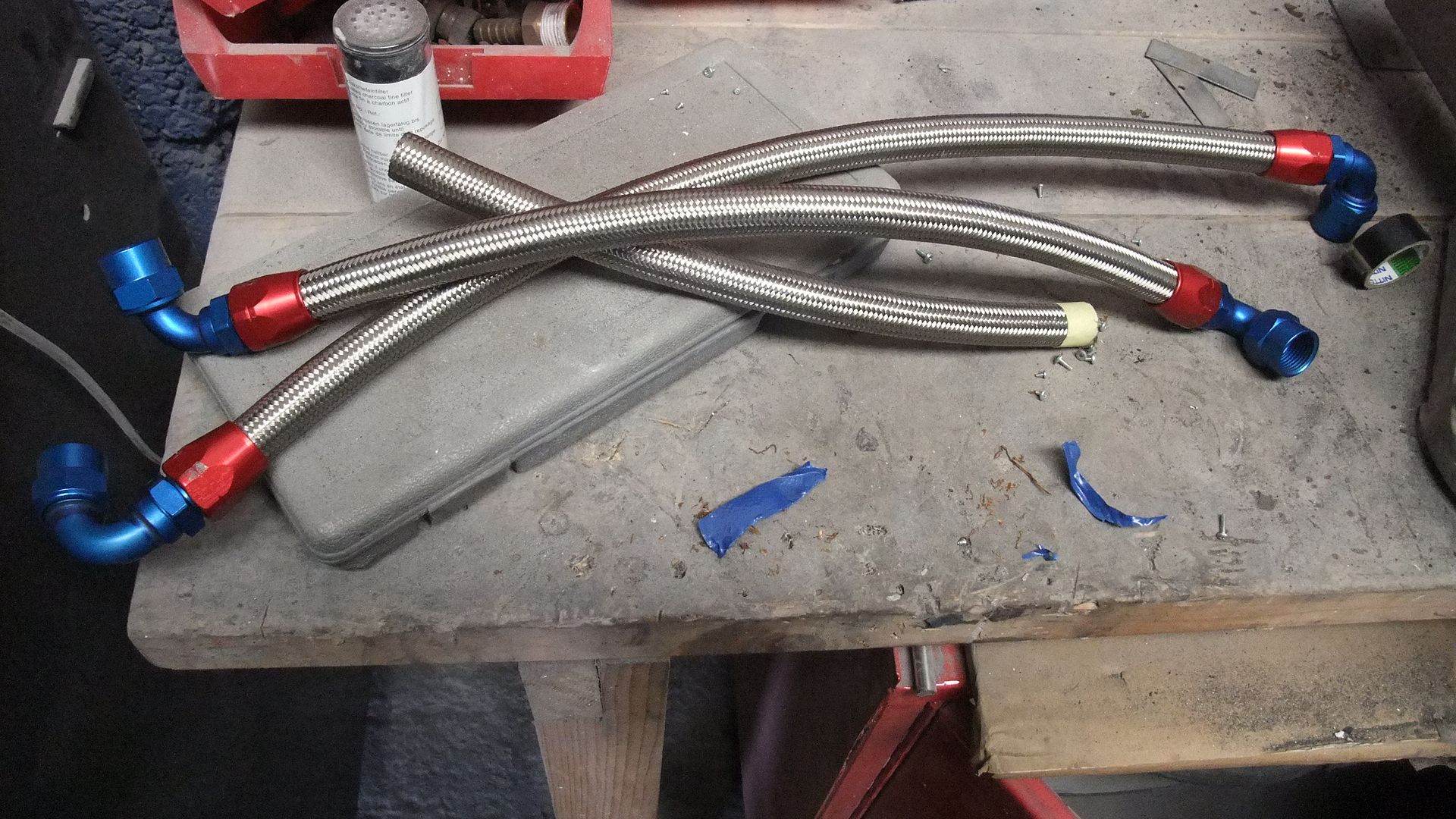

Fuel line setup, hard to believe this lot costs £560.
Fuel lines are done, FPR fitted, intercooler and radiator fitted, throttle cable is fitted, LSD is going in today along with 4.11 final drive, propshaft should be ready tomorrow.

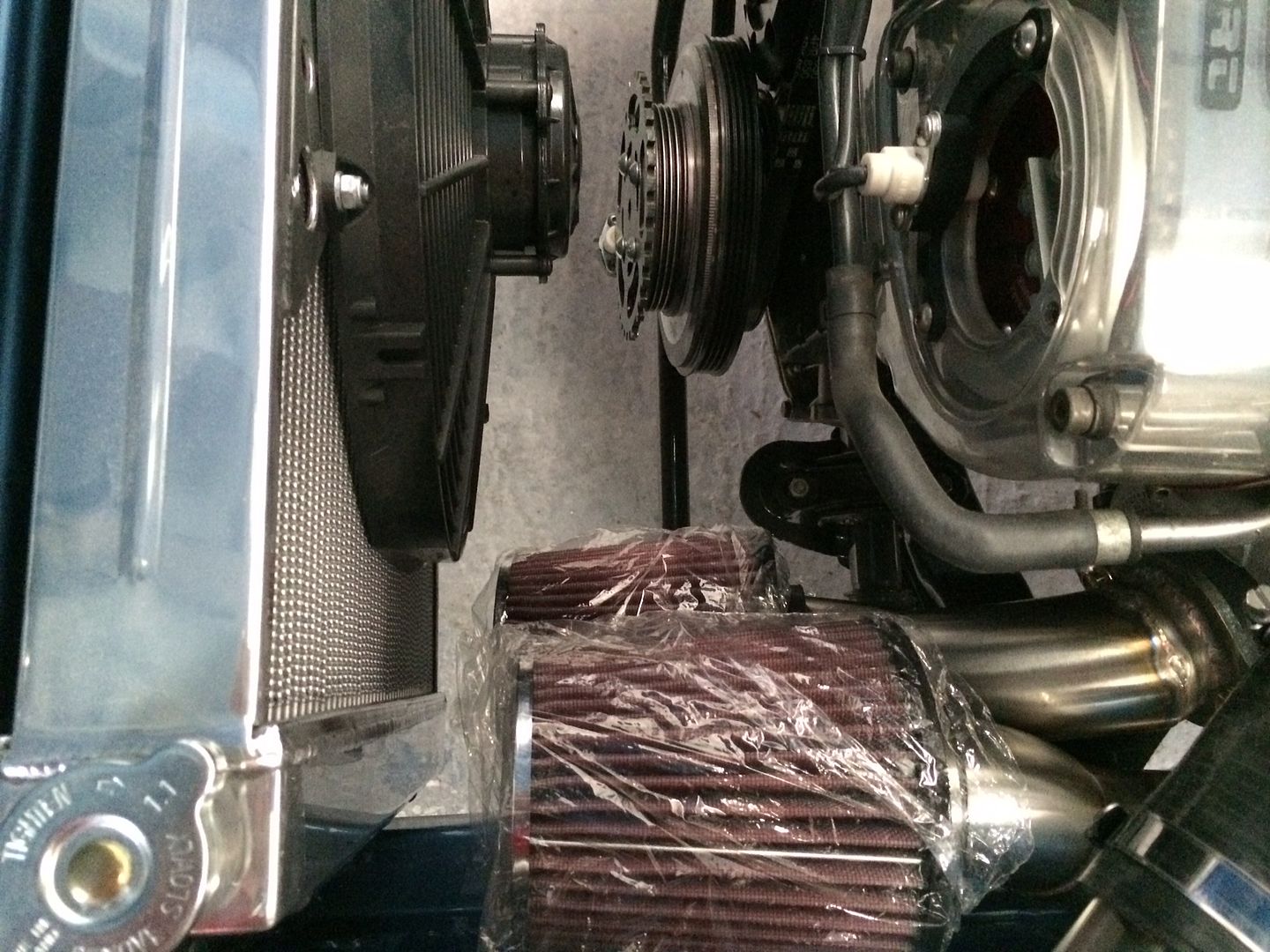

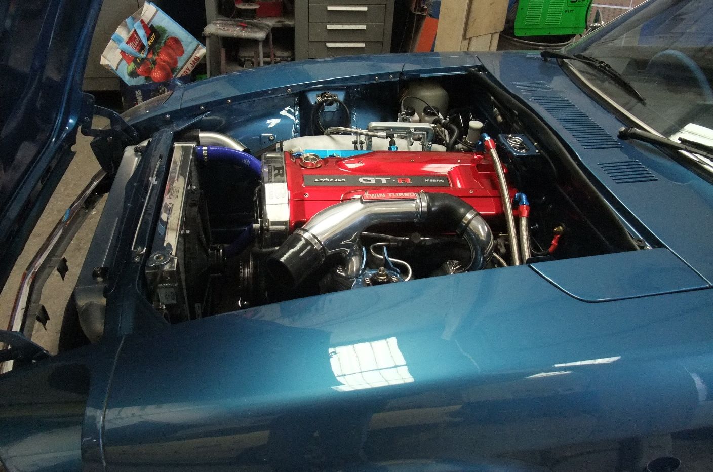

Almost there, got to work out a solution for the top radiator hose, trim my intercooler diffuser panel, fit the sump tray and that's it for the outside apart from intake, intercooler and exhaust piping. Was working on the inside wiring today and fitting my gauges.
Hardlines under the car with braided line up front
Link to comment
  • 2 weeks later...
Got the wiring finished, switches wired in, dash fitted, spacers fitted, interior cleaned, top coolant hose on and filled her with coolant, adjusted the mapping a bit, fitted vac lines and general tidying. Pretty much there now apart from piping (downpipe, exhaust, intercooler) this will be started on Monday.

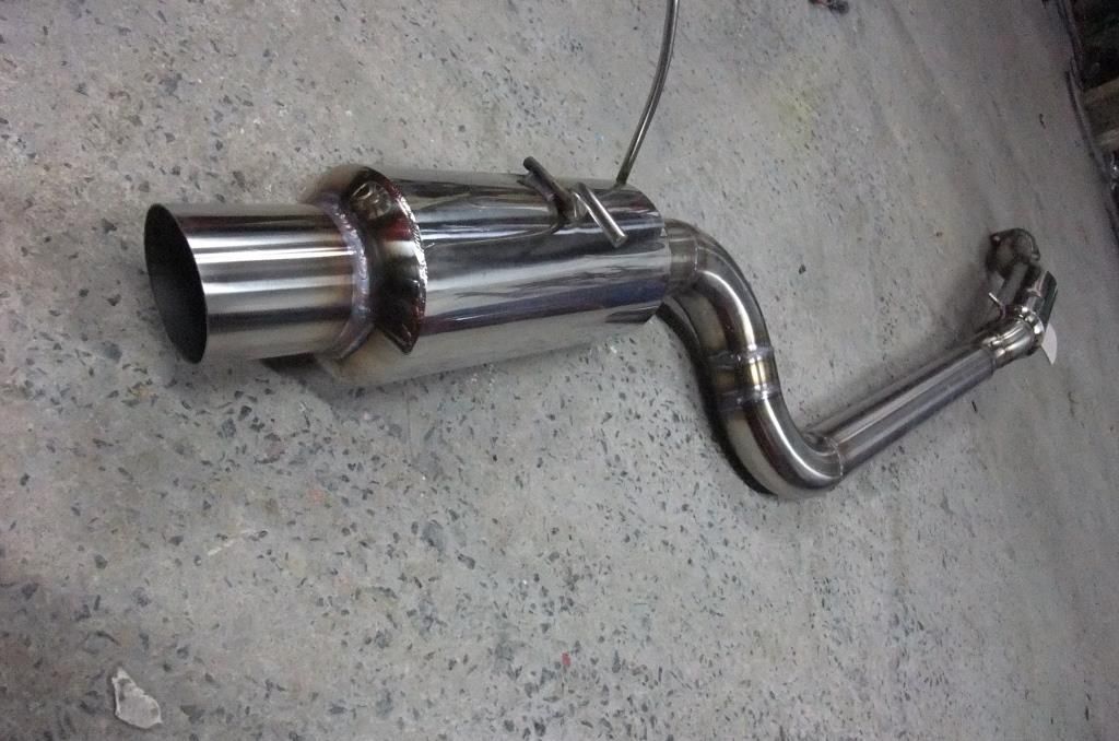

Exhaust is underway although its already well behind schedule:

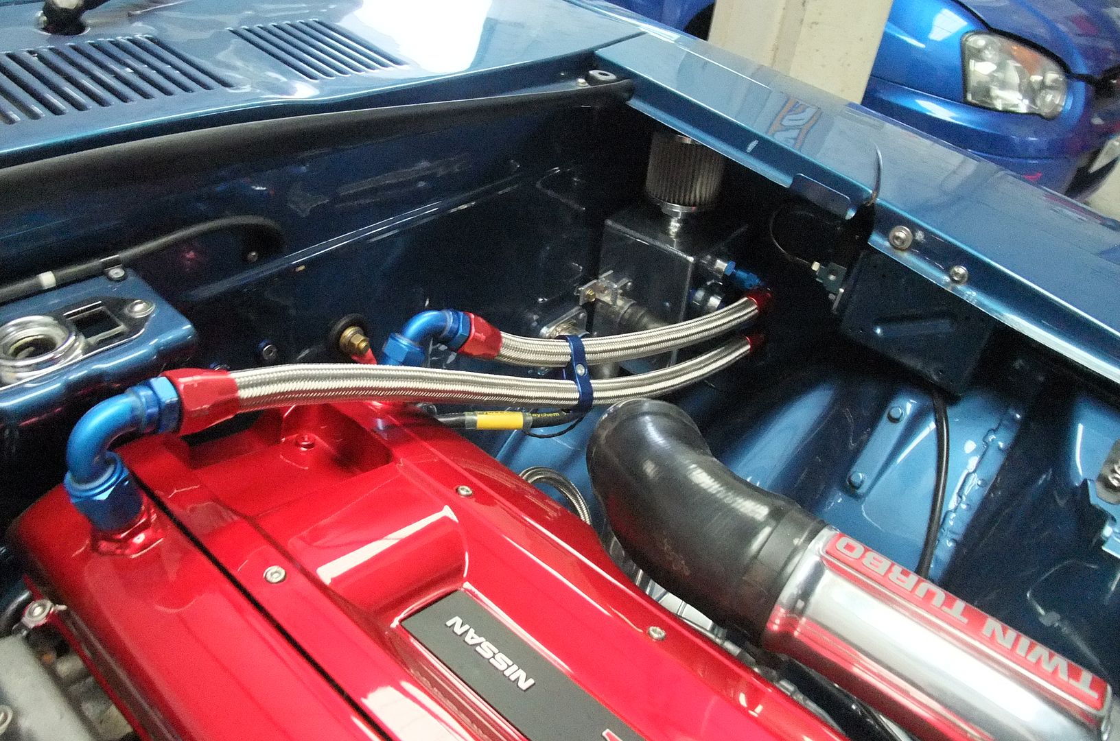

Made up my breather lines and finished the wiring plate install:
Original plan was to hide the wiring connector under the catch can, but the wiring was about 2 inches too short for this, so I machined the plate down to fit where it is below. I think worked out ok, perhaps it would have been a shame to hide it?

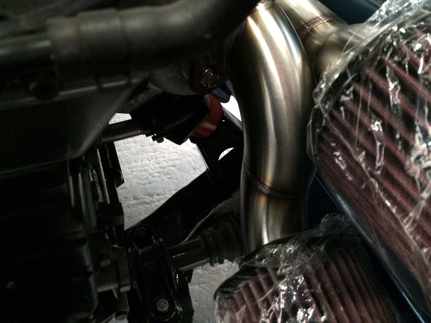

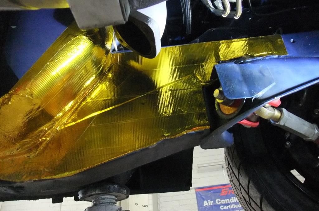

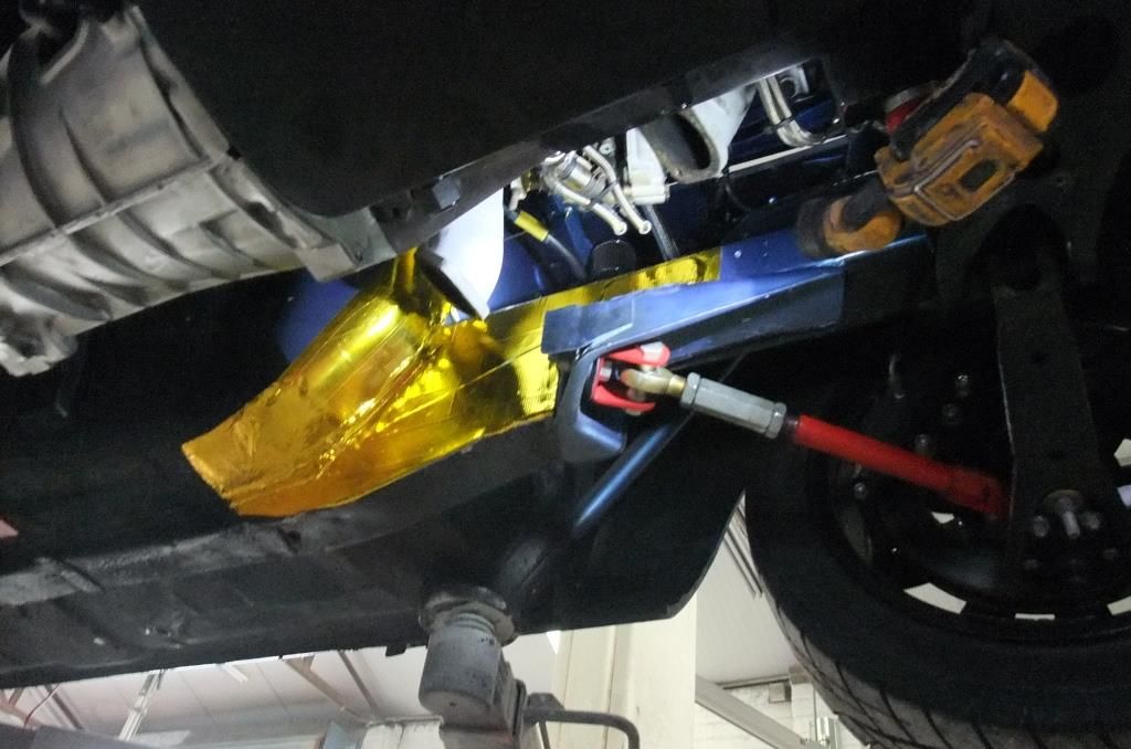

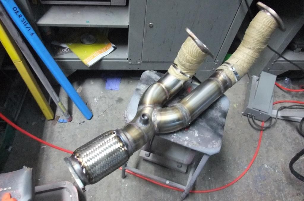

The downpipe runs very close to the chassis so to avoid heat damage I added some insulation, if Gold is good enough for a McLaren F1 engine bay then its good enough for me, meant to reflect 80% of the radiant heat, plus it looks cool
Unfortunately I have run of time to get this finished and I have had to go back to work with it unfinished.   :cry:  I plan to return for a week once the weather get a bit better, perhaps end of Feb and I'll get it finished ready for my next holiday where it will be getting mapped.

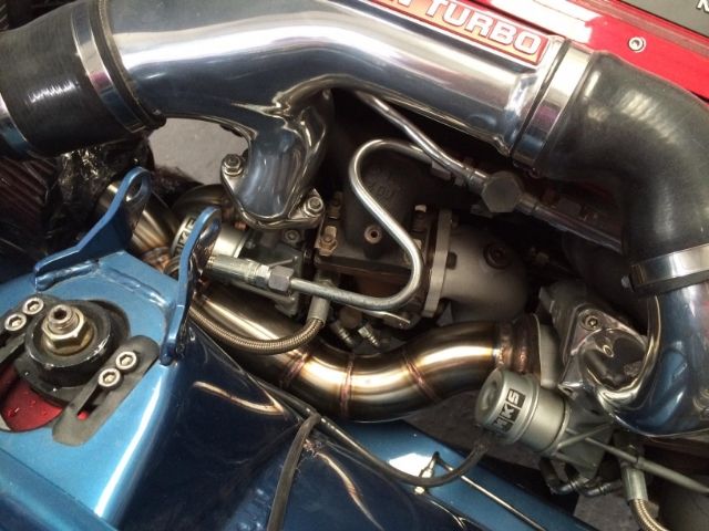

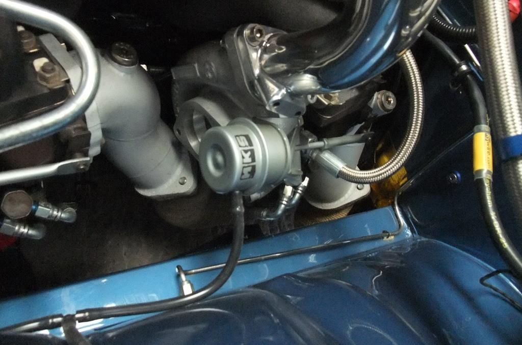

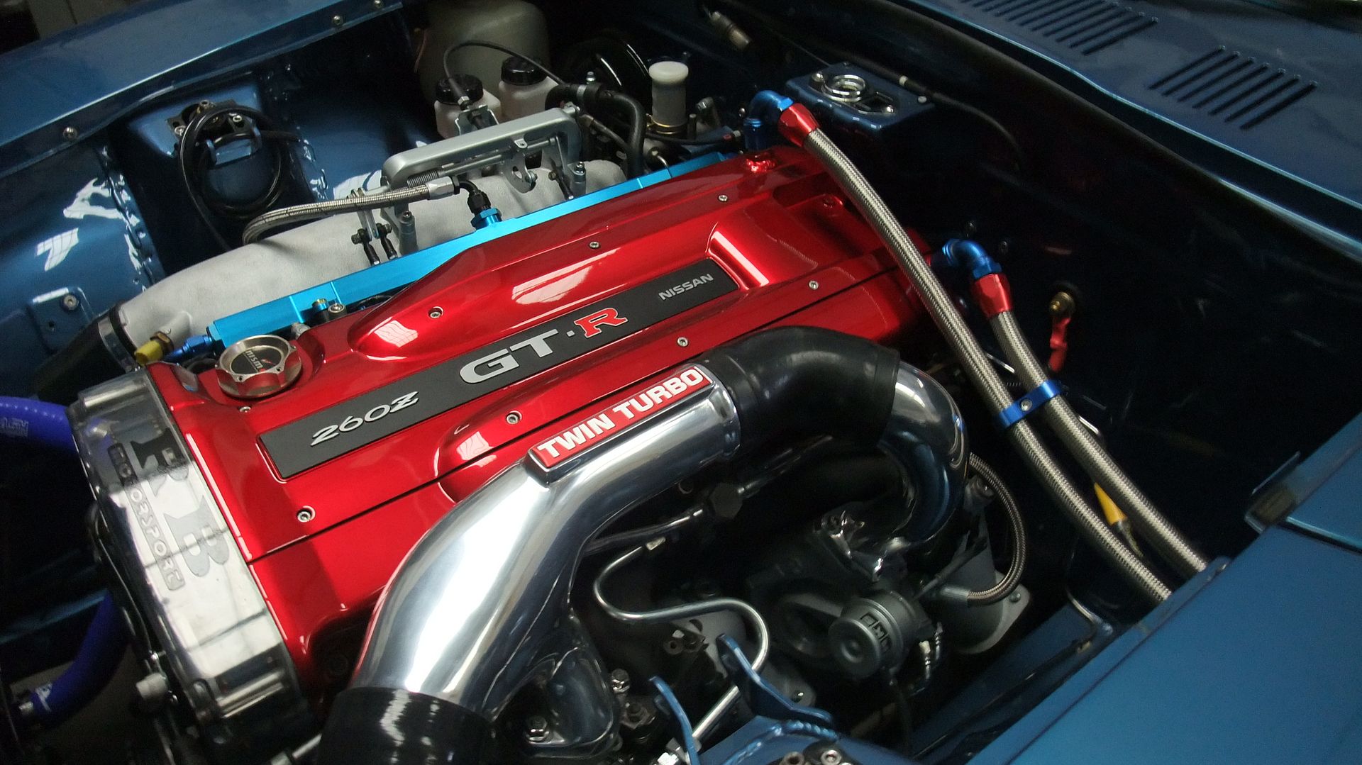

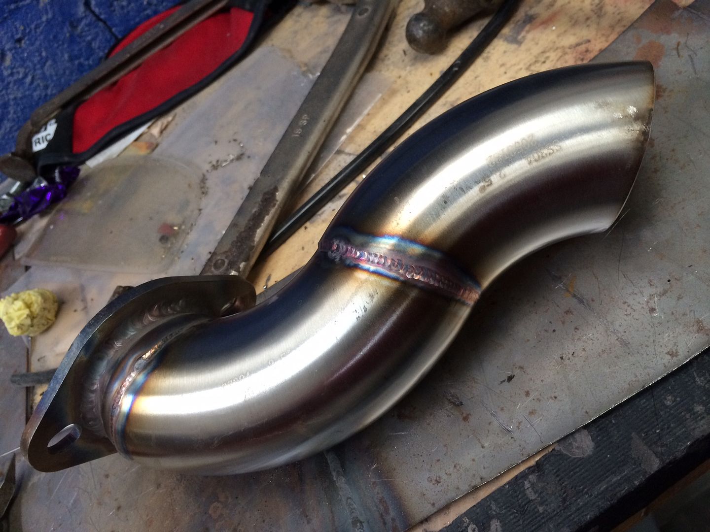

Downpipe finished, wanted equal length for the sound but I just couldn't see a way to make that work on my chassis, I heat wrapped the parts close to the chassis and turbos, would have like to do the whole thing but the problem then is if it scrapes the ground it tars and the whole lot comes off.
You can see the intake piping for the rear turbo has to run above the front turbo elbow and exhaust so to help keep the pipe cooler I am considering gold wrapping the piping also.

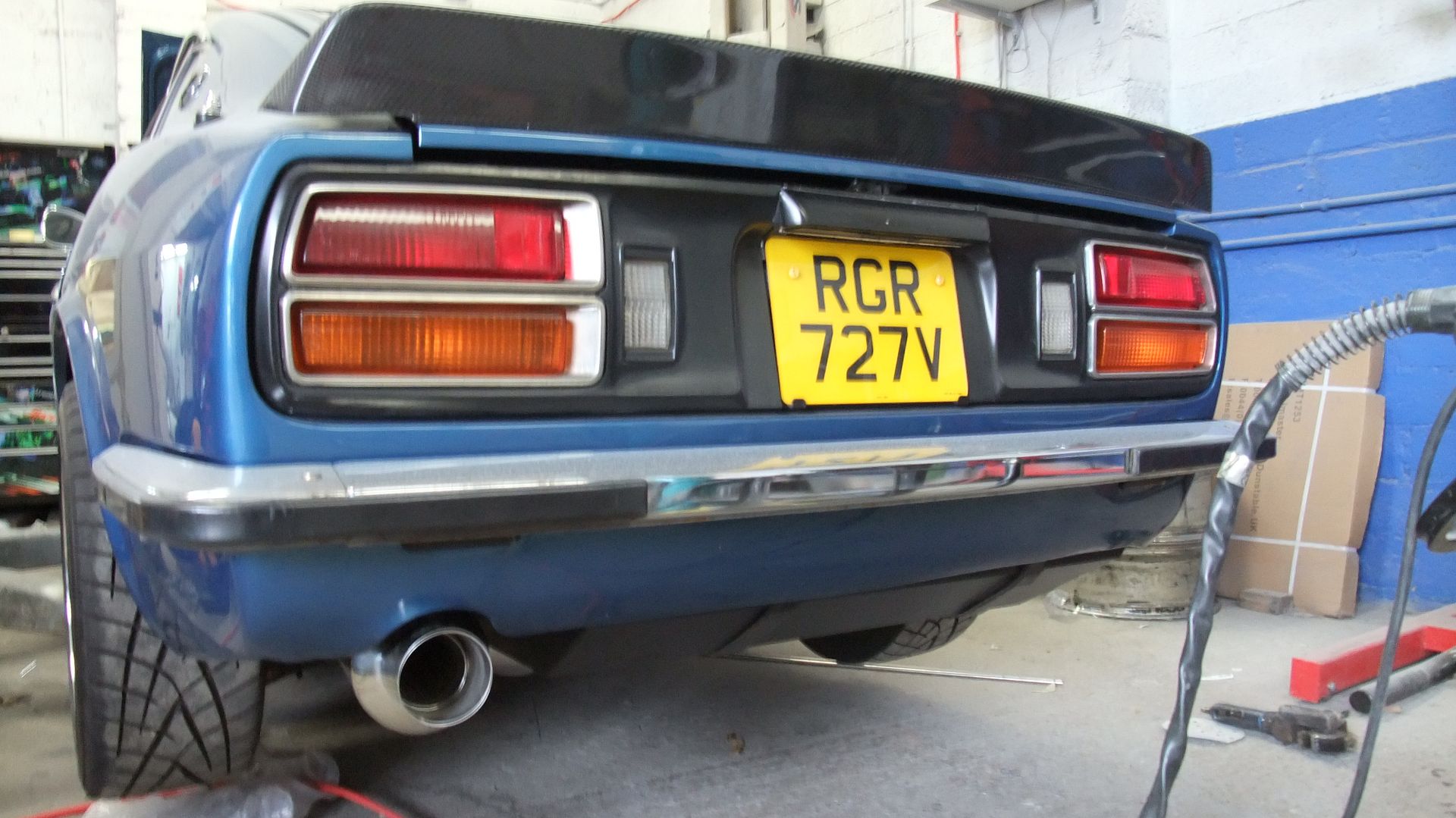

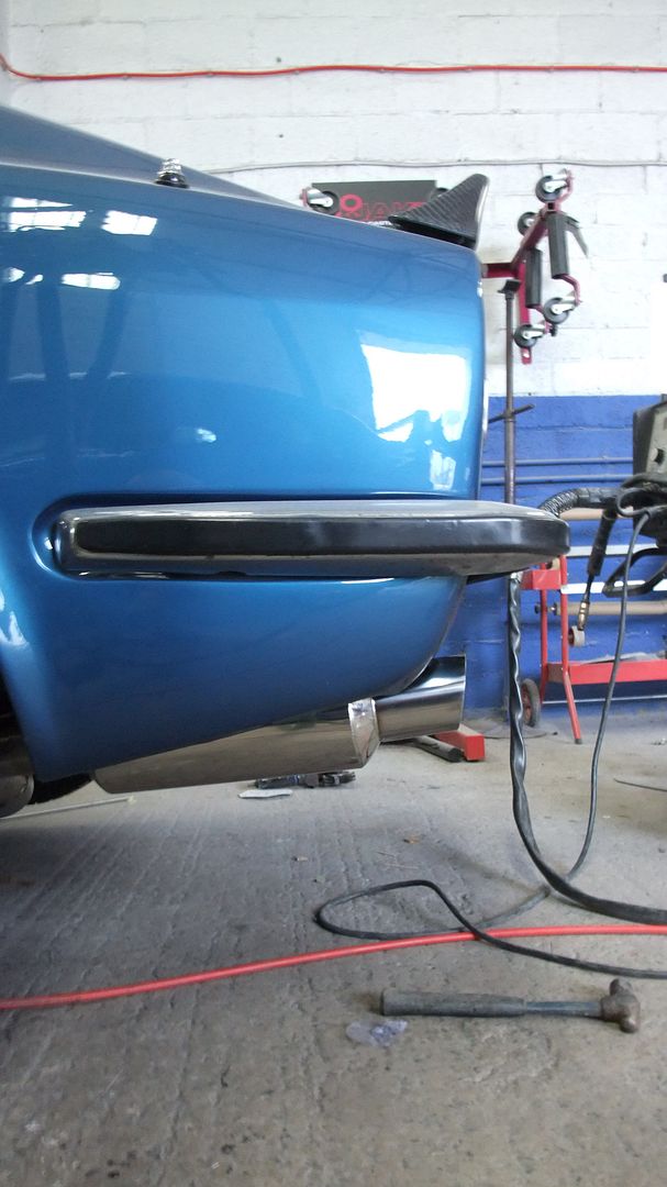

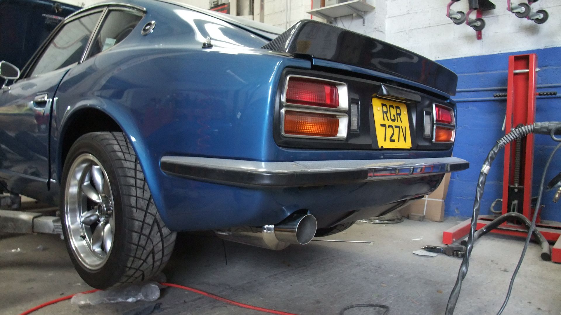

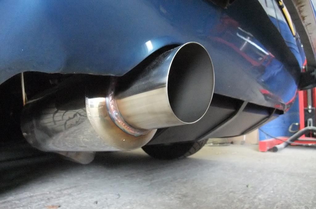

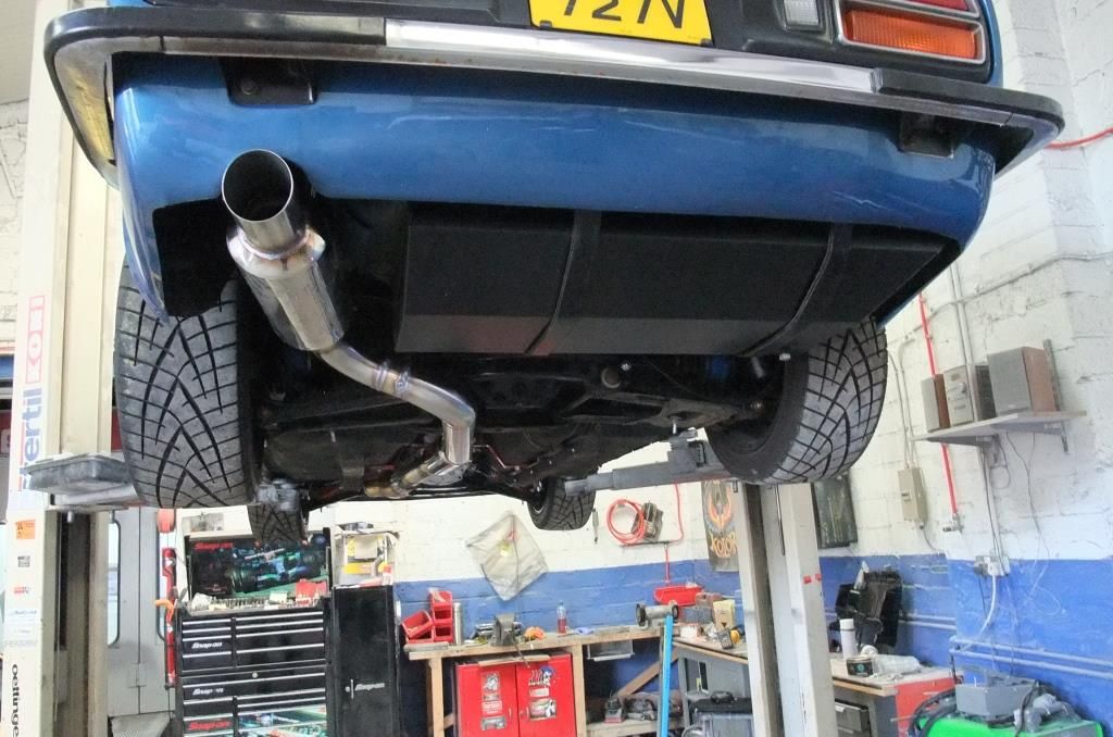

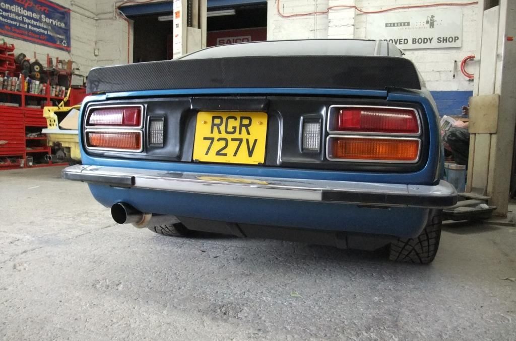

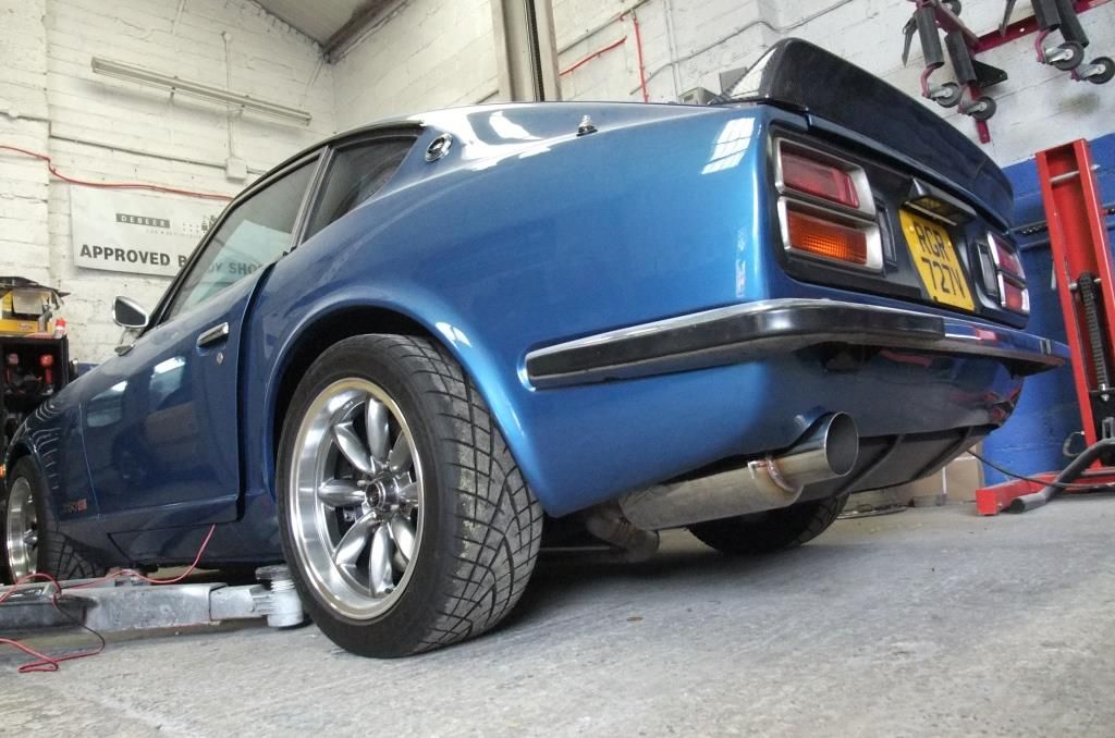

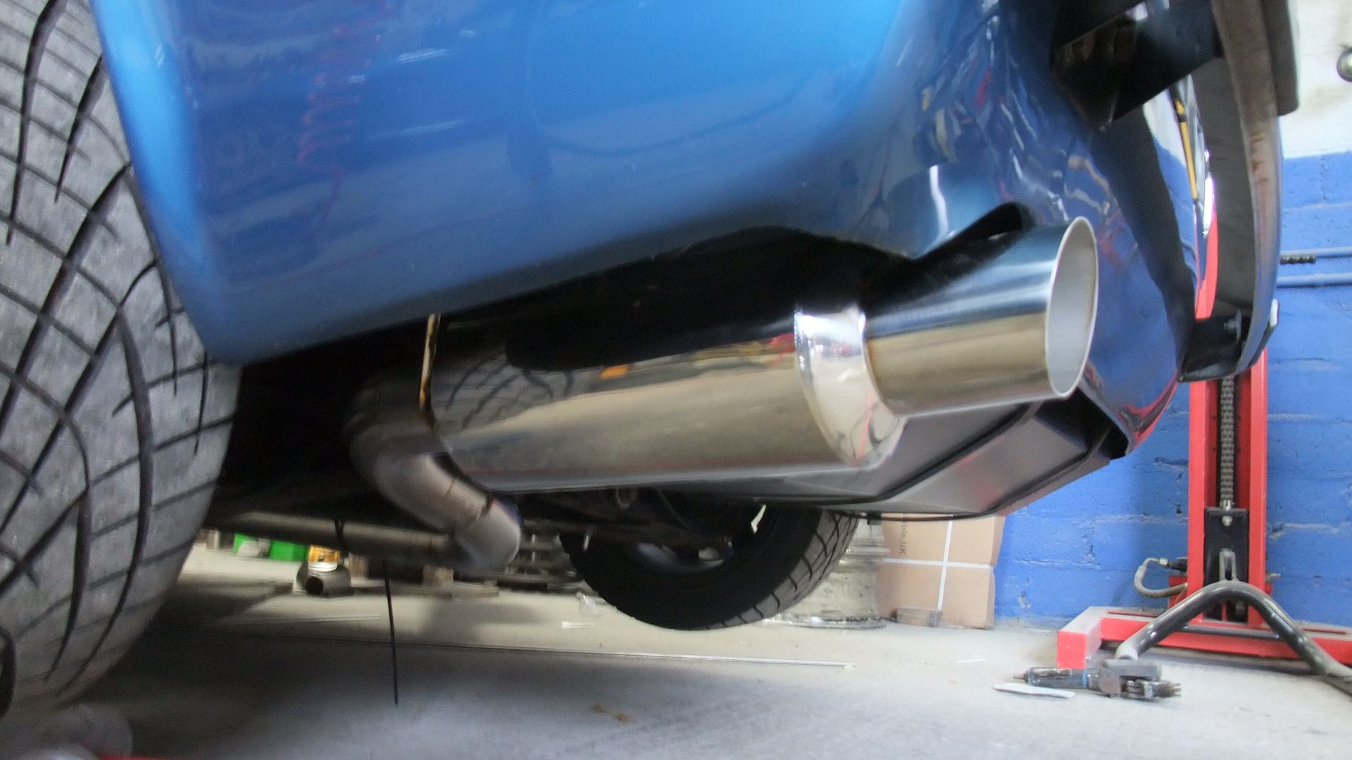

Exhaust is also finished:
Not sure whether to leave the heat colouration on the tip or remove it:
Almost there   :)

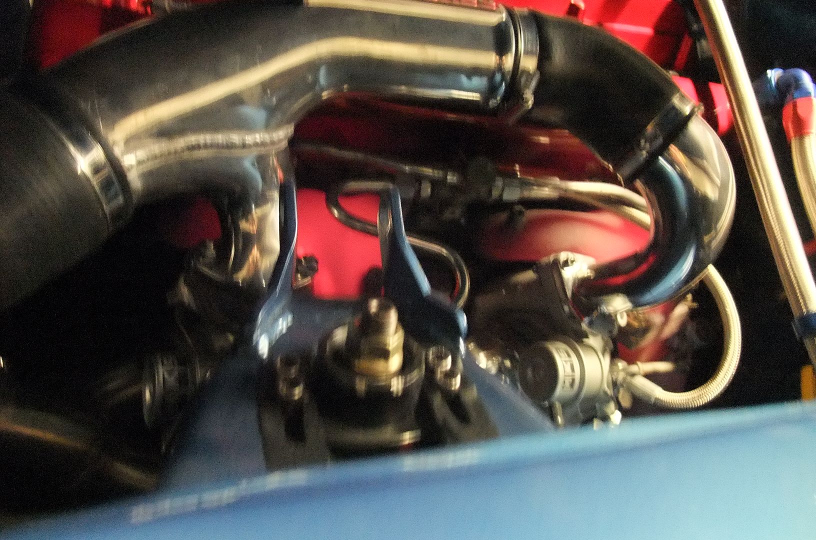

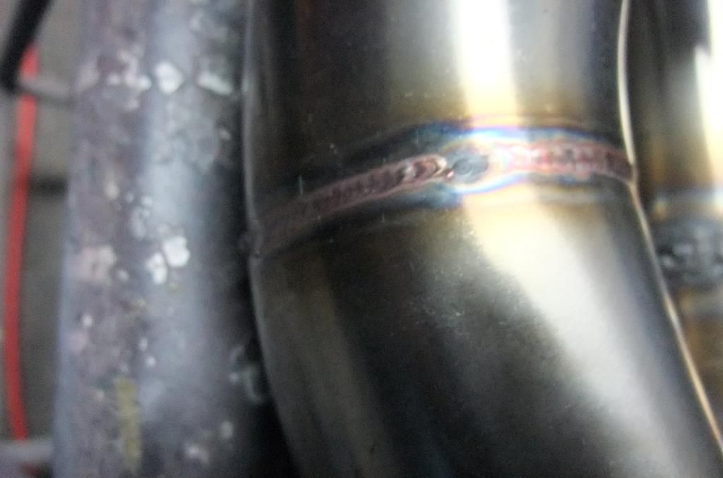

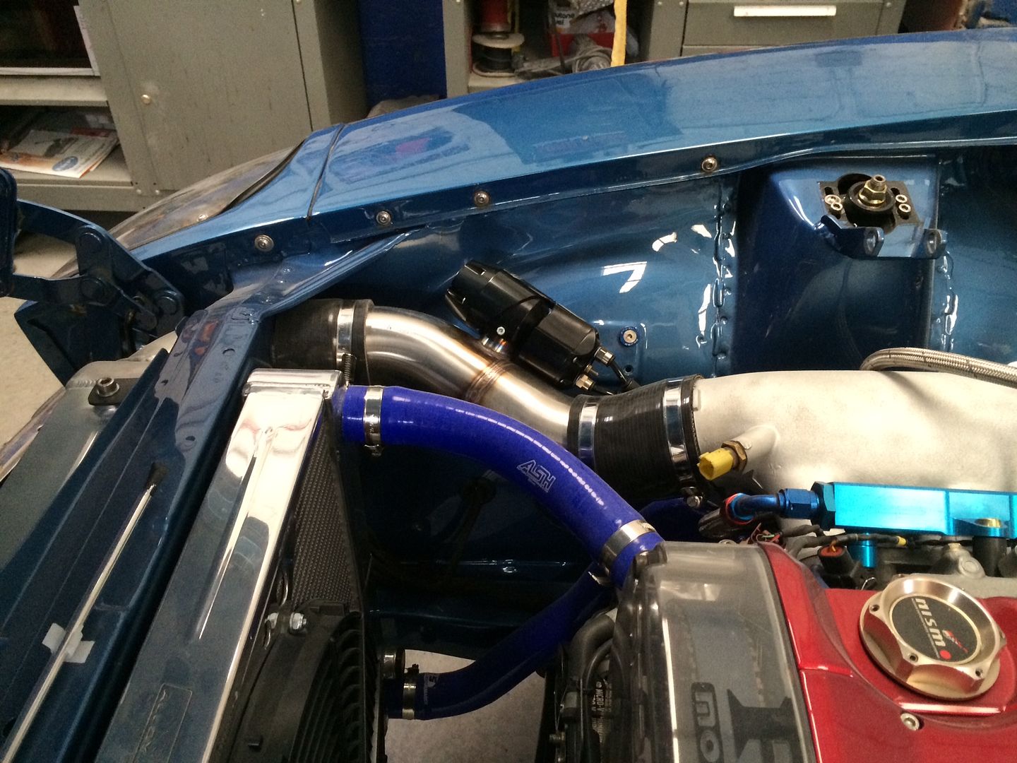

Intake and Intercooler piping is now finished:
Nice Job on the welds:
Bay is a bit dusty, work is being done in a bodyshop.
Was originally planning to have all the pipes polished, but I'm not sure now. I'm thinking I'll leave the intake pipes the way they are but not sure what to do with the intercooler pipes. I can either leave them how they are, have them brushed so they look like they do now but without the colouration from the welding, it will look like one piece of pipe until you look close and see the neat welds. I can have them mirror polished or I can do them in satin black.
One option for the intake piping was to get it ceramic coated silver, would be the same finish as my turbo elbows, while this may be effective I'm not sure its the nicest looking compared to the other options.
Opinions welcome.
Looks a wee bit cluttered down here, but that's really as neat as I can make a twin turbo setup look.
Wanted the bottom filter to be closer to the top one but it just wasn't possible.

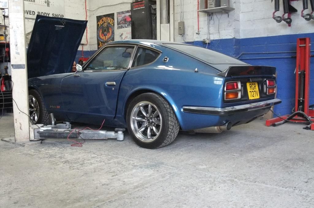

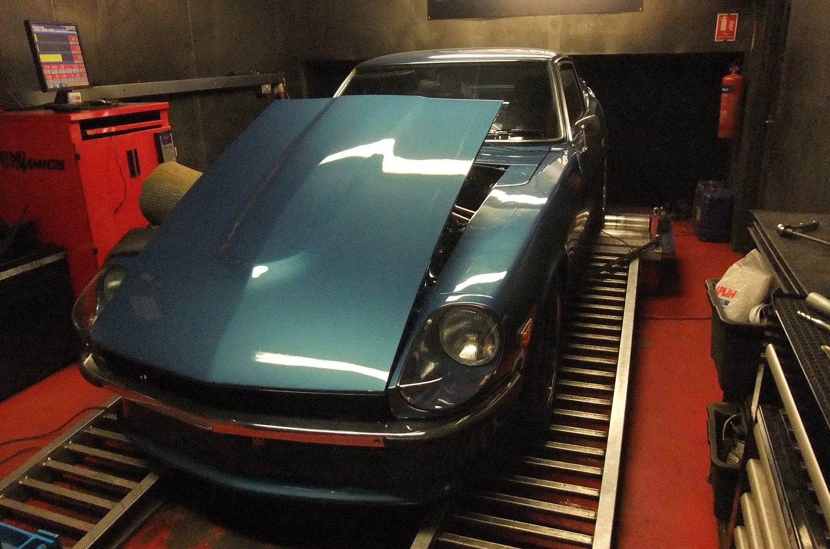

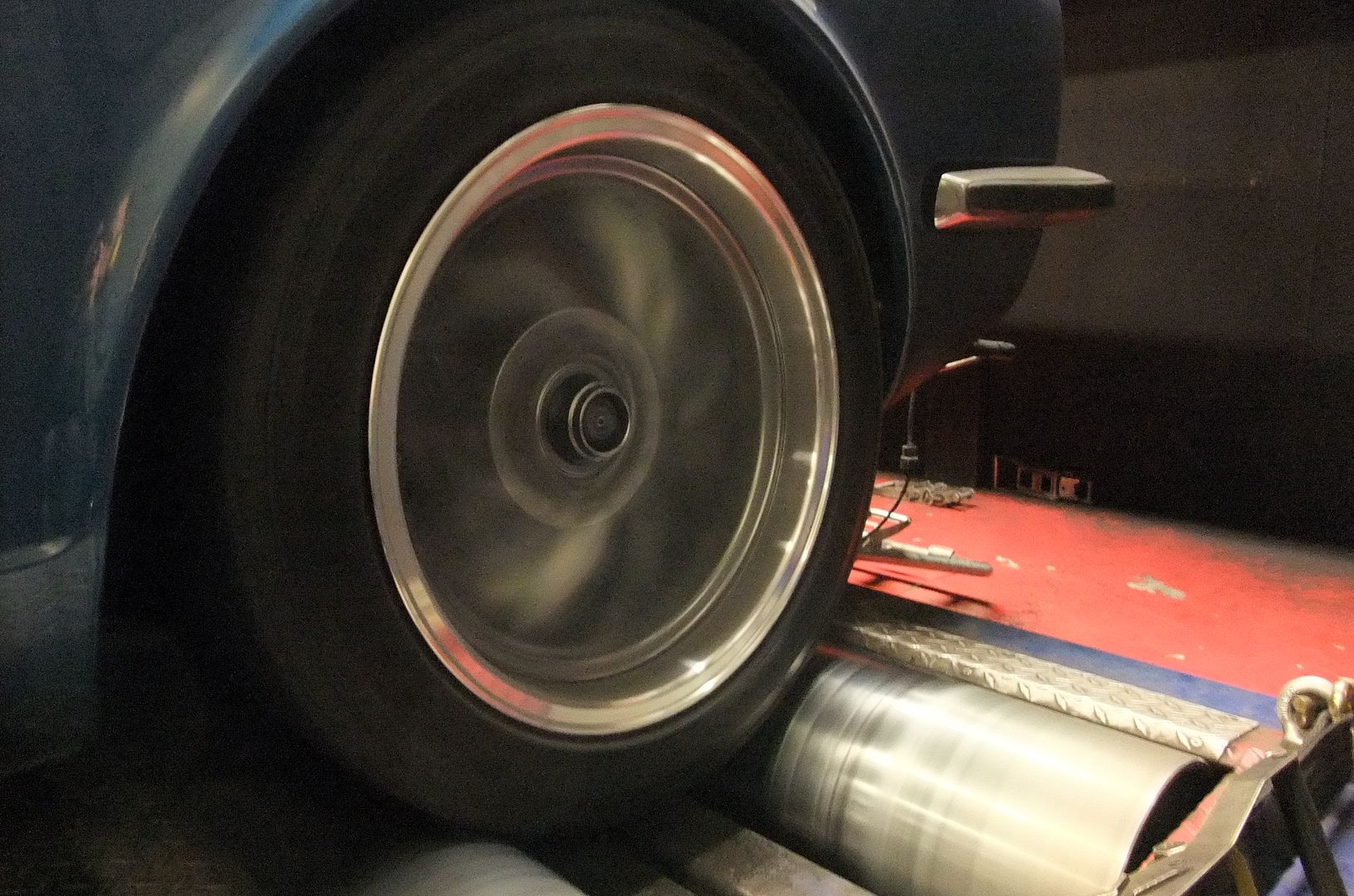

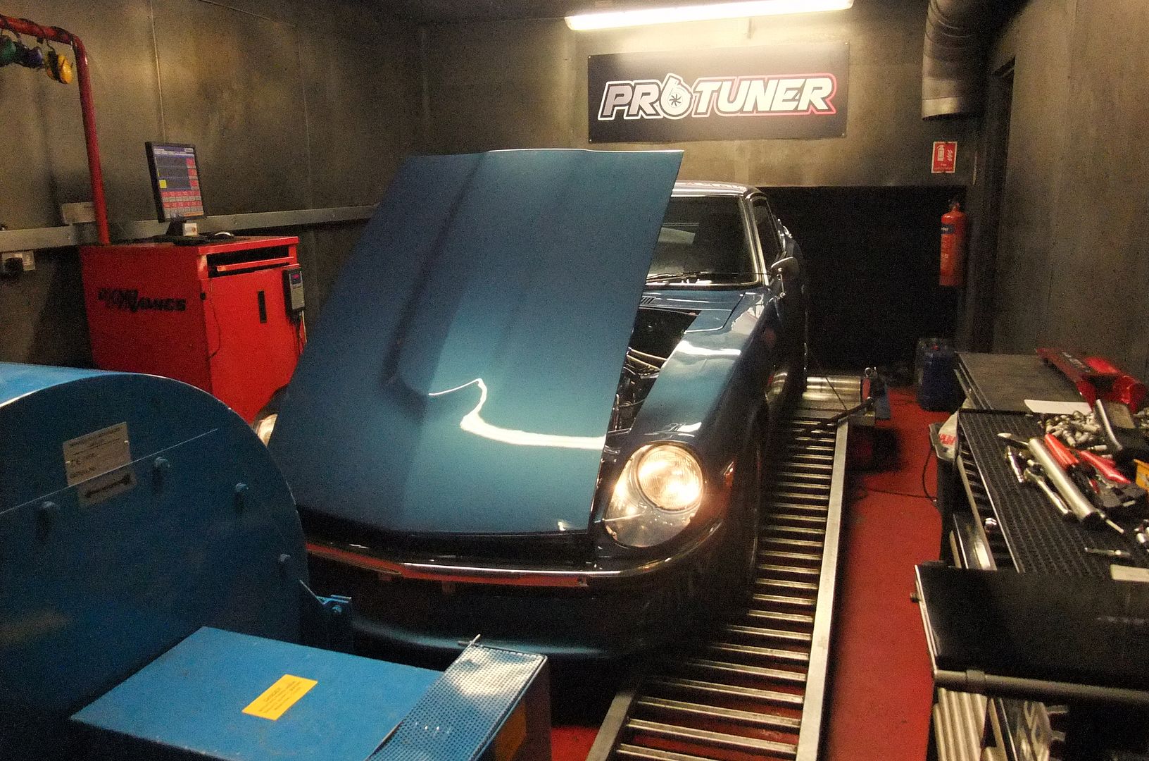

Its now fully mapped and running great, I'm really loving it, loads of fun and crazy quick. Made 480hp and 490lbft
Some heat in there!
One of the earlier ramp runs, not a great video, I have better footage from my GoPro but my software isn't working right at the moment.
