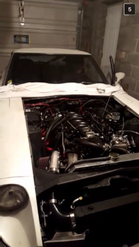

EastTnZ Posted March 1, 2016 Author Share Posted March 1, 2016 Well, I've got it all put back together now. I pulled the file from the computer to tune it so fire up should be this week!!! I can't wait! I still have to add some brackets for the intercooler, padding for a little spacer between some things and clean up my wiring mess but it's coming along since early November. I have rebuilt the transmission and added a turbo. Sounds simple but with life it just takes more time than you plan for. Hoping to have a startup video soon! It has a dump exhaust until I get more shielding gas for the welder but I have all the bends and v-bands already. I will post an in depth list of what I used in the coming week or so and it totaled about $2800 roughly and that includes some tools and the $500 for hptuners. Once I get around to beefing up the rear with an 8.8 I'll add a cam and turn up the boost hopefully! Quote Link to comment Share on other sites More sharing options...
EastTnZ Posted March 4, 2016 Author Share Posted March 4, 2016 trim.81C0D869-338B-4157-A63E-52A095A19E70.MOV SHE'S ALIVE!!! Started up smooth and is running super rich but better than lean. Time to start tuning and then we'll go fast! This video has a 90 degree dump and no muffler. Not quite as loud as I figured it would be but I didn't rev it up any. Quote Link to comment Share on other sites More sharing options...
